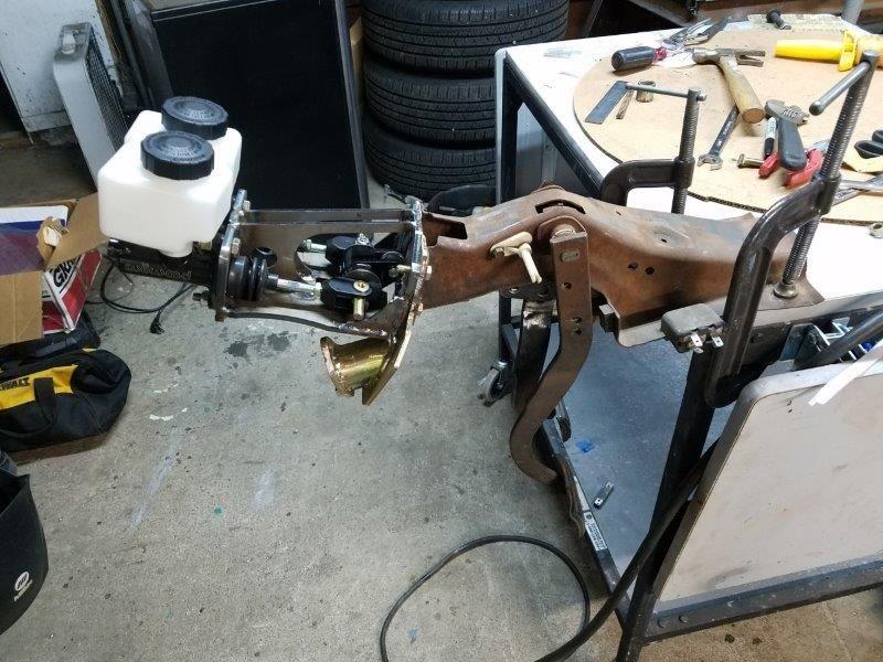

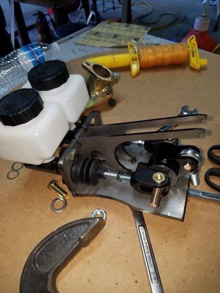

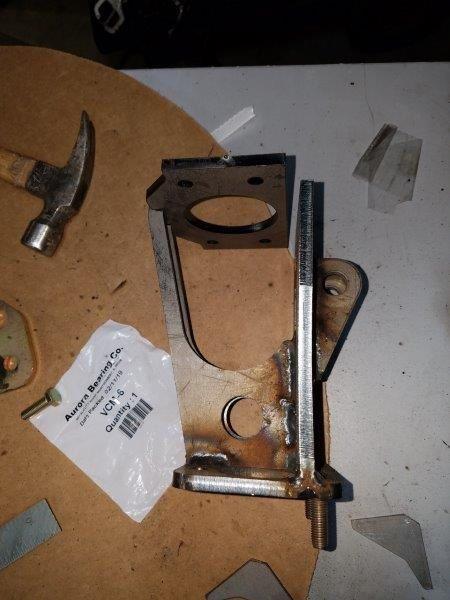

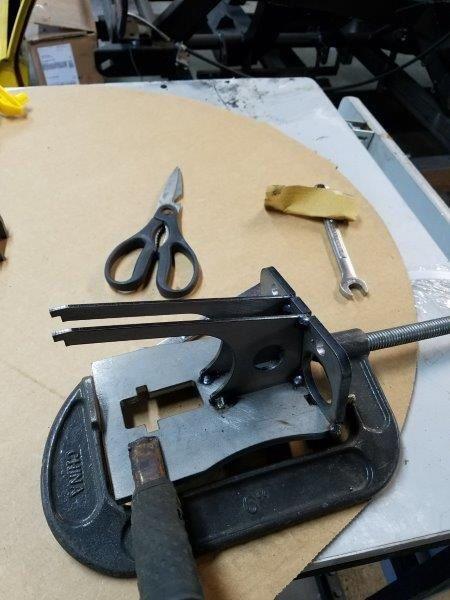

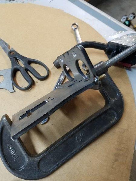

The shop got the laser cutting done pretty quick for me. So I assembled it. I tacked it all together before fully welding to make sure the fitment was good.

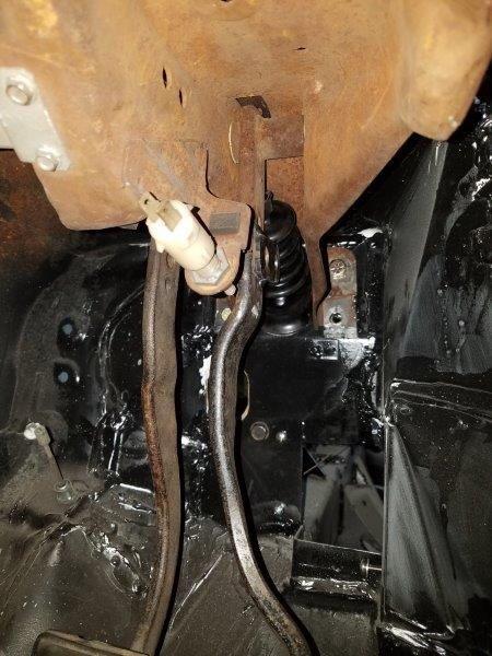

Here it is mocked up to the pedal, so I could build the link to the pedal.
And now it's mocked up on the firewall. The pic from inside the car shows the bellows for the brake rod, hopefully that'll keep the interior nice and fume free! Now that I know it all works, I have some finish welding and grinding to do before paint.

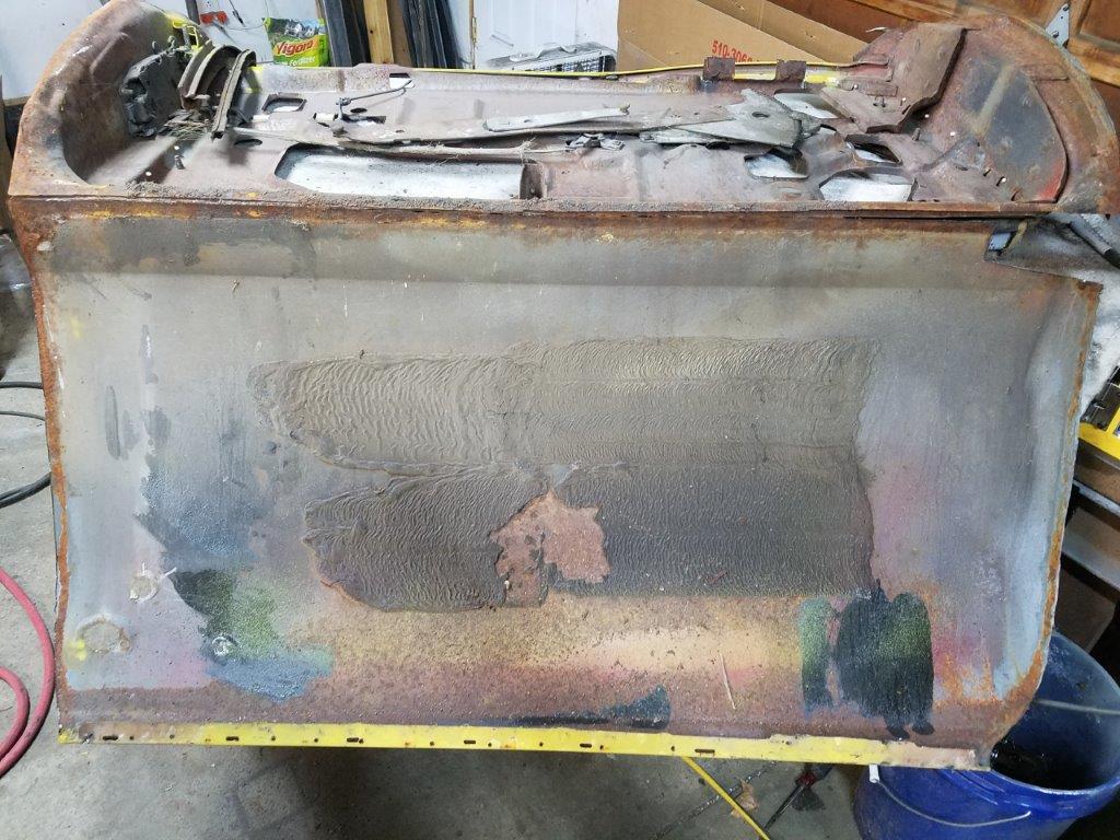

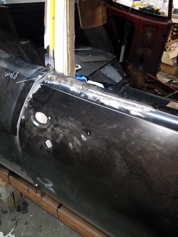

After getting the brake system bias bar completed above, I moved on to the fenders and doors.

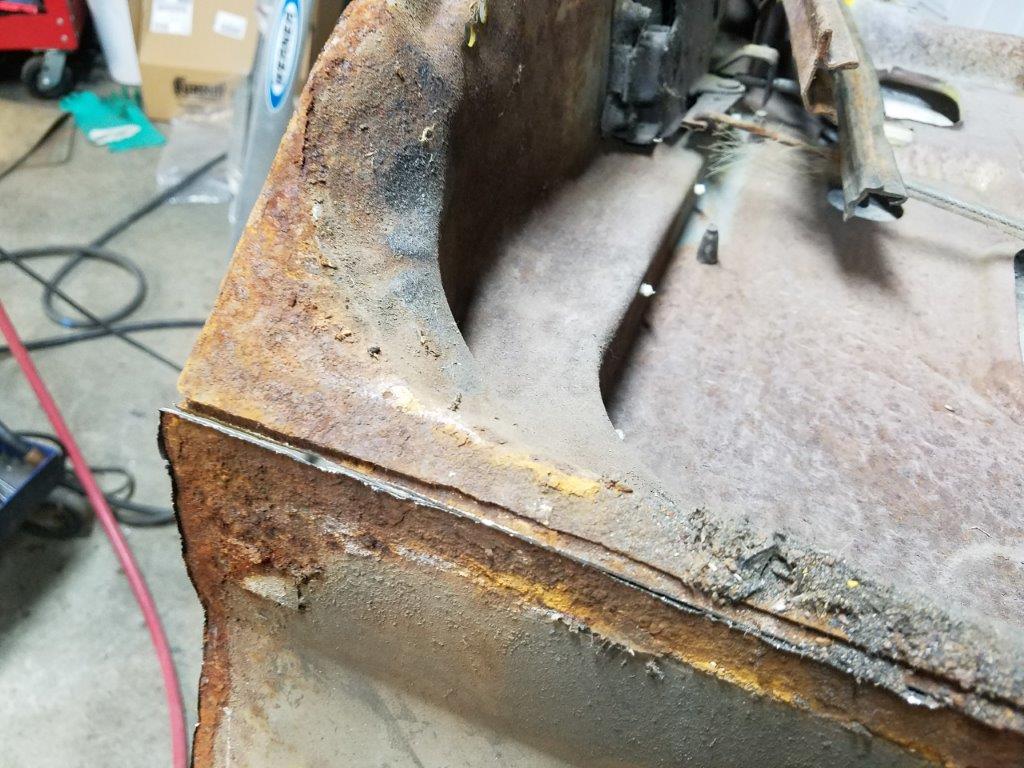

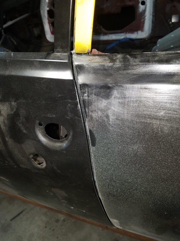

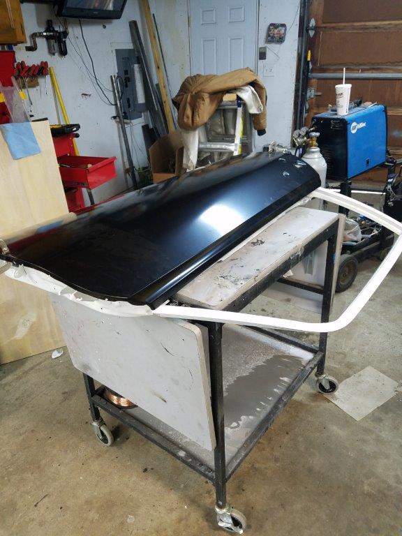

Removing the door skin was easy - take a angle grinder to the folded over edge, make long sweeping passes until I broke through the door skin. After that, it folded right off! Once the skin was off, I had the shell sandblasted and epoxy primered.
Here's the skin going on the shell. the AMD Skin fit decently, but I did have some issues where the door handle attaches.
Does anyone know what kind of sealer to use in the corner of the door opening?

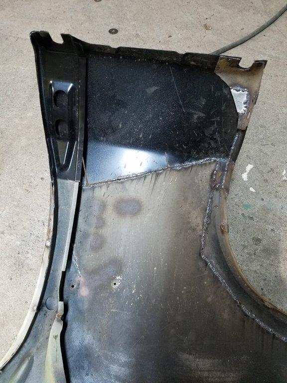

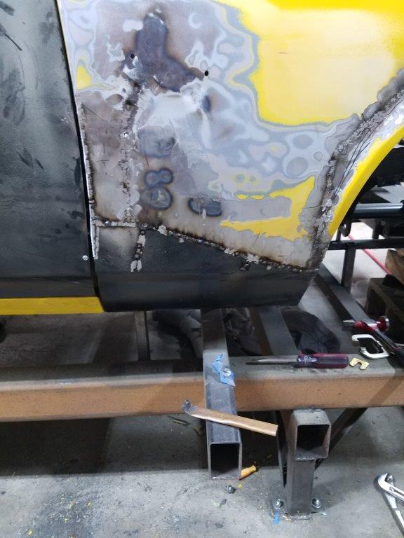

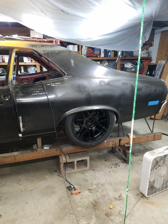

Passenger fender patch. This turned into a bit of a debacle. I had to chase high spots, low spots, the door gap started changing... I had to step away for a few days to reset on it. In the end I got it decent enough where I don't need more than 1/8" of filler anywhere, and the gap is good.
I had to slice along this body line and move it up to make the contour work right.
The driver door fit decently, except that the arc between the upper body line and lower line is too long relative to the quarter panel. I'll have to add a little metal to the top of the quarter panel line and the bottom line using some round rod.

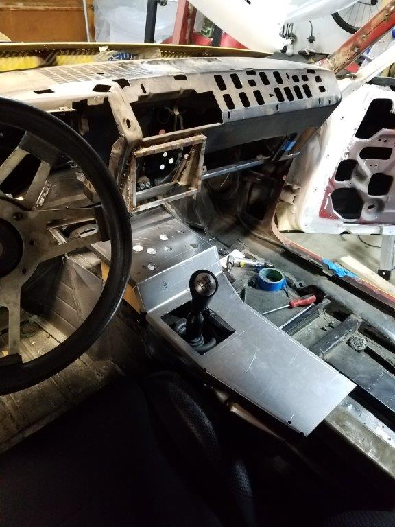

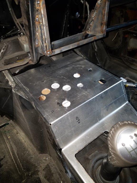

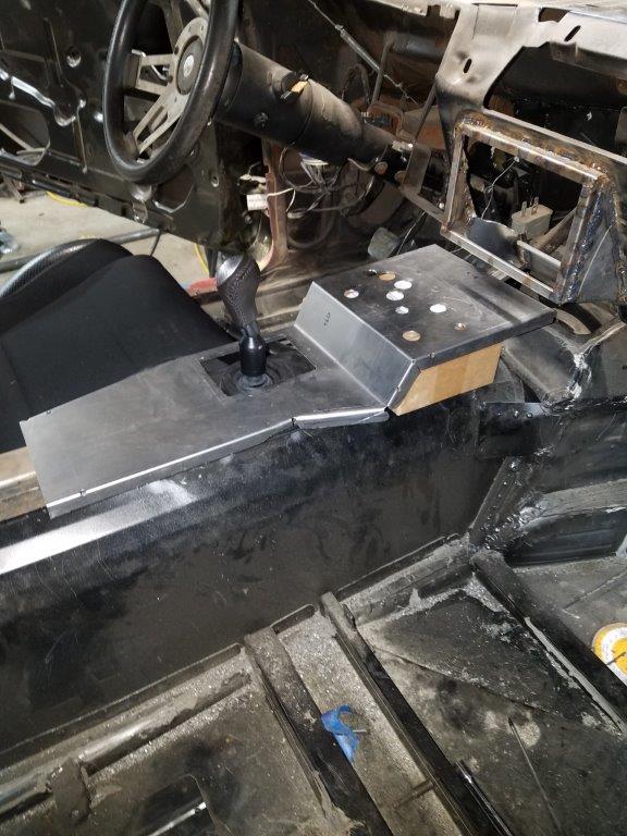

Shifting gears, I decided I needed to complete all heavy metal work in the interior. That really just means the radio bezel, center console mounts, and making sure the dash fits.
I decided to make the console from sheet metal. I may live to regret it... but I think it came out pretty well. I'll use some filler to smooth it, then put a layer of foam and vinyl over it.

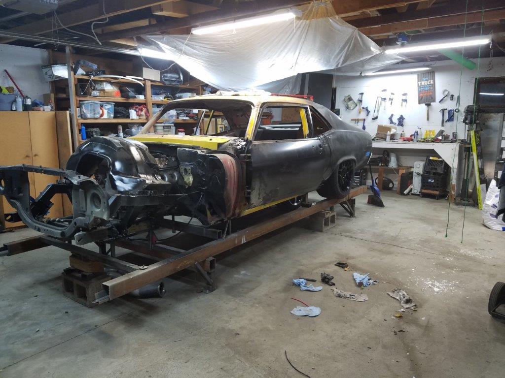

At this point, I decided to cut the car off the frame jig, for the first time in 8 years, 10 months. I decided to get the tires mounted up so I could roll it around when I get a little further.

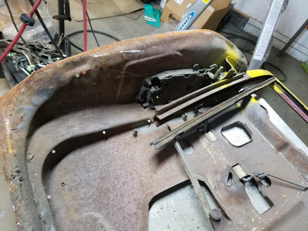

My OEM trunk was too rusty to save, so I got a new one. They guy who had it before really piled on the featherfill sprayable body filler, so I used a heat gun and a razor to knock it down. Then, an 80 DA to profile the surface.
