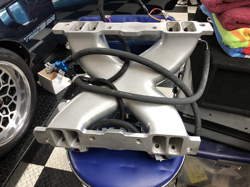

Anyone here have experience with Aeroquip Push Loc with EFI? My hydraulics shop tole me it was fine. It was rated for fuel and 250PSI.
The problem is that after 500 miles one of the hoses came loose and sprayed gas everywhere while I was driving. I found the following when I went to fix it. The two 6AN fuel rail lines run to a 8AN out Y fitting before meeting up with the filter.
So you can see where the hose split and then after I cut the hose back about 6 inches you can see what I found inside. Disconcerting to say the least?
Does anyone on here have similar experiences with their stuff? At roughly $6 a foot, I expect better.

I don’t see any kind of liner in that hose. I use Holley Vaporguard hose. Looks similar but has a liner. Fittings use a crimp ring.
SAE 100R6 is hydraulic hose. Most likely not intended for fuel.

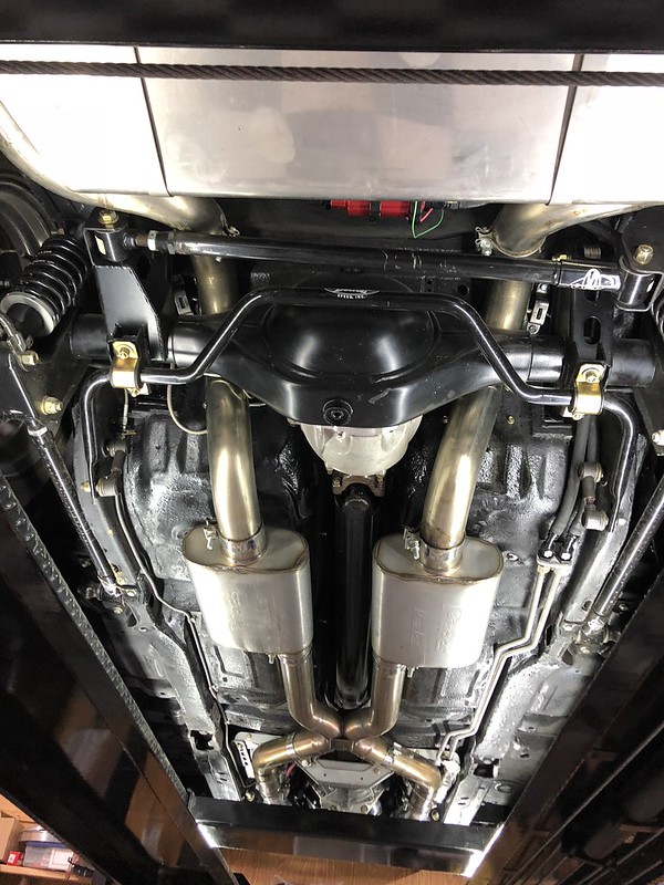

Originally Posted by cjsgarage View Post
If you run hardline except for the flex for tank drop-down and from firewall to block, you'll save on serviceable pieces.
from my iPhone using Tapatalk
Pretty much what I do.
1 from rear bulkhead return fitting in tank
1 from in pump in tank to fuel filter
1 from fuel filter to rear bulkhead pressure line
1 from front pressure bulkead fitting to filter
1 from filter to Y adapter to split to fuel rails
2 from Y adapter to fuel rails
2 return lines from fuel rails to regulator
1 from regulator return to return bulkhead
Untitled by by [url=https://www.flickr.com/photos/159188510@N03/],
Untitled by [url=https://www.flickr.com/photos/159188510@N03/]
