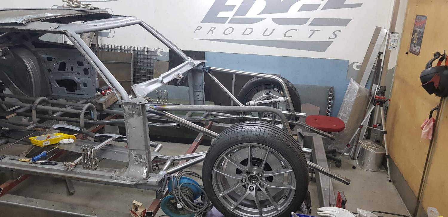

It will be low, has hidden tube frame inside its body, inside roof frame,
inside frame rails, double rails at rockers and in the middle, around transmission and drive shaft.
Removable main hope, cross- and door bars.
Many body panels will be hand made from aluminium, by me. Ofcourse
Fluss front and back glass, one piece door glass.
As you can see in the photos, body has cutted / drilled open,
brassed and sandblasted with home made rotesserie, then I put my frame table together
and installed body on it so that top of the table as ground,
ride hight set to 4", as you can see, front rails dont work with that.
They may be relocating or changing

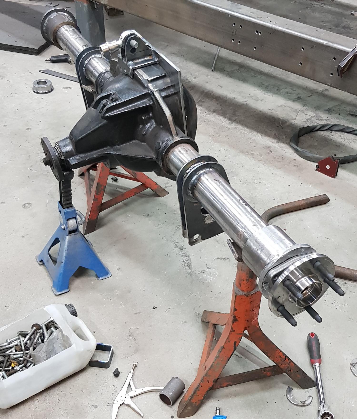

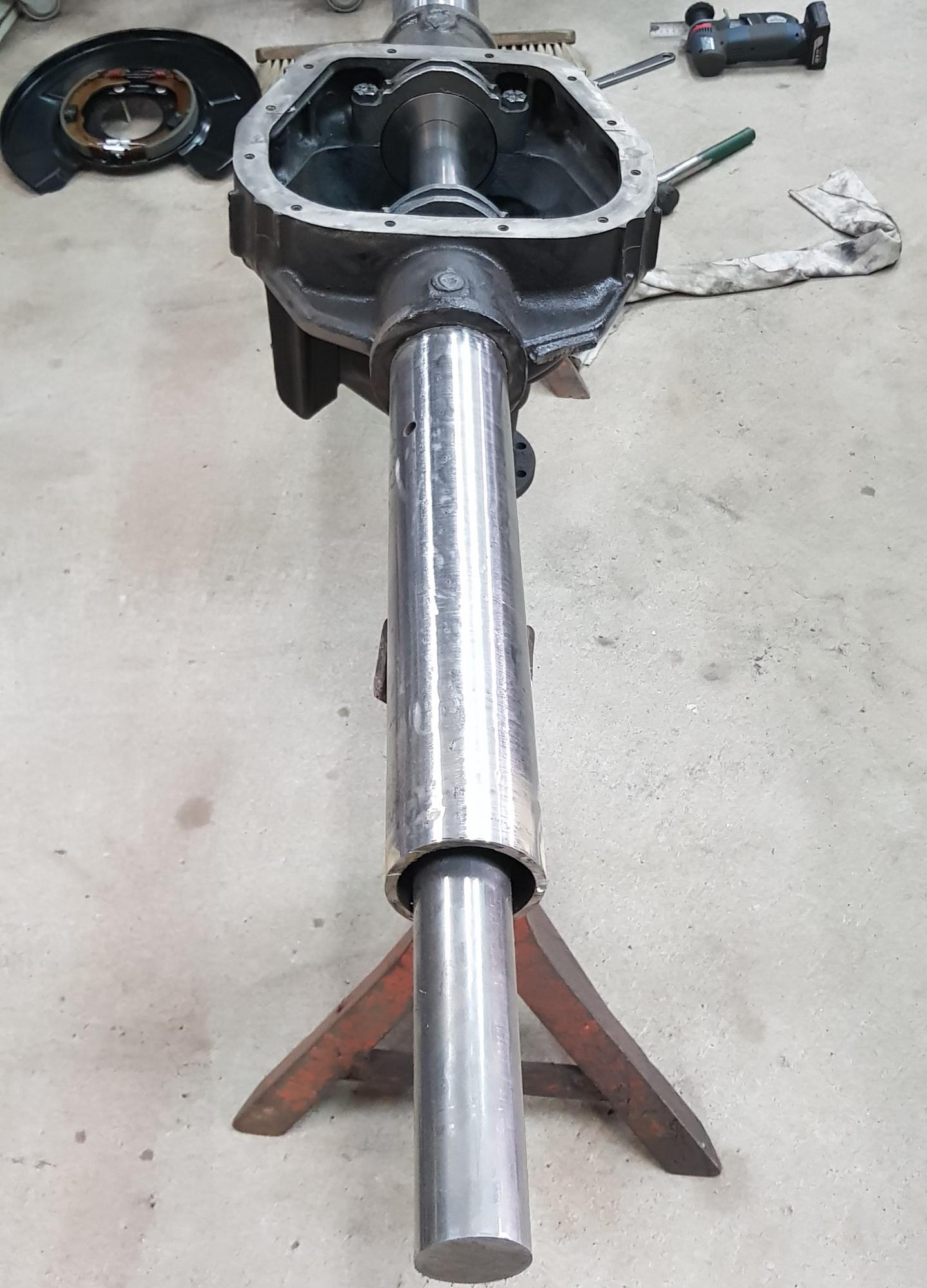

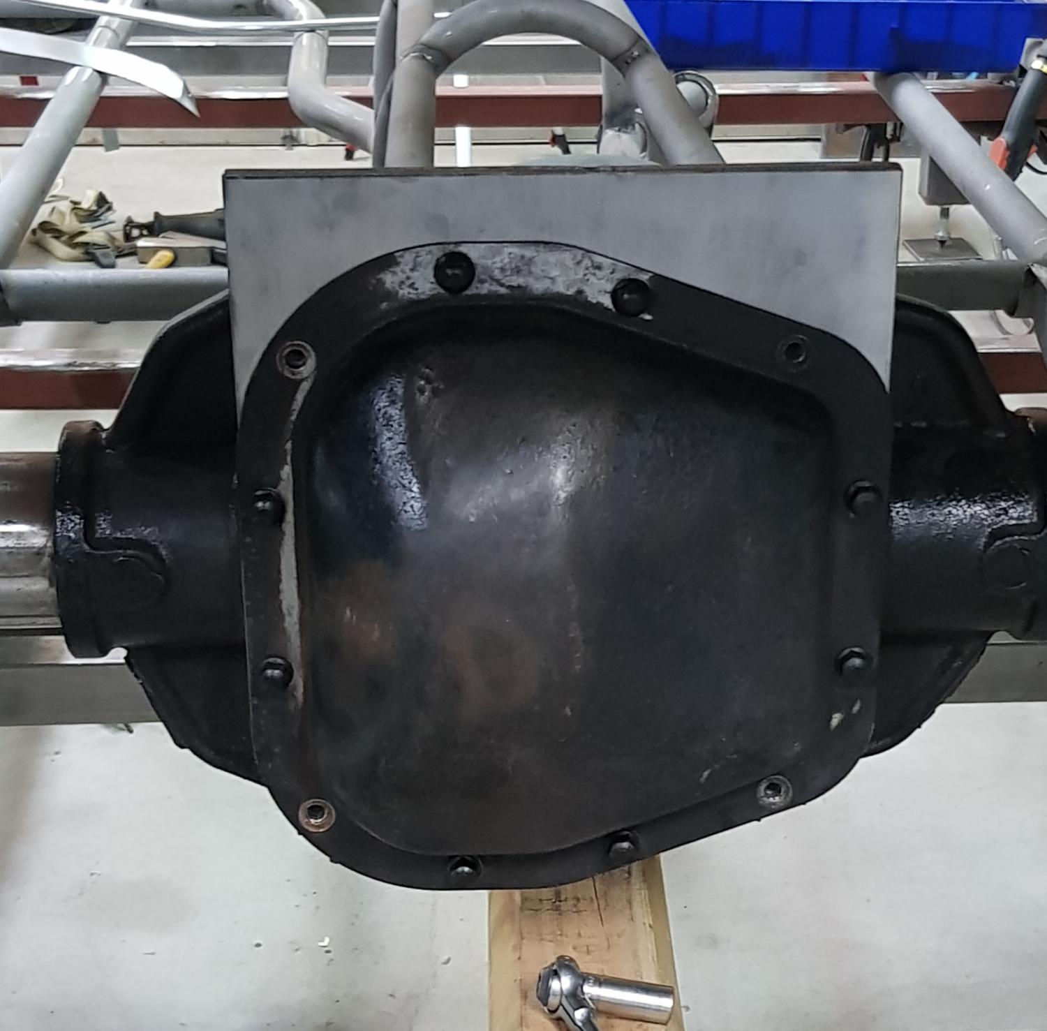

Rearend:
Ford 9.75 with true trac, 3.08:1 gears,
own design floater axle system, modern wheel bearing pack,

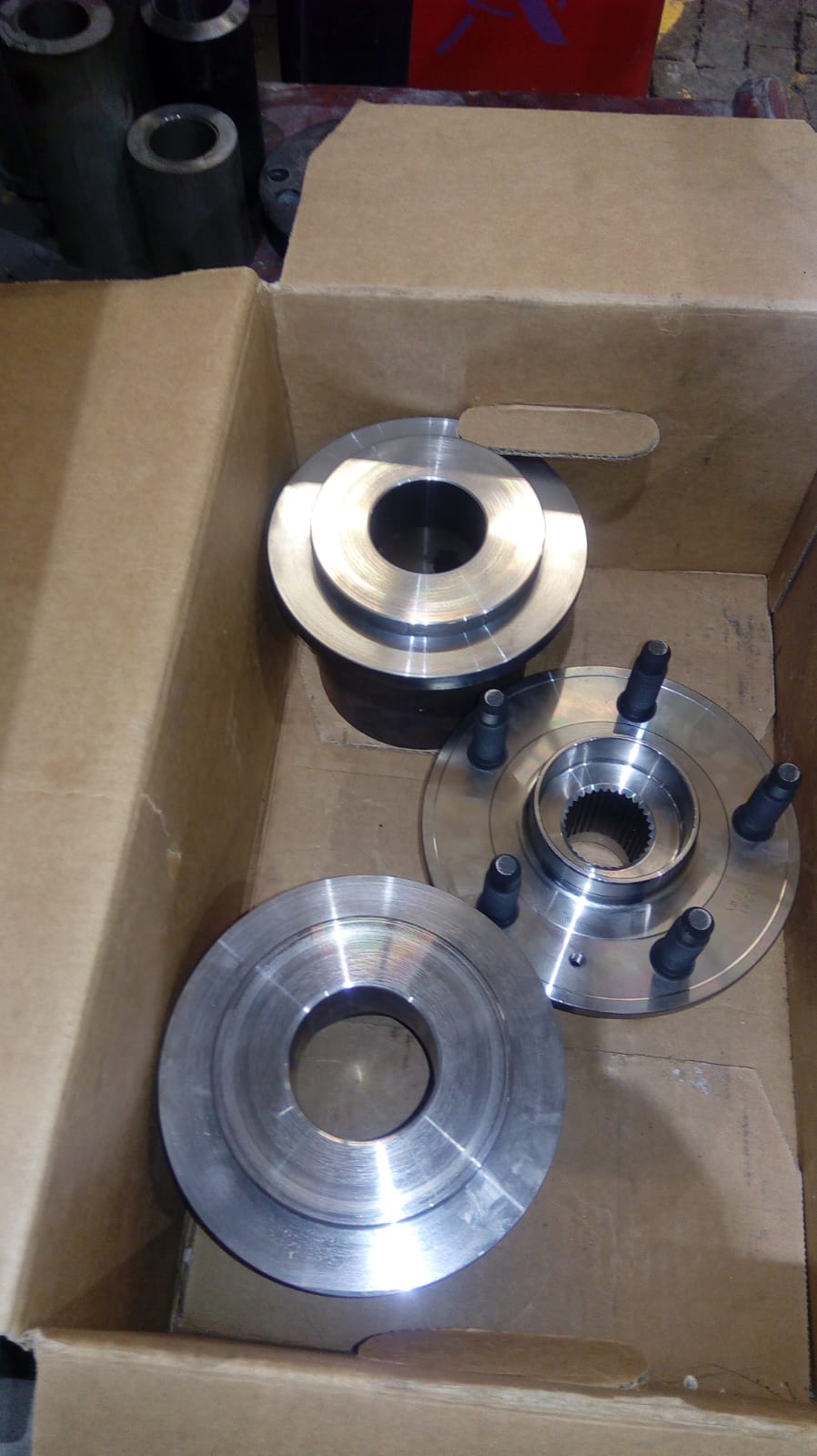

Self machined (from MoC410m) axles. 3-link, d a coil-overs and air lift cups.

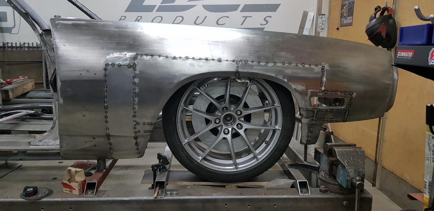

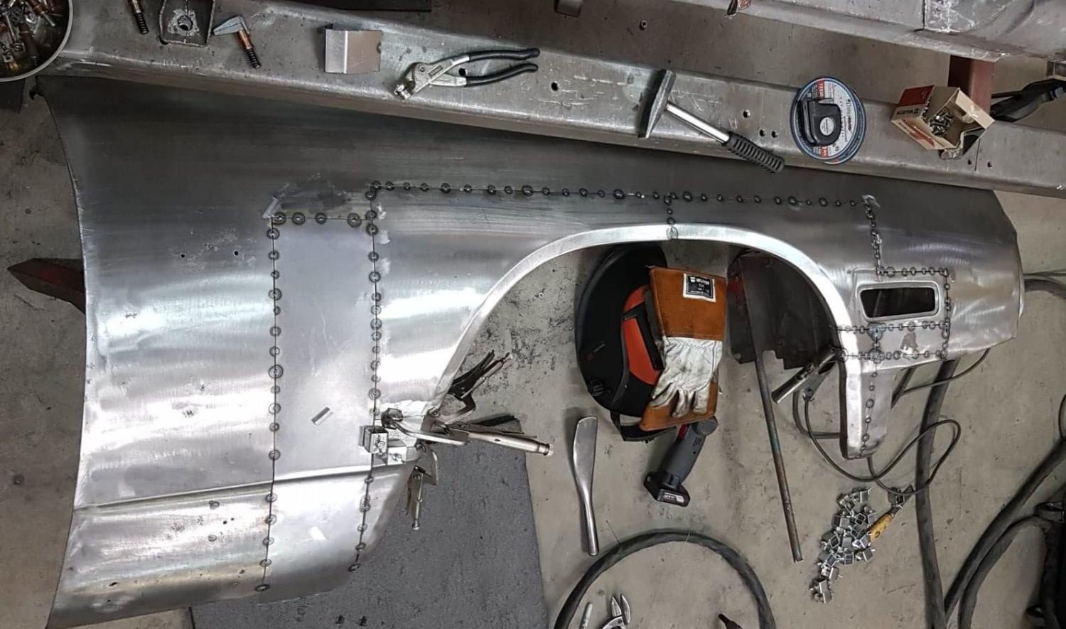

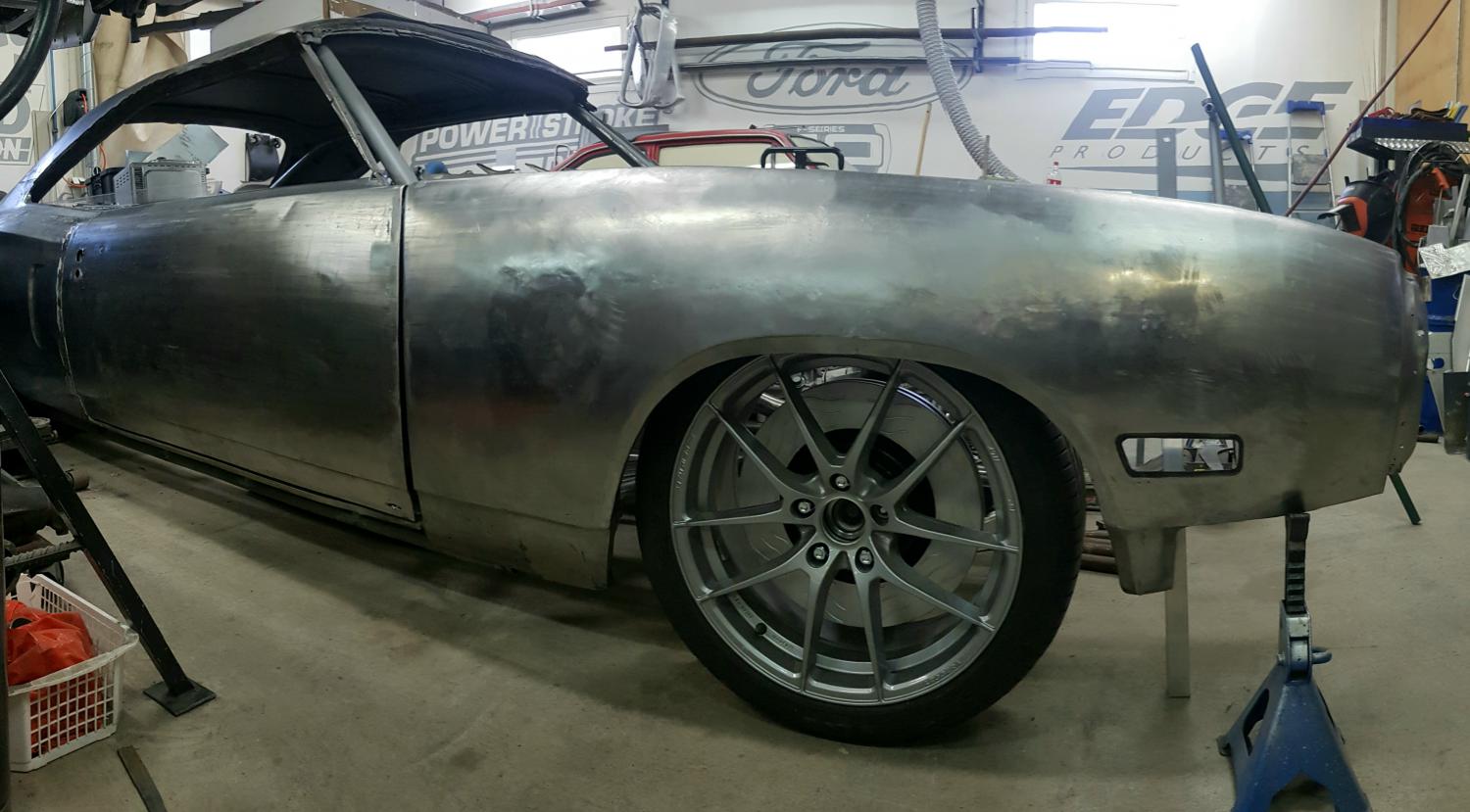

Front fender time.

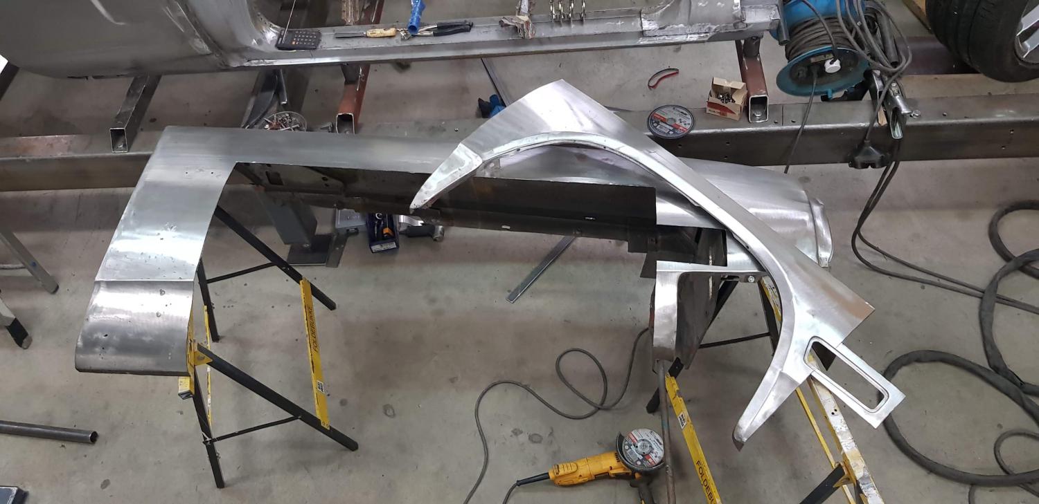

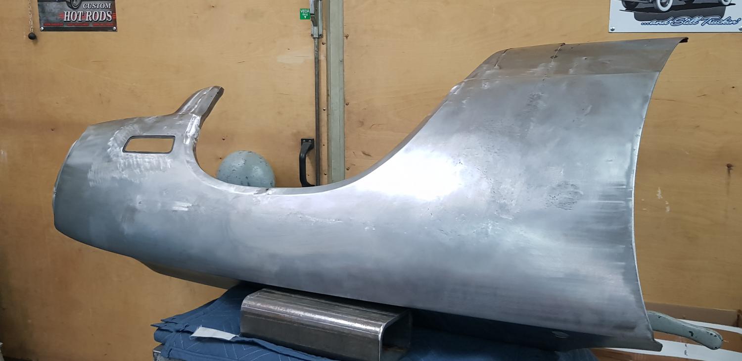

Since I moved front axle 3" forward, I need to modified my steel fenders to fit.
And with 19" wheels, stock wheel arches (for 14") doesent fit quite right.
Now is good time to make the chances, plan how to cut is critical.
Want to keep side markers, one thing that makes musclr car different than our "normal" euro- or japanise cars.
New wheels and modded frame forged me to rise arches 2" to clear wheel when turning. Also arches looked tobe little too long for my taste so I nipped 1" way from the middle. That turned me to add 4" add the back cut line.

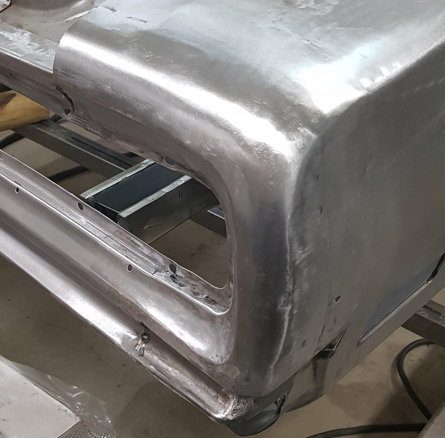

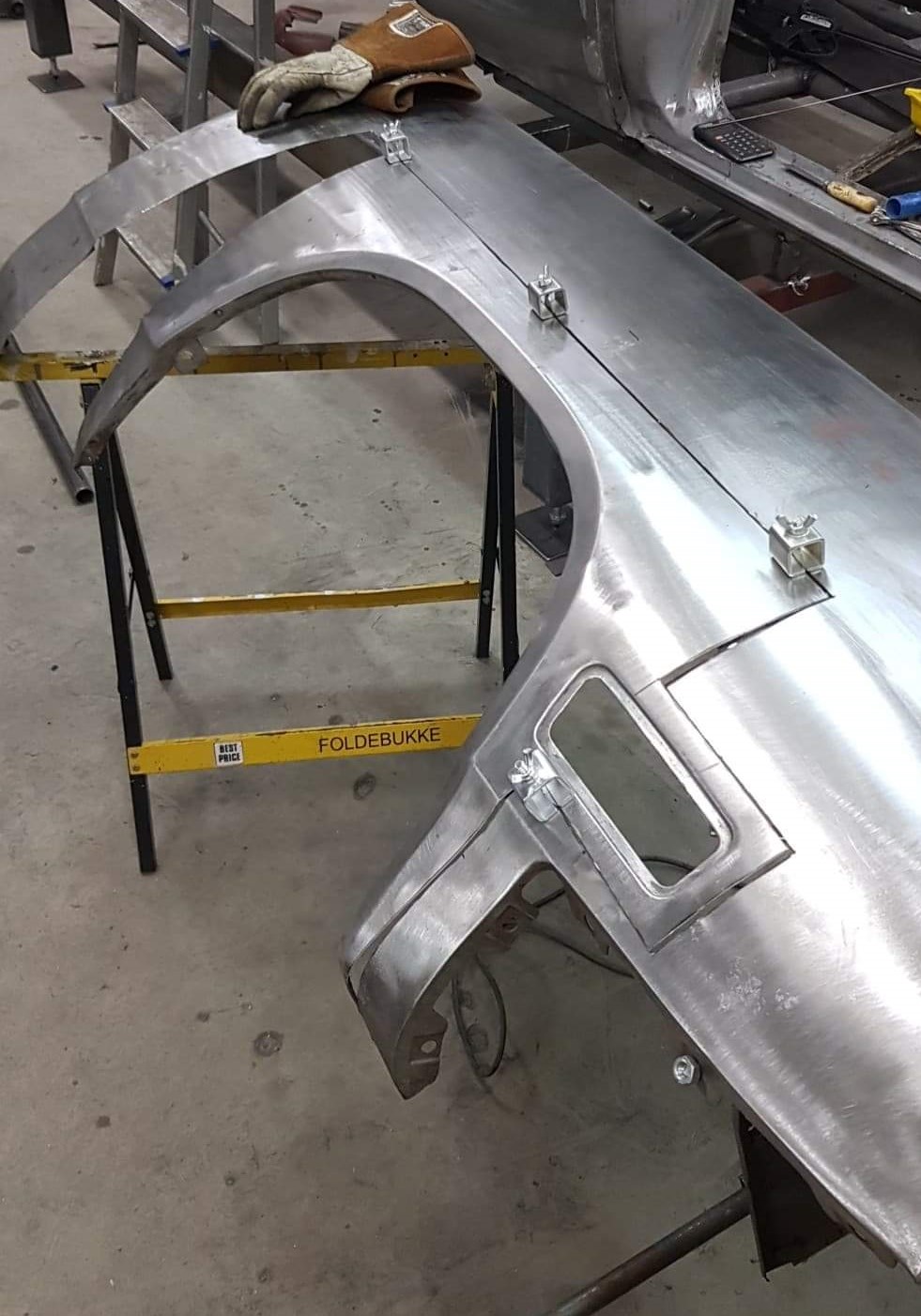

Good fitment, tig welding, relentless hammer and dolly work and you dont see the seams anymore. I could slap and shrink them to smooth but why? they will get coated/ bondo'ed (even thin skin)/painted anyway.
Driver side fender have had some kind of fender bender so I chanced front part, so many screw pulley hammer hoses that no point to weld them.
In one pic you can see how I fix are when it has got "fed up" cant shrink anymore. Cut round circle out and weld new piece. Try to avoid sharp corners. Doesent shrank so much...

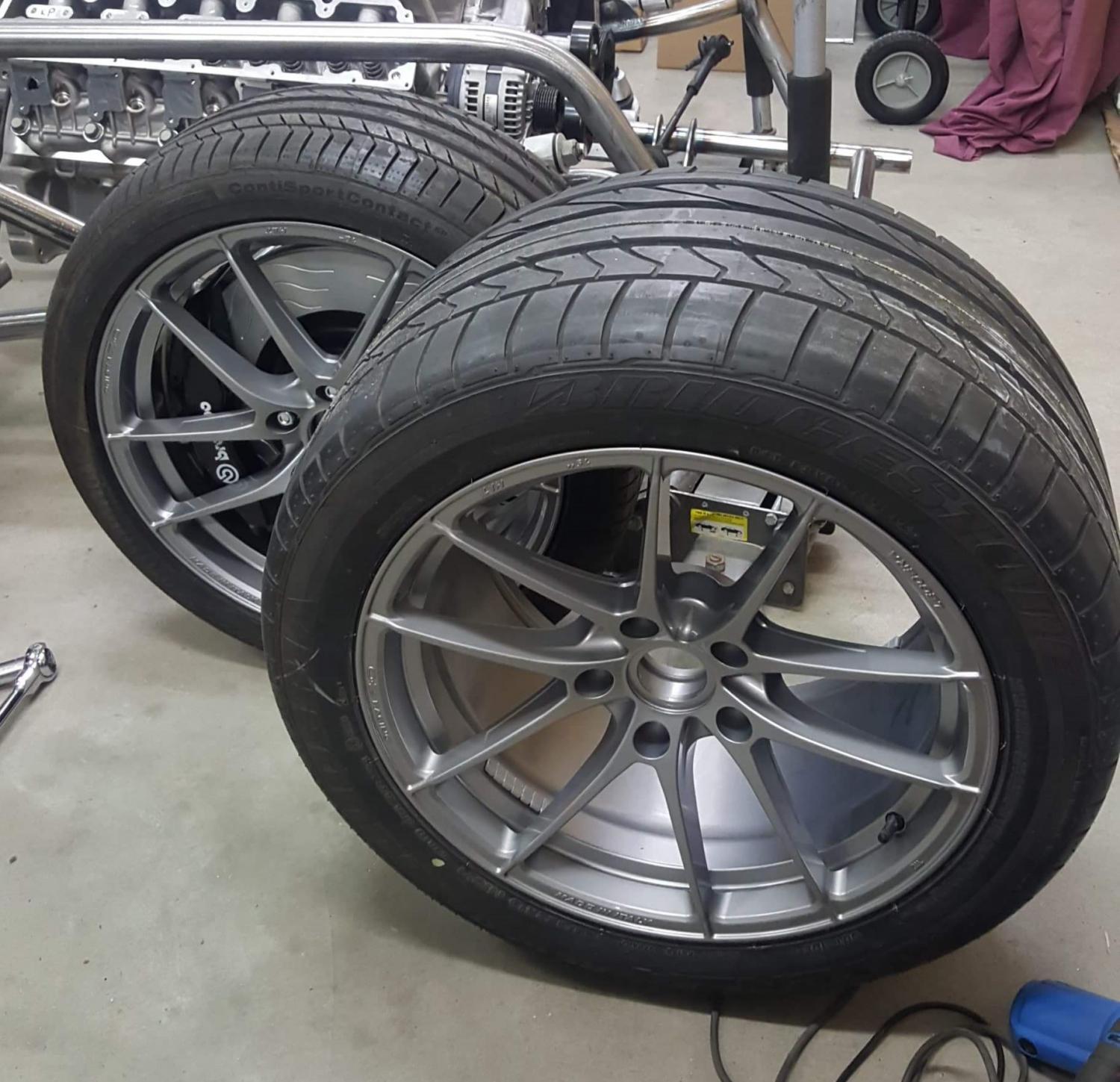

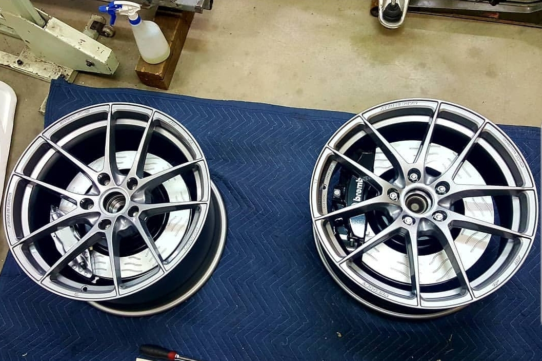

Is it just me or those 19" wheels and 15" rotors dont look that (mean too) big anymore...
Now I can start planning side skirts.. Dont want too much but want something.. One idea is to make Viper like side exhaust inside rockers... Mufflers, yes you guested. Have to be made...
Again, I will leave something coming to last pic.
