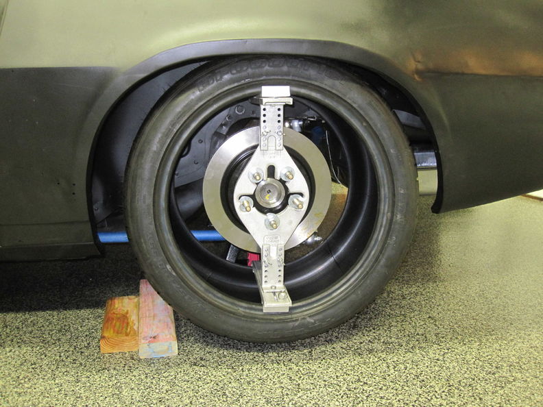

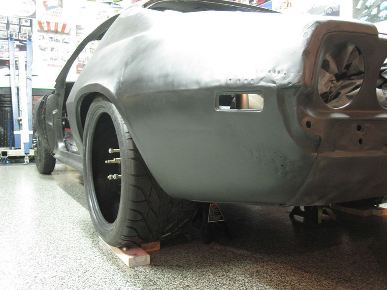

Evening all,

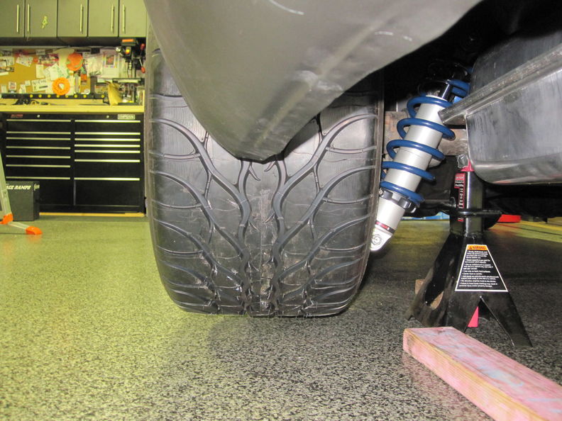

Picking the right tires for your car is important, it can make or break the final look . As much as I like the big tire look out back it just doesn't fit with the plan for this car. The goal is to have something that looks very classy and timeless. So the ideal size for this project would be somewhere around 12" wide.
Remember timeless is the goal for this car.
What was funny is I asked everyday people what they thought of the tire combo on this car while it was sitting in my garage and everyone
said the same thing.
Looks Perfect !! Not to big, not to small just like the perfect bowl of porridge - Just Right
Some of the cool tools that I have laying around from the Syborg TT project is the Wheel Mate. It sure makes test fitting tires easy !!

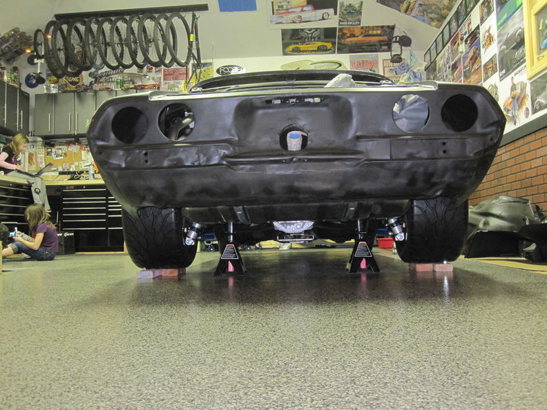

You can see that there is plenty of clearance using the stock rear spring perches.
Quick look from the rear and you can there is plenty of tire out back.

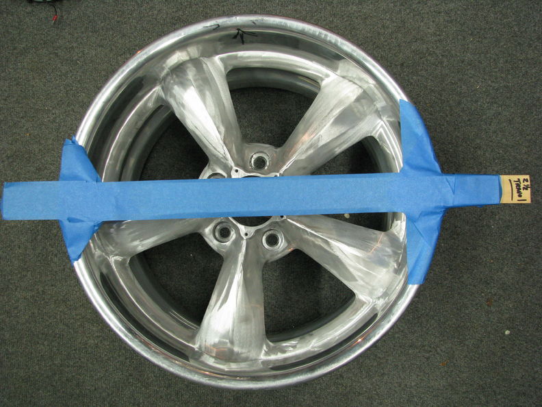

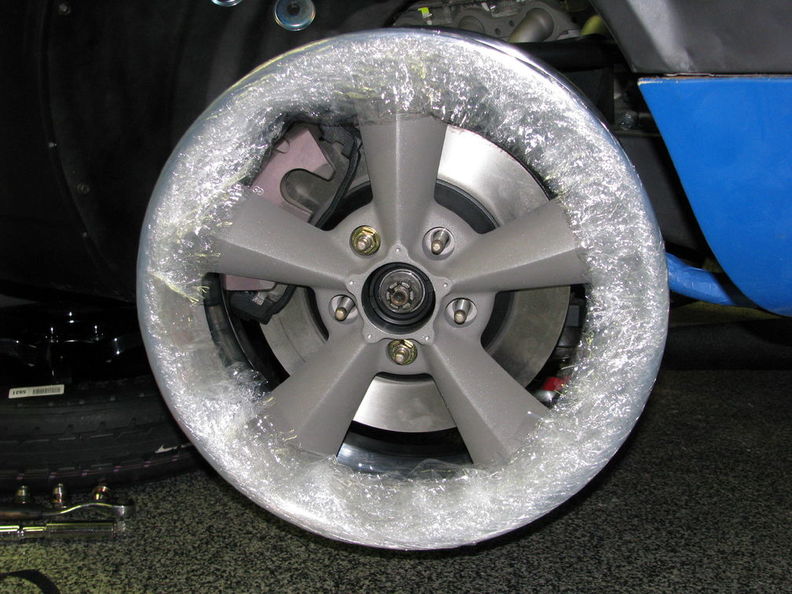

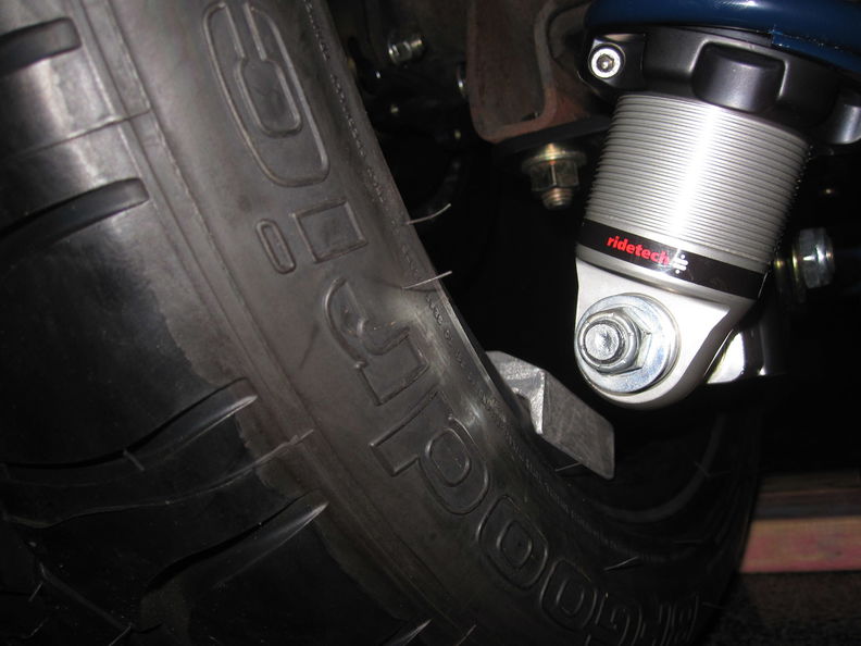

Evening all,

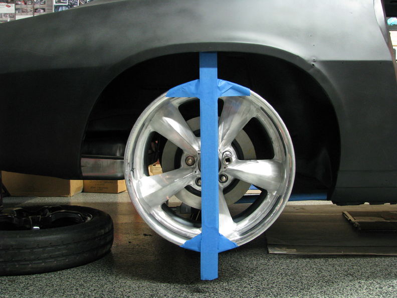

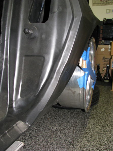

Scott from Billet Specialties was kind enough to come over and confirm the backspacing. He also dropped off the test rims to make
sure everything fit as we hoped. Using the stick you can confirm tire clearance when the suspension run's through it's travel.
If your spin the rim you can check for other clearance issue's.
The 2 1/2" on the stick shows upward travel for the rear suspension. You need to make sure that when the tire goes up it doesn't
connect with the inner wheel tubs.

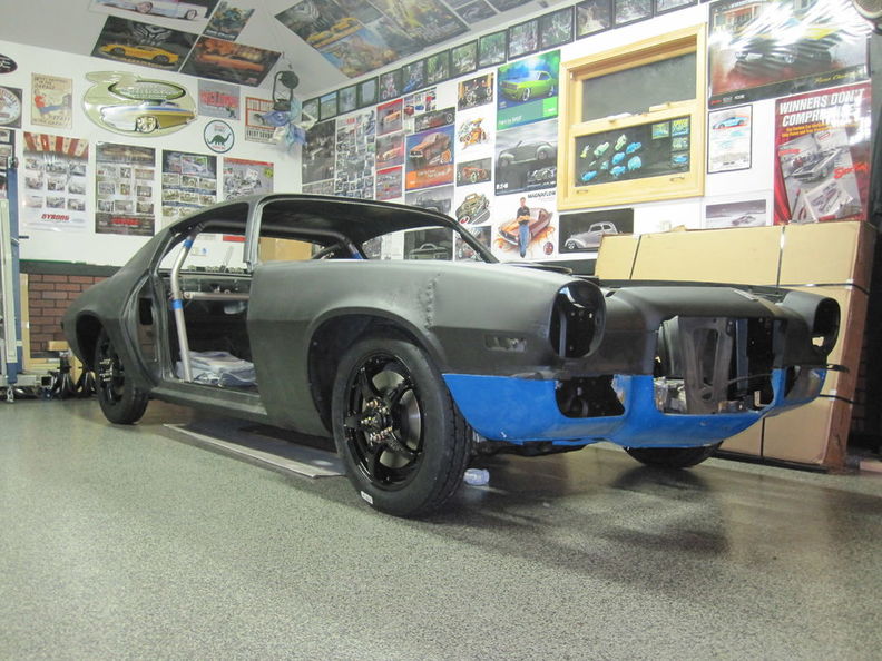

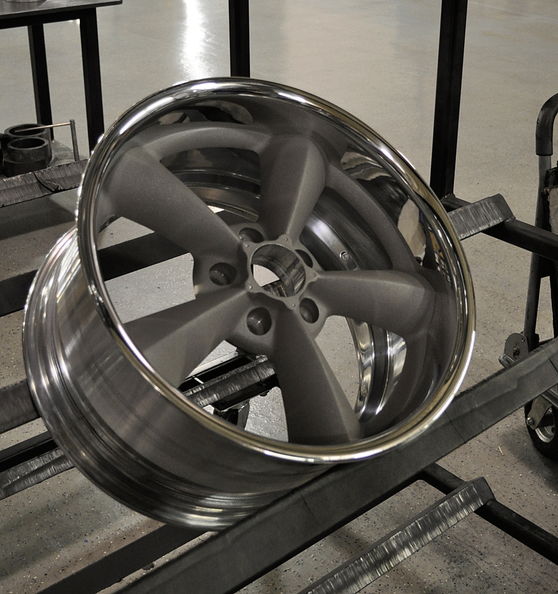

Picture of the rim just after it was finished at Billet Specialties. I can't wait to pick them up and fit them on the car.
The finished wheel mounted on the car.
Pictures hosted by www.garagescene.net

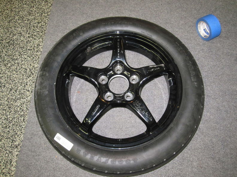

Morning all,
Now that the wheels have been chosen it's time to find a set of mock up wheels that will clear the Kore3 brakes. Chad Fletcher told
me about the GTO spares and I was lucky enough to find a few of them. One for the car as a spare and apparently four of them for
Kenny. He told me that I would not be getting them back as he needed them more then I do.
