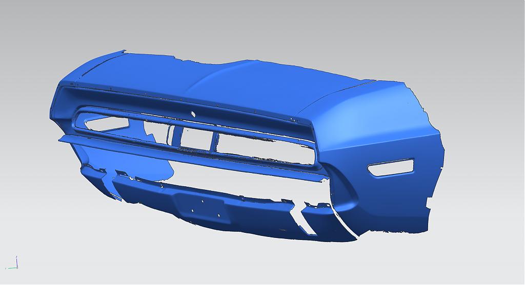

1970 Dodge Challenger - "Etikit" Built by Tim Bruning
