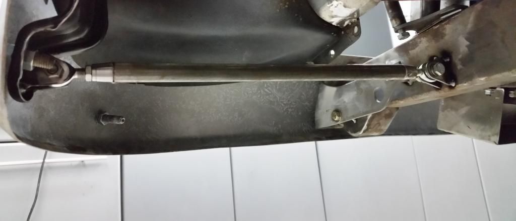

I made the side mounting brackets with 3/4" round tubing with right & left hand rod ends. Makes it real easy to set perfect gaps. Ignore the extra stud on the bumper. That will not be used and taken off before chroming.

Nice work Brent! I really like the adjustment you built in. Very clever.

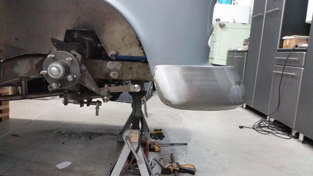

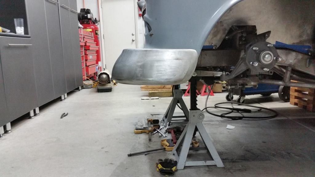

Here are some pics of the rear bumper fitment.
[IMG][/IMG]
[IMG][/IMG]
[IMG][/IMG]
Brent
