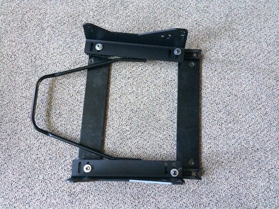

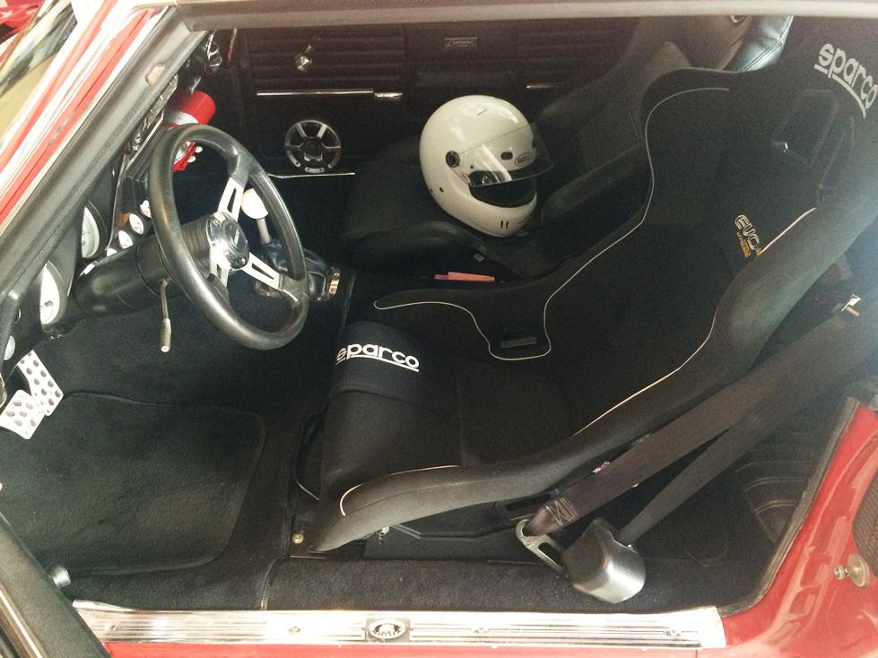

I finally completed step 1 of some long coming safety upgrades planned for the car!
For several months I have been looking at fixed back seats and sitting in as many models as I can. After a lot of deliberation I decided not to go with an aluminum seat and instead do a fiberglass FIA rated seat. The comfort difference was simply to great for me to ignore.
I'm a taller guy at 6'3" with a taller torso so I struggled to find a seat that really fits me. A lot of the seats marketed for taller people move the shoulder harness slots higher in the seat but didn't make the seat back itself much taller and often the shoulder wings / bolsters would come out at my armpit and not touch my shoulder at all.
It was amazing to me to look at the difference in height measurements between a reclining seat and a fixed back seat as the same manufactures really shrink the fixed back seat down comparatively.
For me personally I found the Sparco Evo II to be the best fit. The shoulder wing mounts were higher than any other brand seat I was able to either sit in or find accurate measurements for online. Their Ergo L model is even higher but I didn't like the look of that seat and it was a little too wide. The problem is that due to the port strike Sparco has been out of stock on this seat for months! I finally found a 1 year old authentic model for sale locally and bought it and installed it.
The seat:
The mounting setup I used. I may make a 2nd mount setup without the sliders for hardcore track days to increase safety and headroom. However, I decided that for now I wanted to keep a slider so that my wife can drive the car as well as preserve the option to get fast drivers to drive the car and provide feedback.
And the seat installed in the car.
This past weekend's Hotchkis autocross event at Fontana was my first chance to try the seat out. It really does help you drive better to not be using the steering wheel as a handle and getting pushed around in the car.
Now I can finally pursue getting rollover protection built as we will know exactly where my head is in the car. Then it will be time for 5 point belts.
