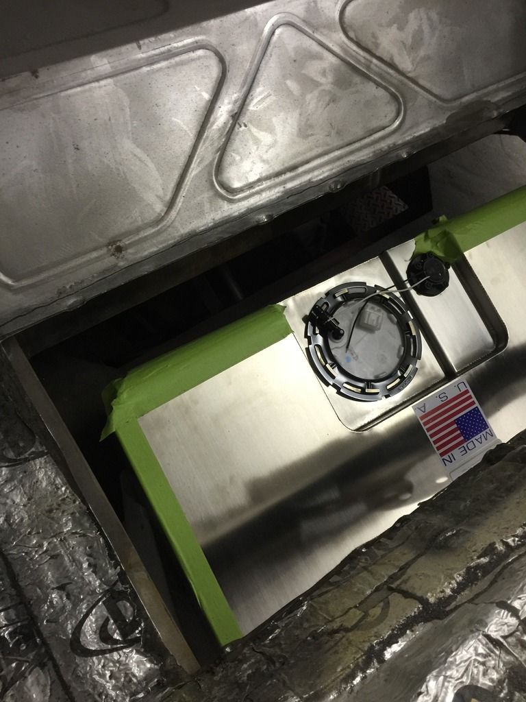

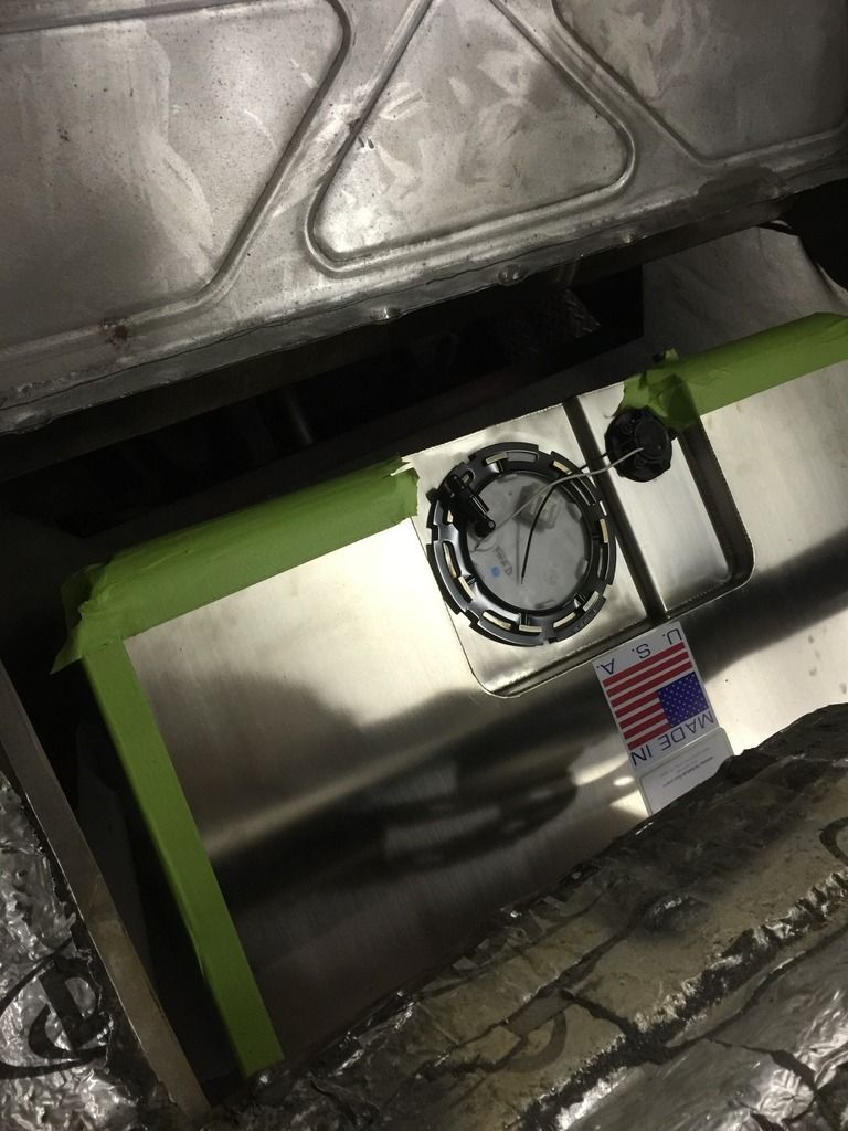

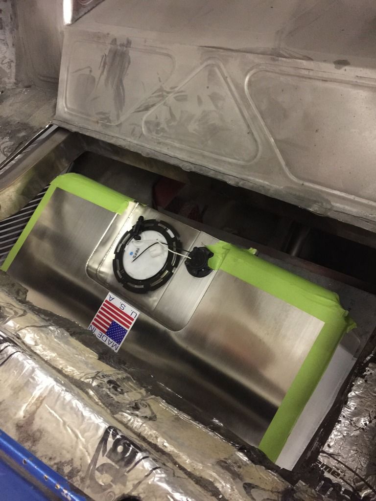

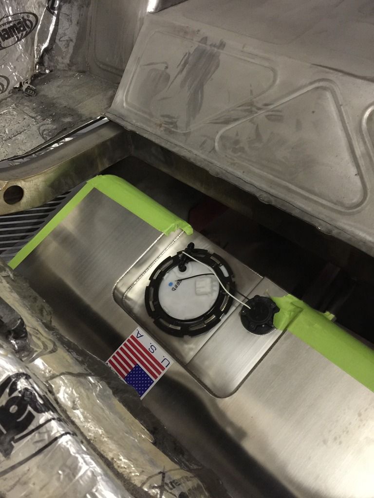

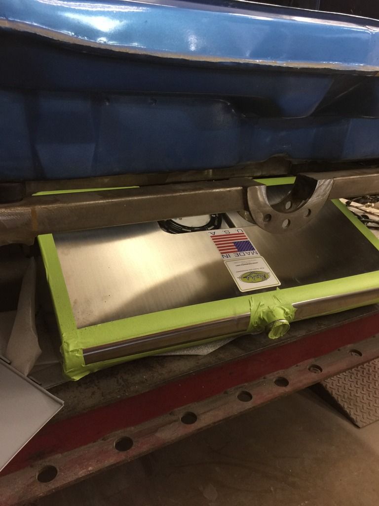

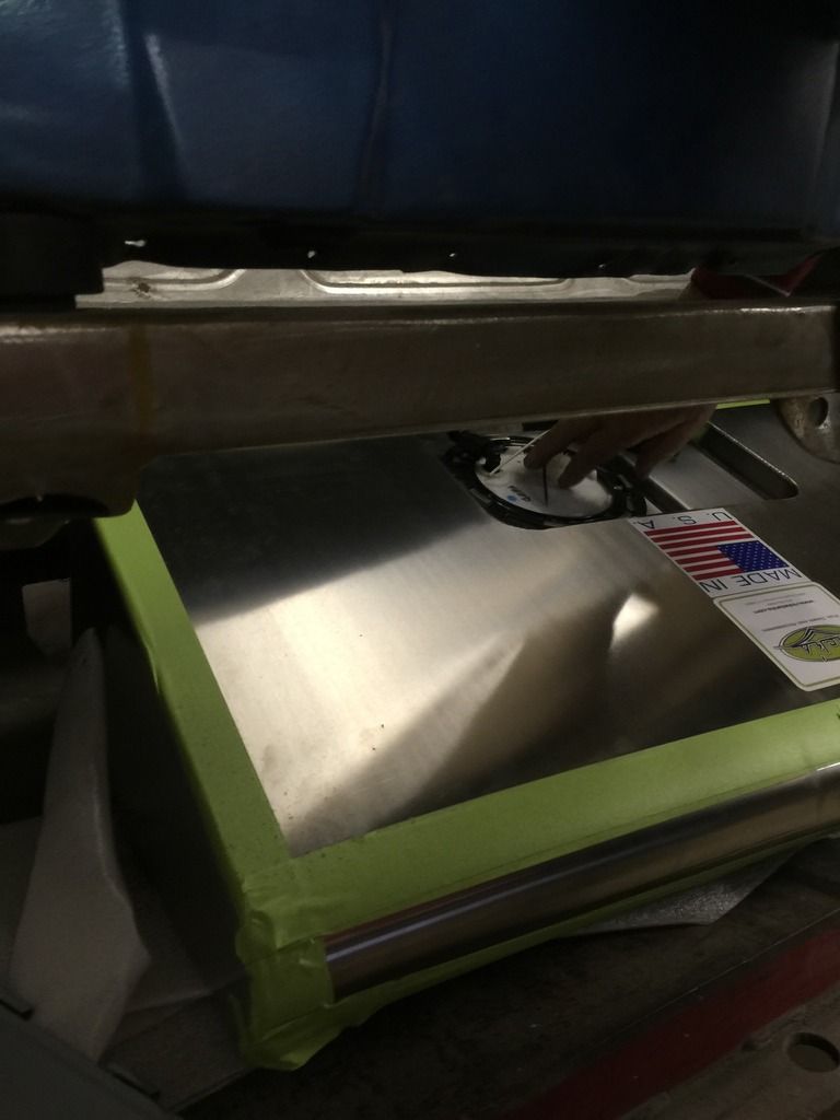

Awe man, you're not gonna let me make it are you? LOL!! I've been putting off powder coating the frame and all until I made my mind up with the motor and gas tank. As far as the car, I may have to recess the firewall because of the rear inlet of the supercharger. All this has been up in the air for months. I've now finally made up my mind. Although, I do have a few more bills to pay off before I get back on it full time. I couldn't powder coat the frame because I had to weld the brackets of the Rick Vaporworx tank to the rear frame rails. But, couldn't do that because there was an issue with the tank after it was built. The tank itself was flawless, but where they put the fuel return line bung, it prevented me from fitting the tank in its place in the back....the square part. The bung keep hitting the frame rail. So, I had to send it back to Hector at Ricks and have them remove it and place it somewhere else. Here are a few pics.
