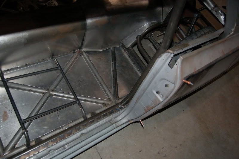

Wow I would have never guessed that, I guess that it is true that you learn something new every day. Is that a common way to do a floor on a frame like that?

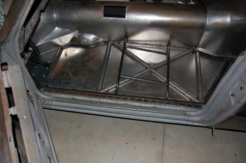

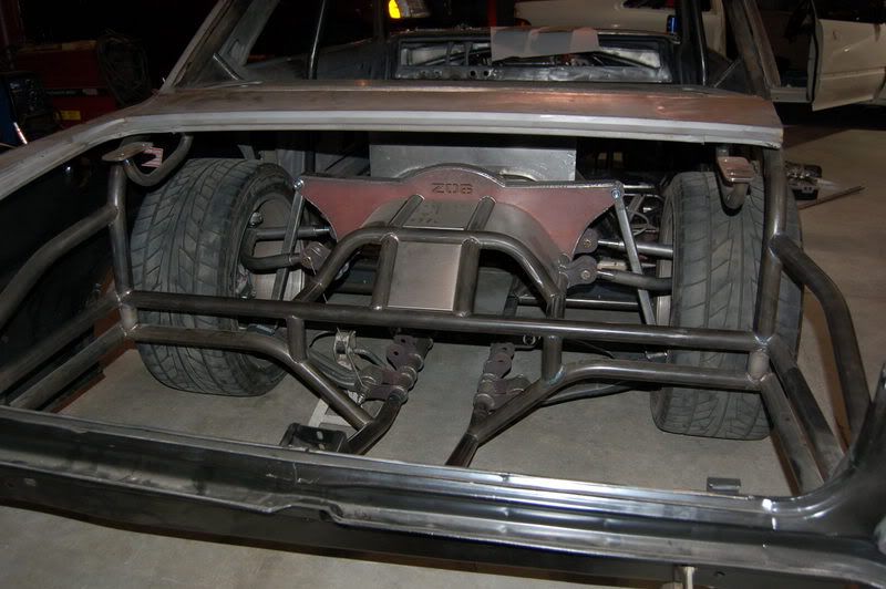

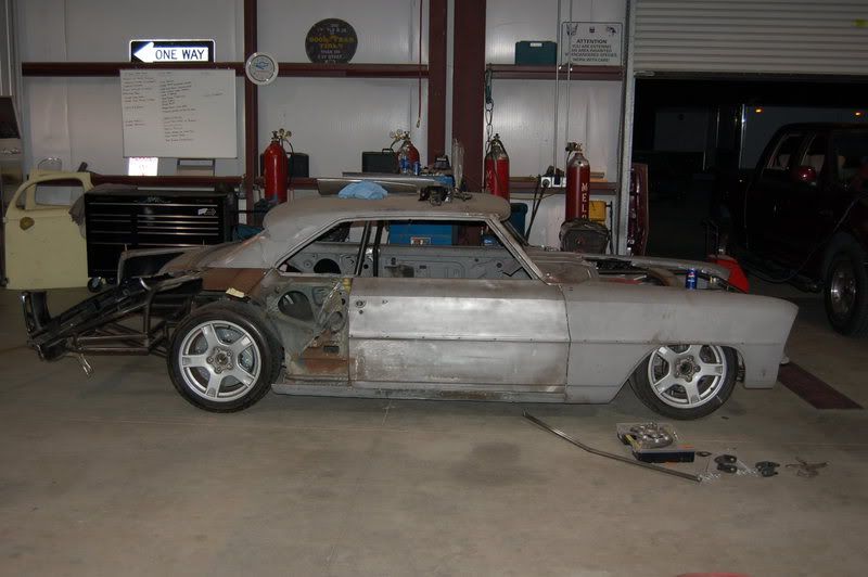

Dropped her down to ride height(4.5 at the cowl!) to make sure wheel clearance is OK! Rodger wanted to see what it would look like with big rotors so he stuck his truck rotor on the back wheel!
This is how we decided to finish the diff cage! I couldn't bear to cover up the beautiful tube work so we're just going to leave her as is! Just got to finish off the corners!
Sub floor is all tacked in!
John

what thickness is the sheetmetal inside the car?

18 gauge
