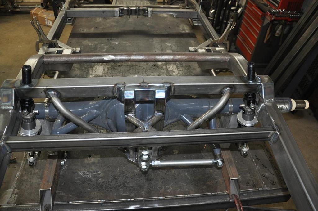

I like the adjustability on the CO mounts, is it a tuning tool other than a height adjustment? Looking forward to seeing and understanding how this comes together.

My understanding is it is just for height adjustments for my street vs track trim.
The link adjuster will be the primary rear suspension tuning tool for a TA setup to adjust rear RC.
