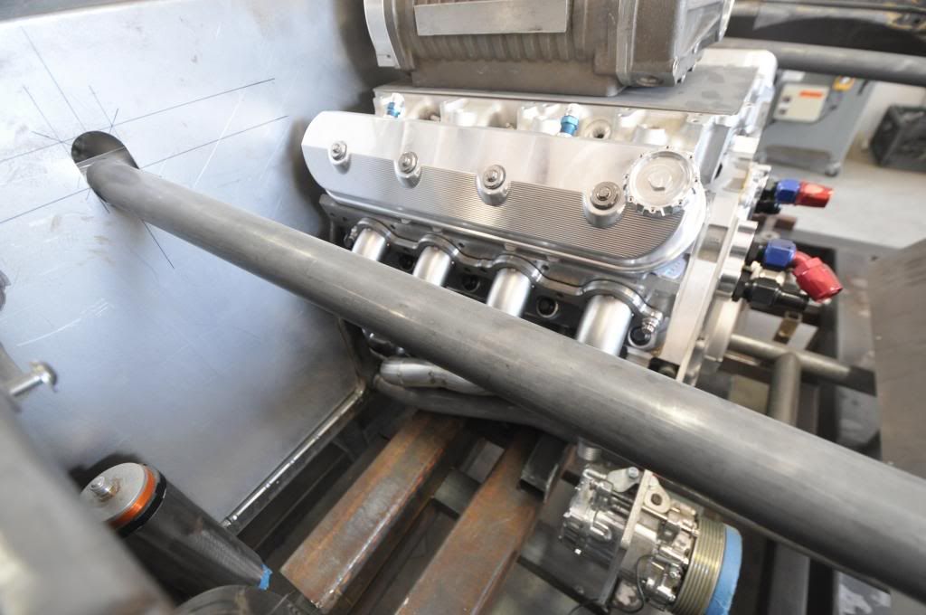

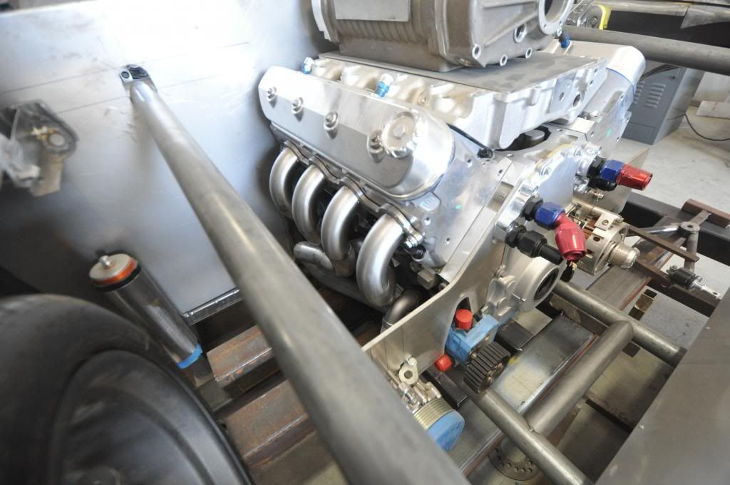

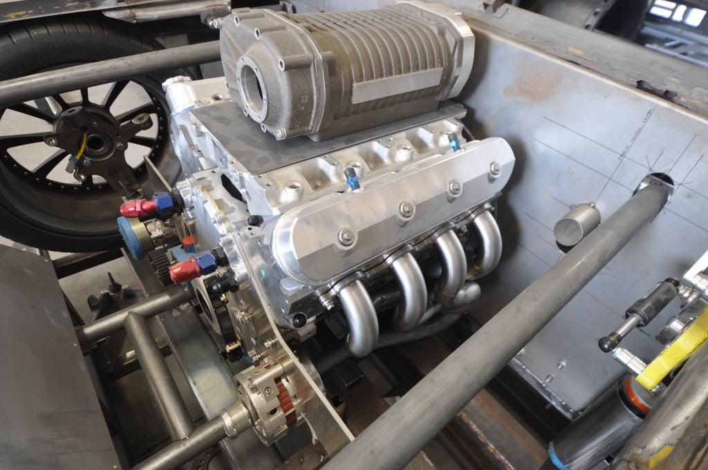

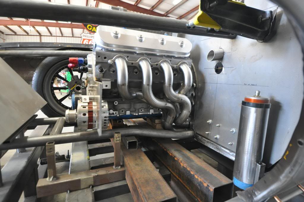

Once we had the car mocked up on the table at ride height we started mocking up the basics of the car to get and game plan for the floor and front suspension pickup points.
Just a mock up engine we had laying around.
We landed the engine where the bell housing line is even with the windshield wipers, if that gives you an idea of how far we set the engine back. About 4 inches.

is the exhaust going to run above the torque tube? because i see the extra space you built in above the torque tube and no other humps in the crossmembers .

Since the rocker taper wider to the front we just then plates the same width to trim to fit and they need to be set down. Man that would be a wall not a console if it was that high.

Tucking the exhaust in the tunnel below the torque tube will give your Camaro an AWESOME side profile...... no visible headers!
