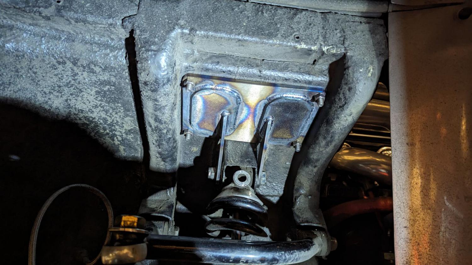

So I decided to tweak the Pantera and start racing it again
Back end of the car is twisting so I am having Down bars
added to the rear of the car attaching to the Cage inside
It is a pain as I have to remove the rear window and then
fab a Lexan piece to fit around the new tubes. We decided
to make a plate bolted thru the nice painted wheel well and
tie to the shock below. Attached is the brackets being fabbed
for the shock attachment... tubes will weld to the plate above
and we will also attach to the truss we already have between
the wheel wells... This should brace things up nice

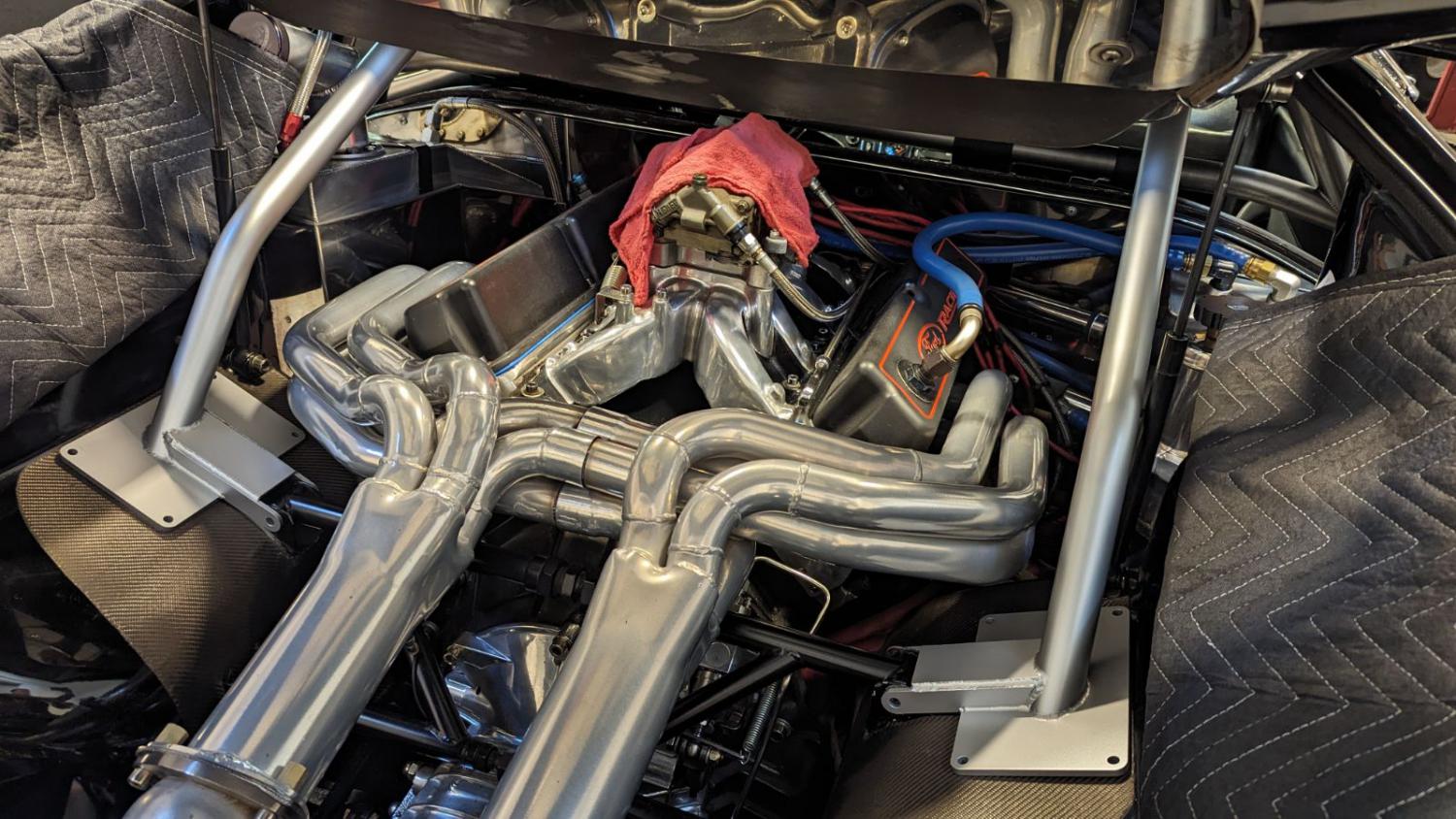

Rear bars are almost complete. Drill a couple of holes
in one bracket and weld it in. Then I need to fit a new
Lexan window around the tubes as they pass thru to the cage
Bob
