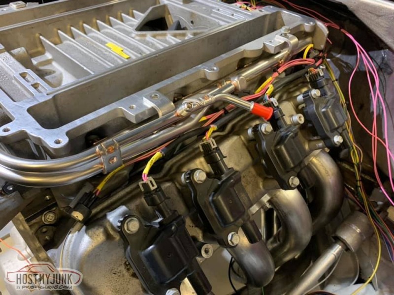

Lets start with the most boring, I did some more engine wiring. I have power wires roughed out to where I'm going to put the fuse block and I have one bank of coils done. I'm missing a color wire for the passenger bank before I can finish that side up (also a good reason to start my wiring now, I'll see what I'm missing).

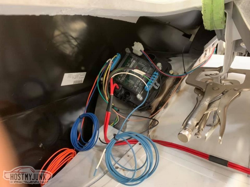

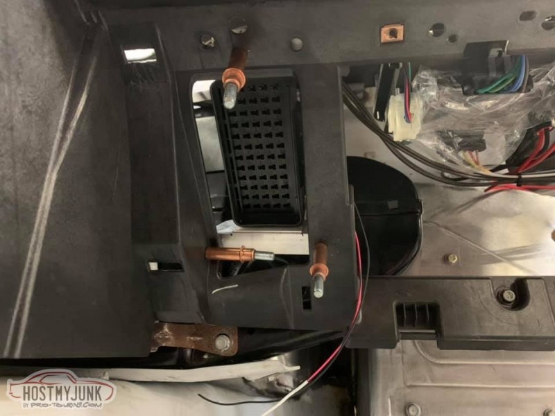

I started the body side of the Infinity Box install by mounting the master cell, the InMotion cell (controls windows and door latches) and the rear power cell and getting the harness run in the general direction the wires need to go.

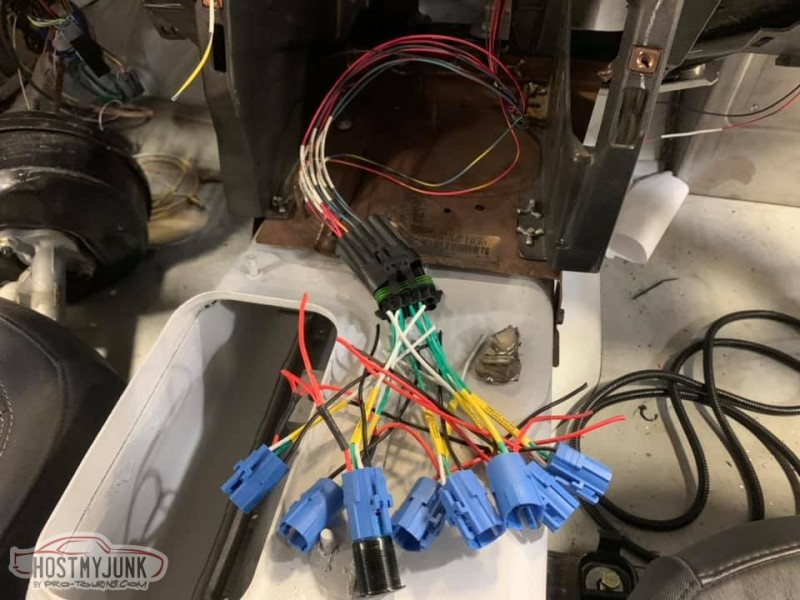

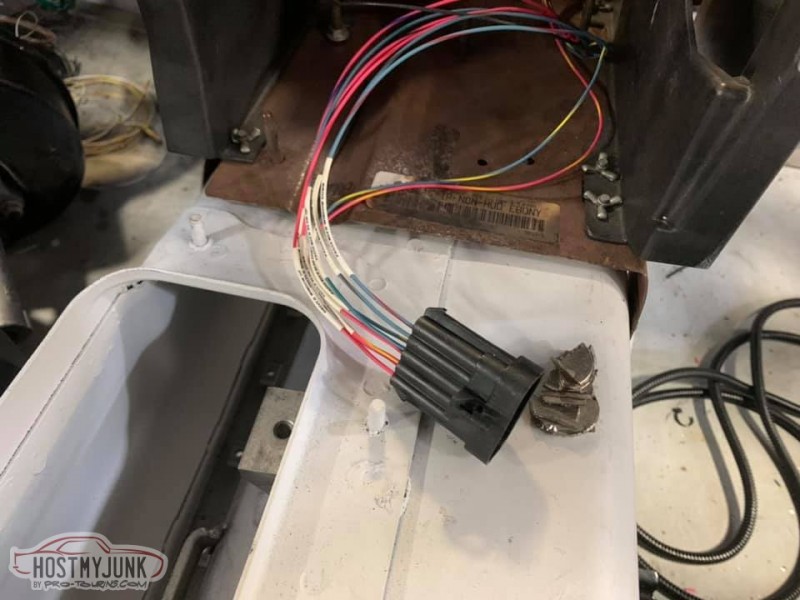

Then I started with the sub assemblies such as separating the master module inputs to where they should go. The power window switches mount on the center console so I have a main harness connector and then the switch harness so everything is easy to service should I need to take it apart.

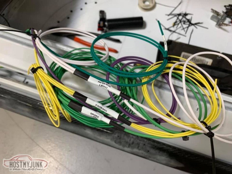

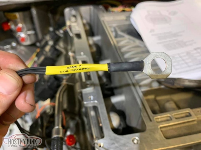

The trunk harness is also roughed out and the heat shrink label maker makes things easy to know what does what when I get to the finial wiring.

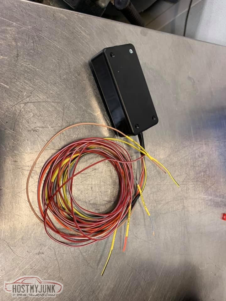

Also part of the wiring is the Vapor Works controllers. It takes a min to figure out what goes where with this system, but its much simpler then it seems.

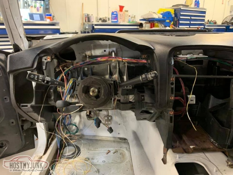

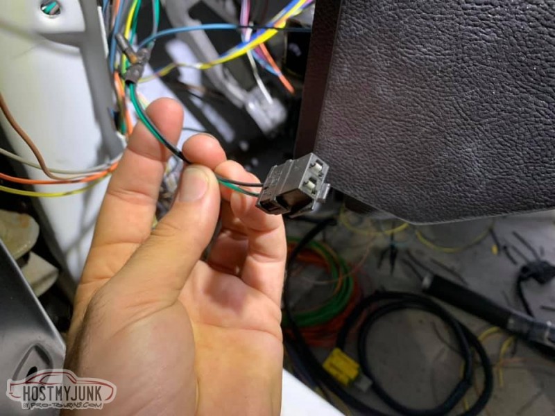

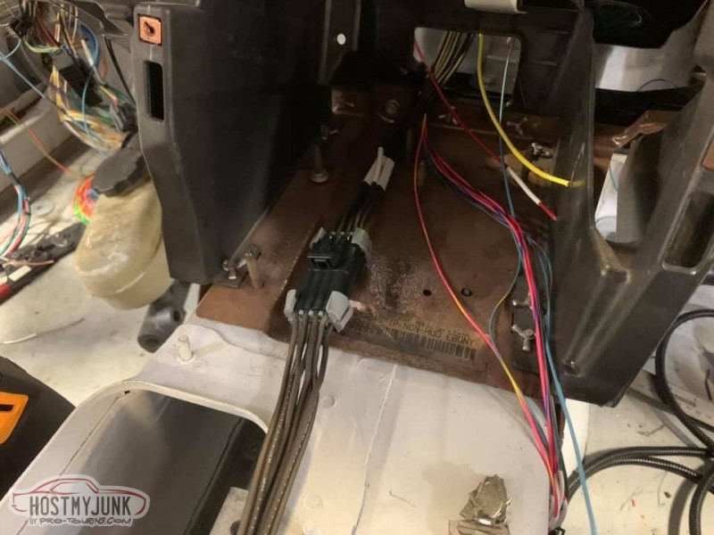

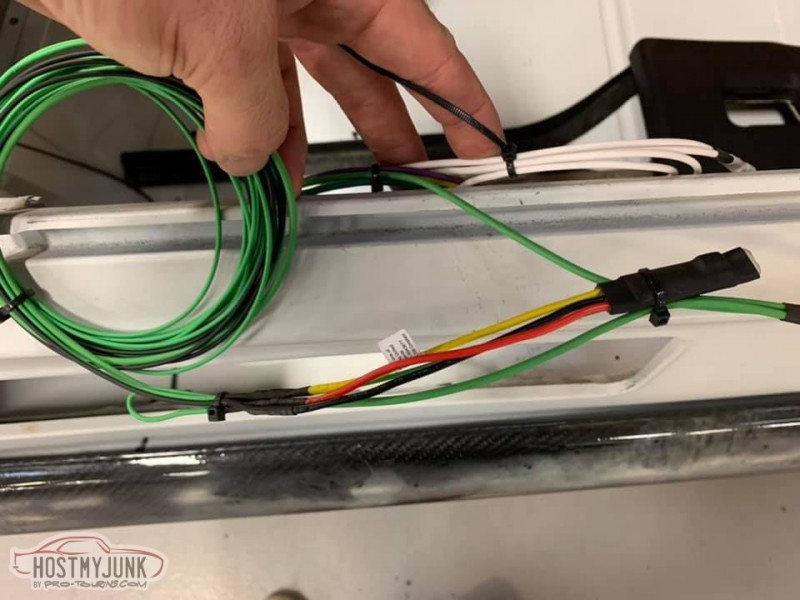

So lets start at the last update. To make my harness as much as one bundle as factory would be I went ahead and ran the door speaker wires and put a connector at the console so if I needed to remove stuff I don't have to completely take the car apart.

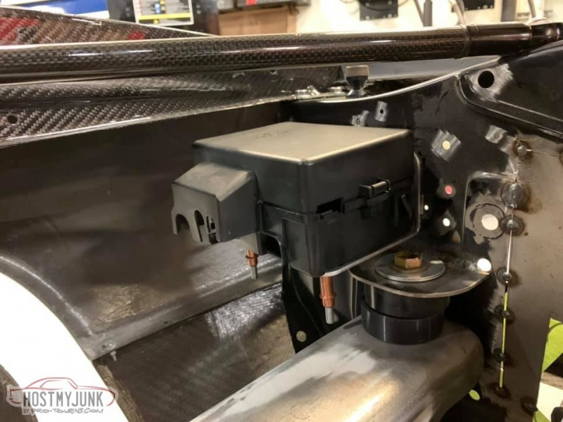

Then I moved onto the fuse blocks and getting them mounted. The interior block I mounted where the C6 keyfob pocket used to be since its useless oin my car. The underhood fuse block I used a block from a 2000 Astro van. Its the same block that GM uses is their crate engine harness.

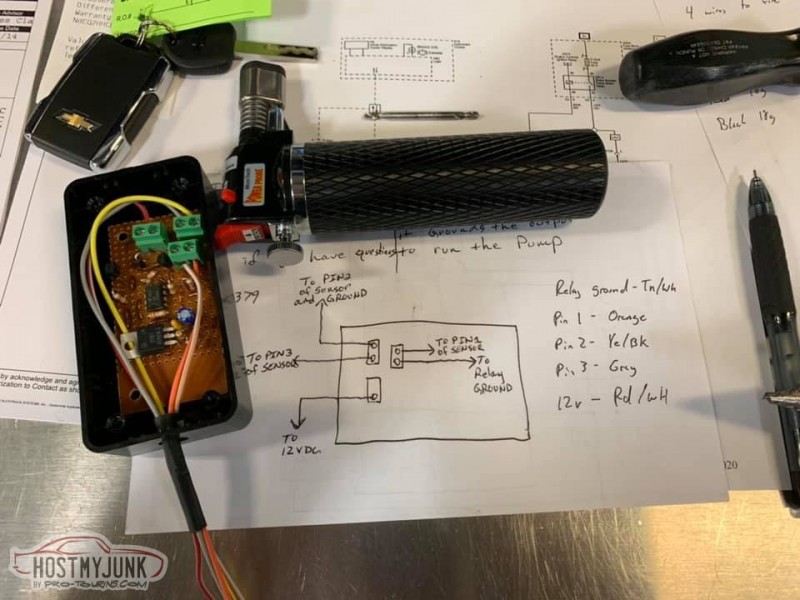

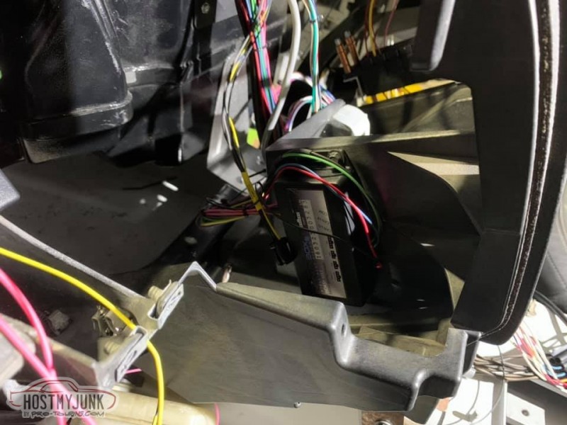

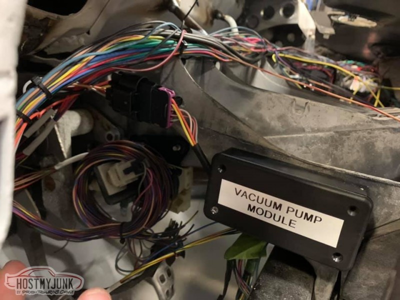

One of the guys on here built me a vacuum pump control module and I mounted that inside the car after wiring it up.

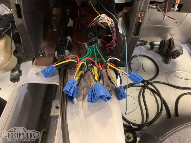

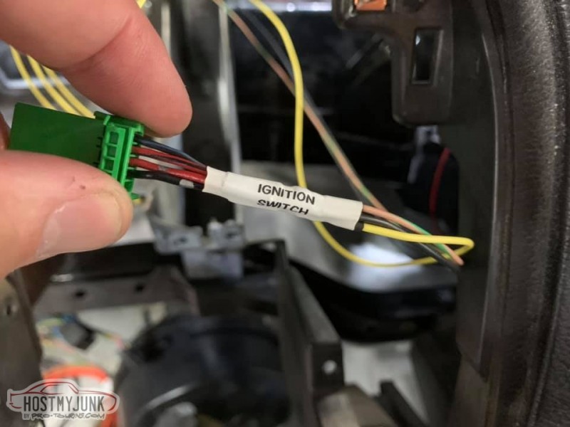

Then it was just some odds and ends stuff like adding a third brake lamp flasher for extra safety, the ignition switch connector, and finishing up the power window switch harness.

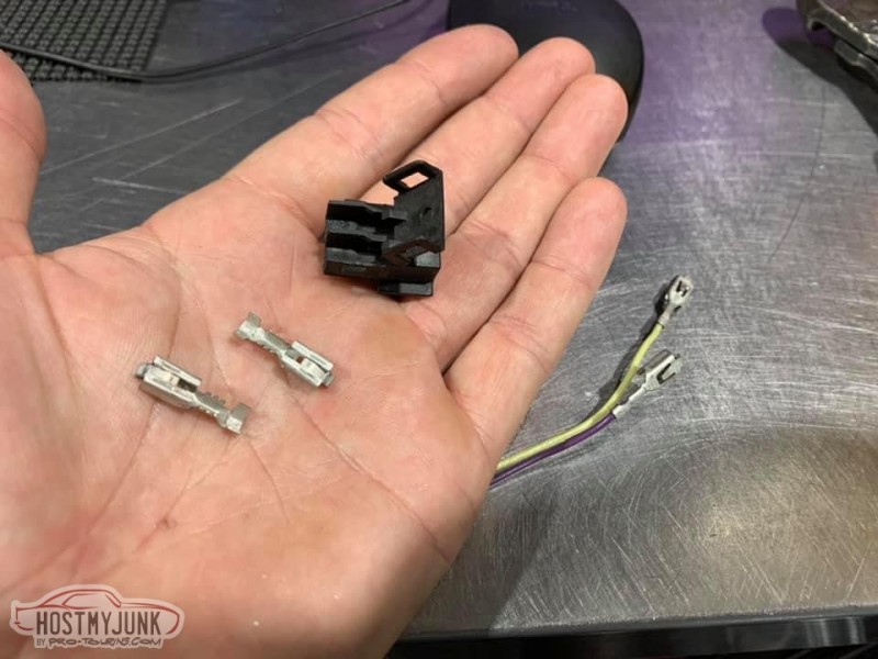

After that I moved onto wiring the under hood fuse block with as much as I already had from the ECM and misc. sensors. The nice thing about working at a dealer is we normally have all the right terminals in stock so I don't have to order them or scab cut wires together.

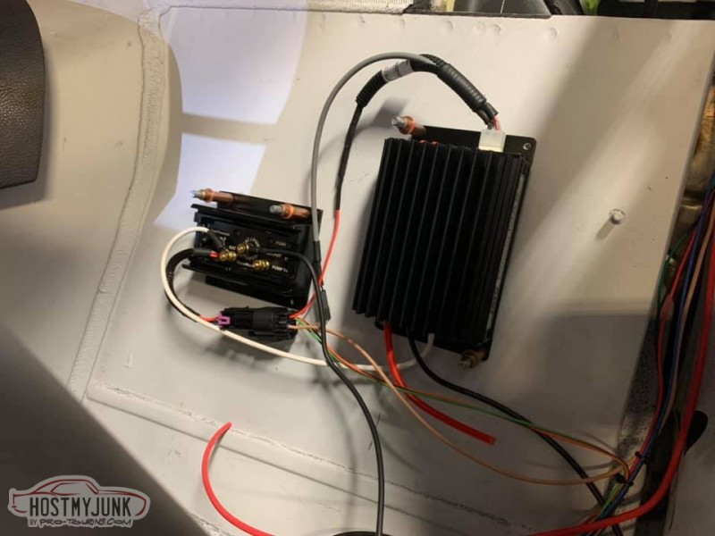

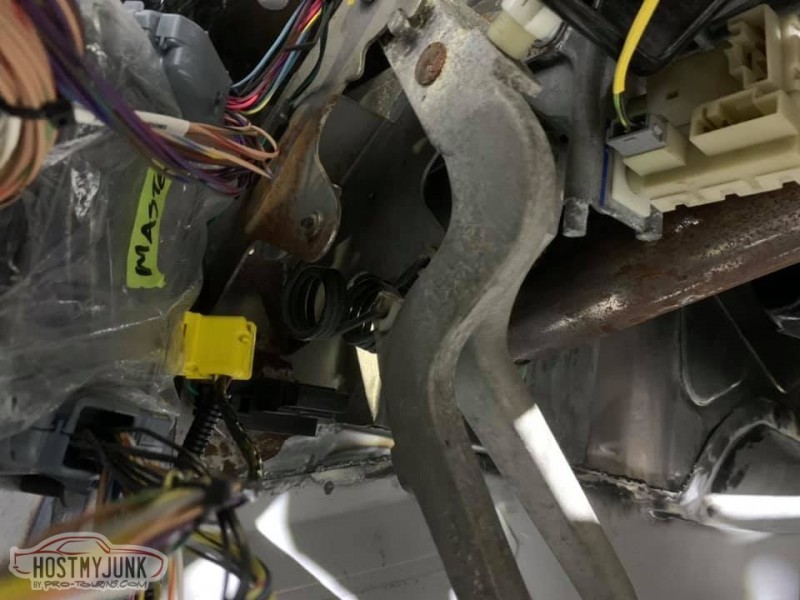

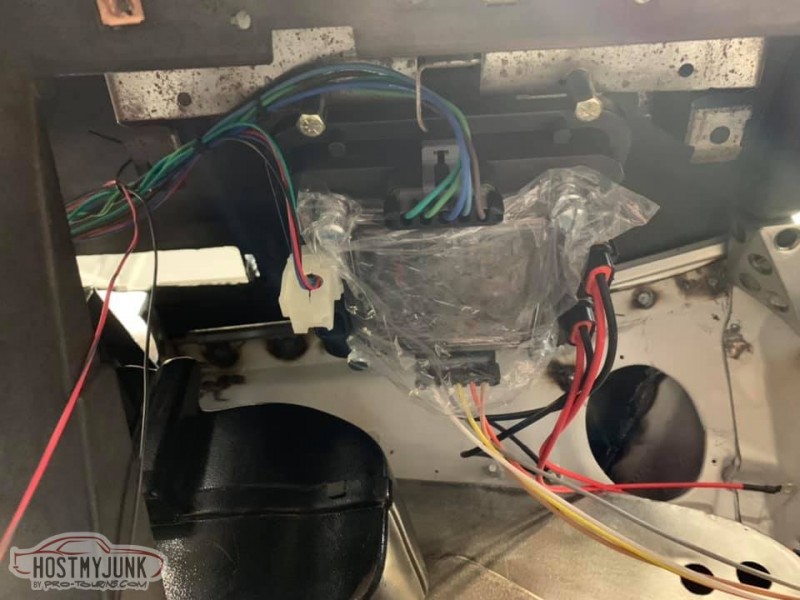

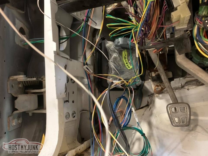

Which brings me to this past weekend. I mounted the HVAC Dakota digital controller and harness, started wiring the Infinity Box inDash unit and more Master cell inputs like the brake and clutch. Also again, nice to have access to the right terminals to keep as much OEM as possible.

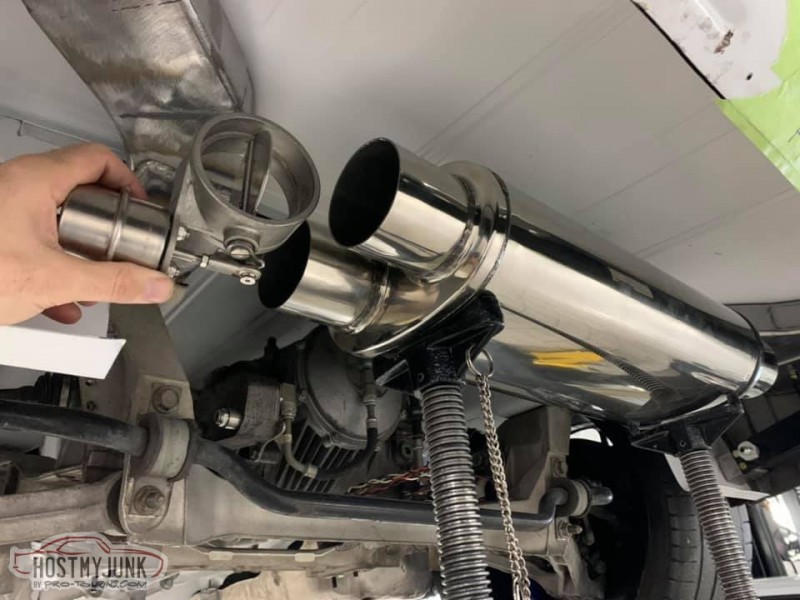

I wasn't super excited with the Borla muffler. I wanted a real 3" duel in and out X pipe muffler. The problem was the one I wanted that would work for my setup only came in a kit Holley sells for 6th gen Camaros. Luck would have it that a buddy of mine got a job with them and was able to get one for me. The plan here is in on one half the muffler with a vacuum cut out that will me module controlled like Camaros and Vettes are for a mild to wild tune ability.

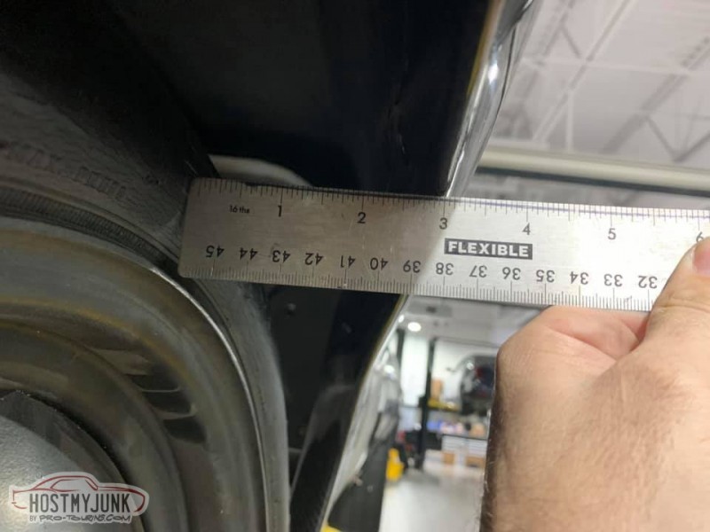

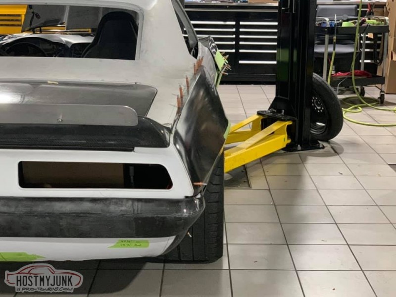

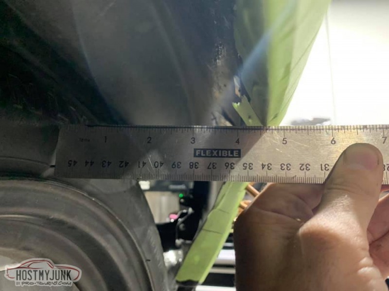

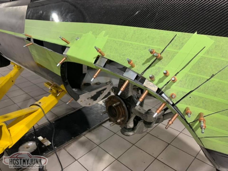

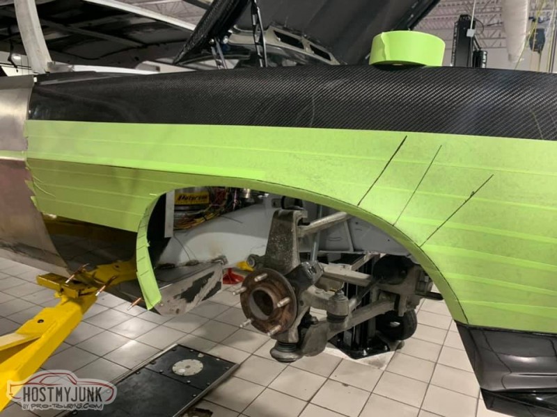

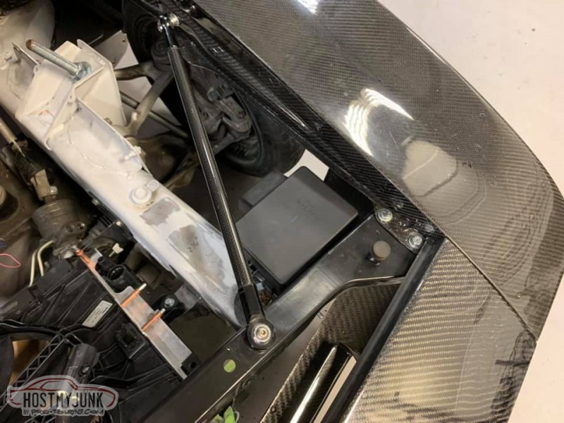

So with that checked out I went to the front of the car to slice up some expensive carbon fiber. I need more room up front to fit the tires with ZR1 brakes and the vette suspension. I gained enough room I hope. I need to find tires to check the fitment. Planning on getting this side done before moving onto the driver side.
