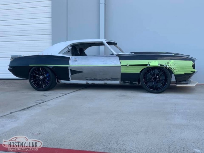

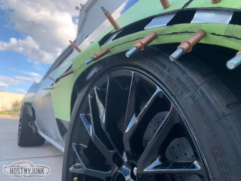

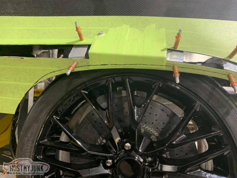

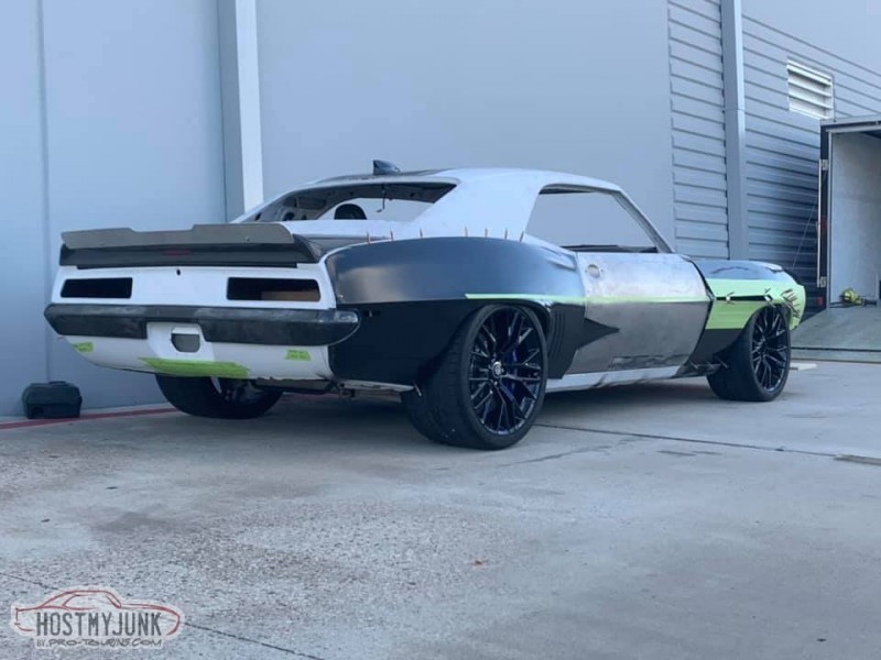

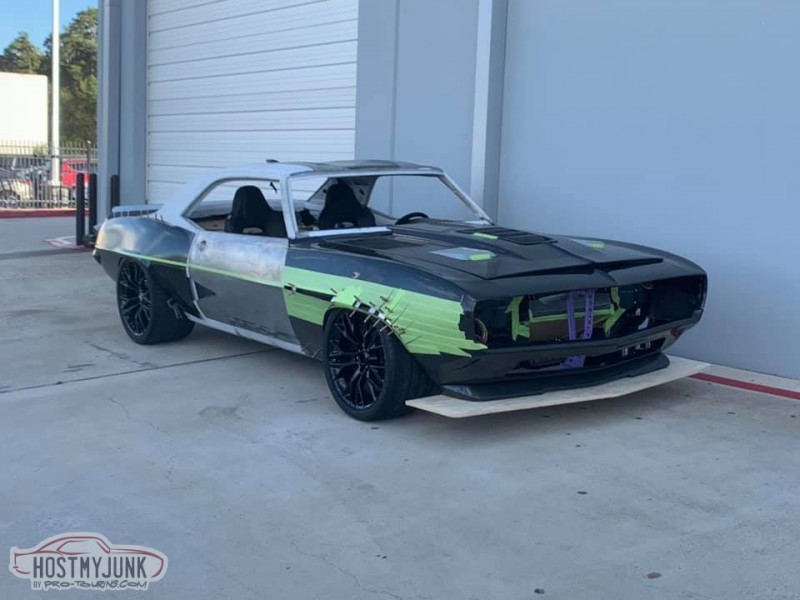

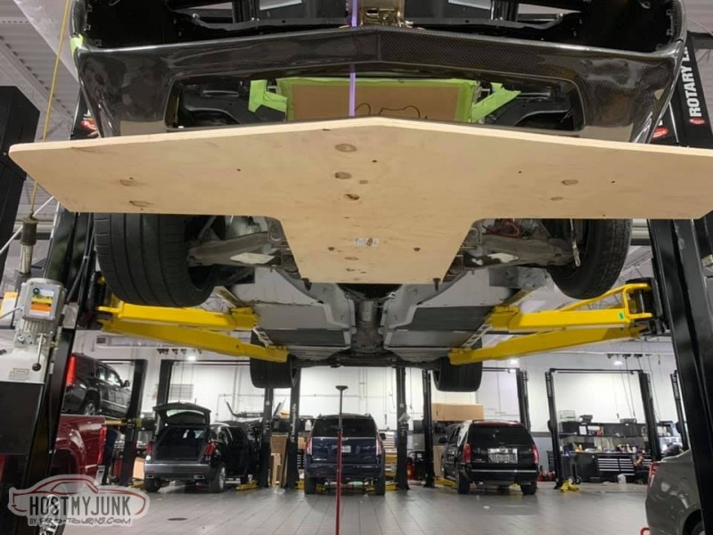

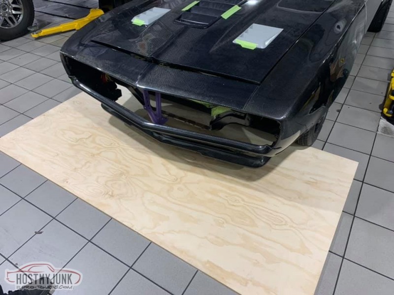

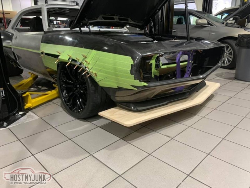

OK so here are some updates on whats going on with the car since its been a while. While I was working on it the last time I learned that I wasn't actually aloud to be doing so as its against company policy and my manager was misinformed when she said it was cool (because I asked before I even came to work here). So I haven't been able to work on the car in about a month now. What I was working on last was the splitter and the wide body front fenders. Here are the pics so far. I'm not happy with the splitter as its 7" off the ground at ride height. I think I'm going to build a taller spoiler and drop it down 2" more.

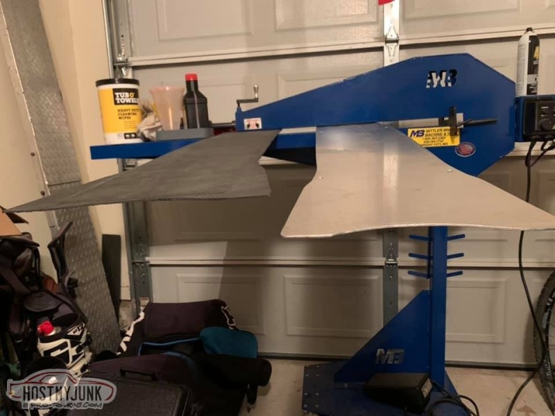

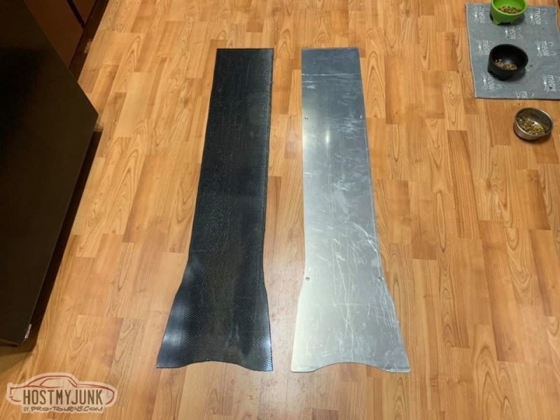

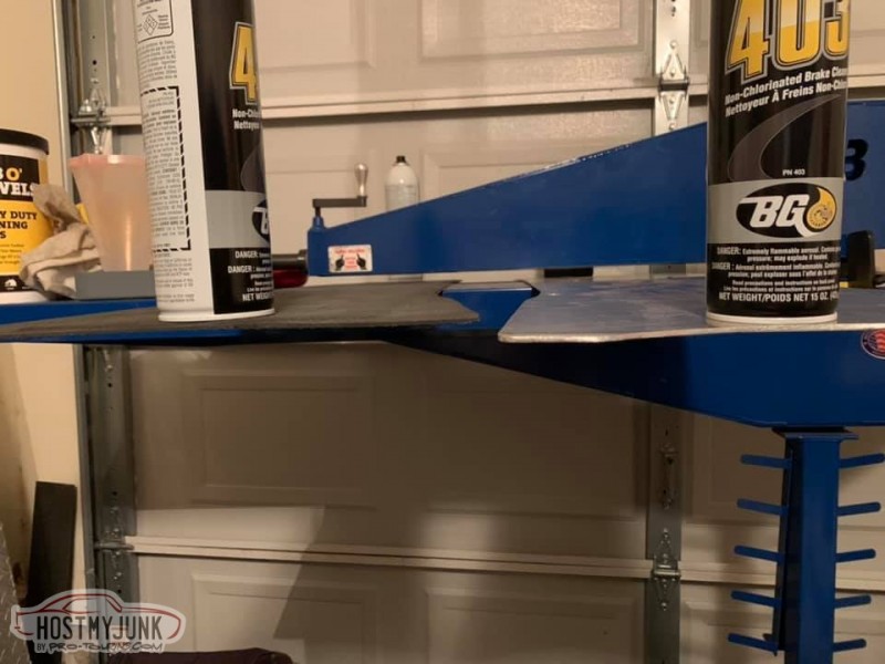

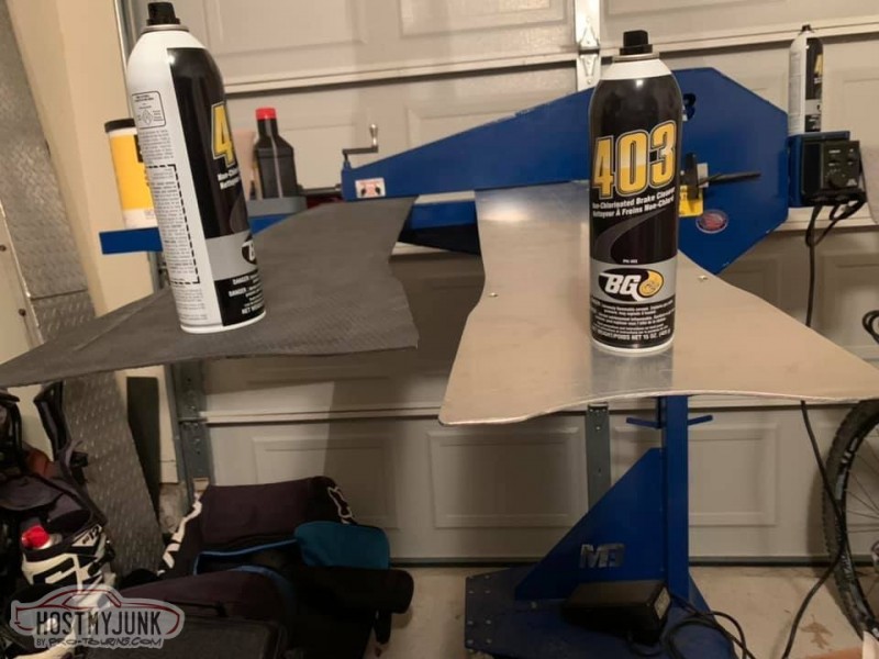

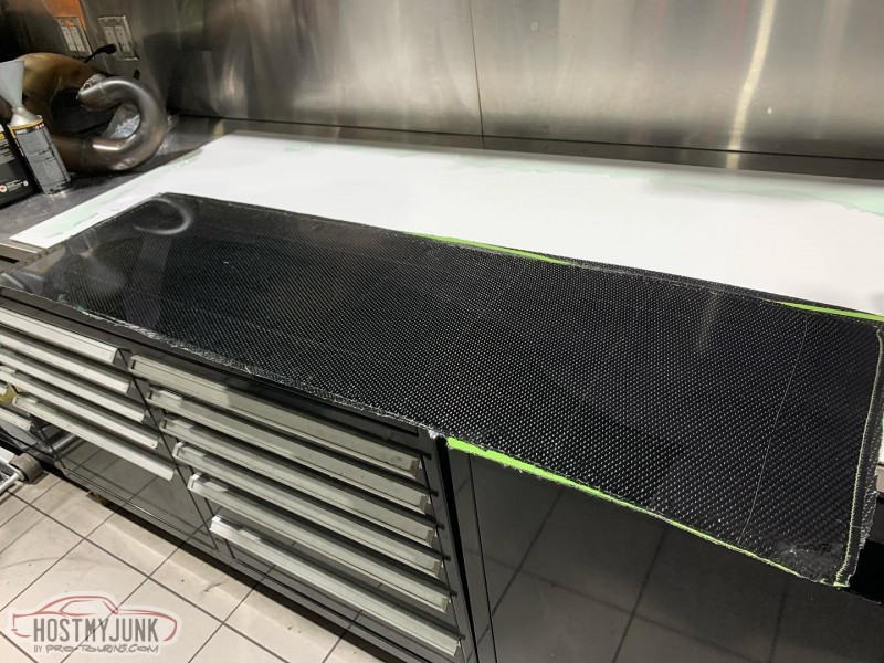

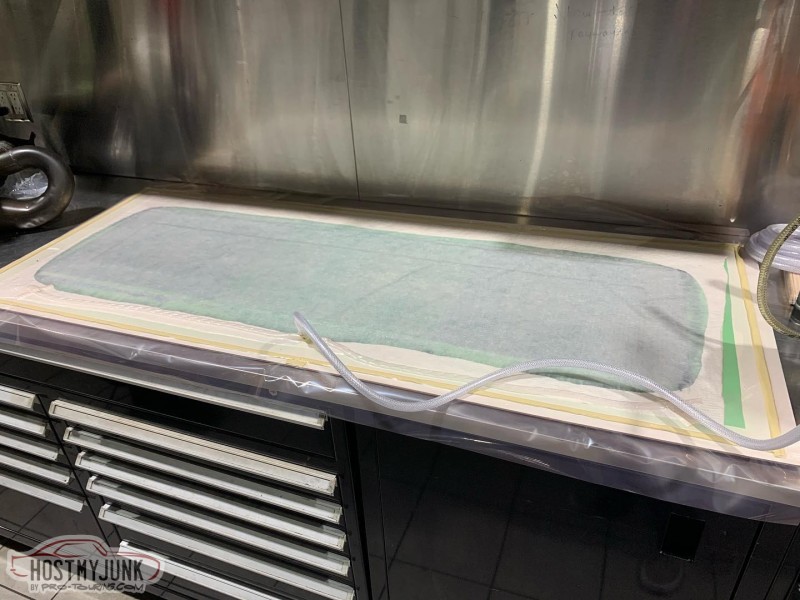

With not being able to get the car into the shop I have to find other ways to get things done and keep some kind of progress going. I started with the transmission tunnel plate. I went with 6 layers on 11oz carbon and a 2mm core in a wet lay up then vacuum bagged it. After trimming to the right size you can see how much stiffer it is from the 1/8" aluminum plate. I saved 2lbs with this as well.
Even with 12" of over hang the carbon is still stiffer then the aluminum
