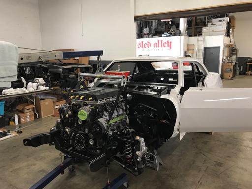

Originally Posted by Stielow View Post
Engine is in
Does the LT5 clear the hood Mark? Did you go with a bigger cowl?
With it fits under the stock profile of a 1969 Camaro without the structure under the hood. I use a Carbon hood off my molds.

Just wondering - have you mentioned what gear ratios your going with on this one? Any info on the third member you selected?
Thanks again!
I’m running a 3.50 ratio with a Tremec Magnum with a 2.66 first gear. I ran a similar set up with my LT4 and it worked well.
The 3rd member is a GearFX Ford 9 inch the Ford gear is micropolished and run in on their dyno. If you can find a real Ford gear I’ve had the best luck with them for noise.
