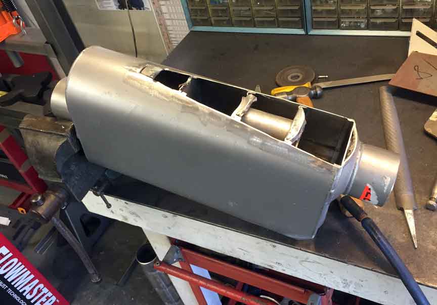

Still working on getting the car sorted out. I've replaced the mufflers with larger ones and doubled up on them with a set of classic chambered exhaust. Of course, they were too big to just fit so I had to modify them in a couple of areas. It's still loud but it is quieter than before. Also tightened up a few bolts to fix a few leaks. Just about every fluid in this car is leaking somewhere. Grrr. While doing this I discovered that the heat of my headers is melting my engine mount. I'll add some insulation and keep an eye on this. Also some gunk has accumulated in the radiator already so I'll be doing a flush on that before replacing the leaky water pump. Onward and upward...

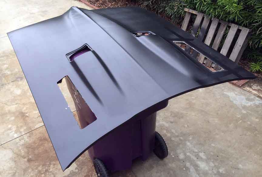

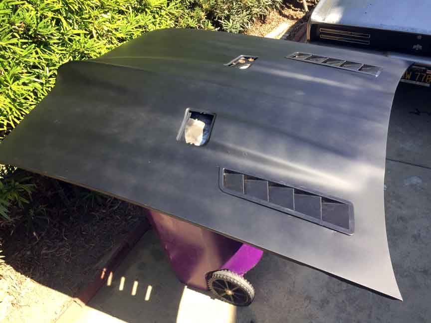

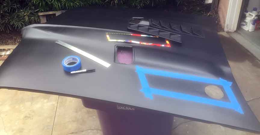

After building a wood foundation and a plastic shed kit (honeydo's) for our back yard I spent a little time on the bird's hood to cut holes for the hood vents. I quickly sprayed some Eastwood rust encapsulator on it, and the fender tops and spoiler, too. It's by no means pretty, but it'll do for now.

Where did you get the hood vents from? Looks like Mustang vents.
I've been wanting to do the same with my 400 hood.

good ol' ebay...
http://www.ebay.com/itm/17-x5-UNIVER...6cc5a7&vxp=mtr

Thanks, Wayne! This should help with airflow in the engine bay and a place for heat to escape. They appear to be made of Poly propylene, so I may need to also mechanically fasten them as well. My plan was to glue them down with that 3M panel bonding epoxy, but I also know that PP (the material) is not easy to glue. For now those big holes in my hood should help make alignment easier as I can actually reach in and adjust the fasteners, ha ha
