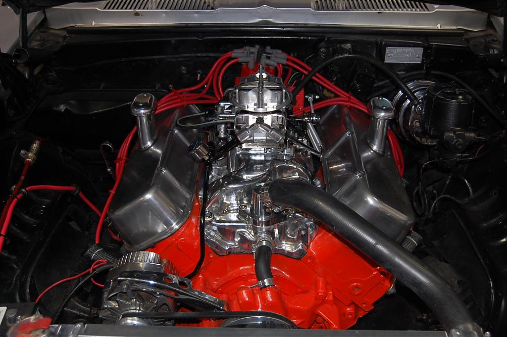

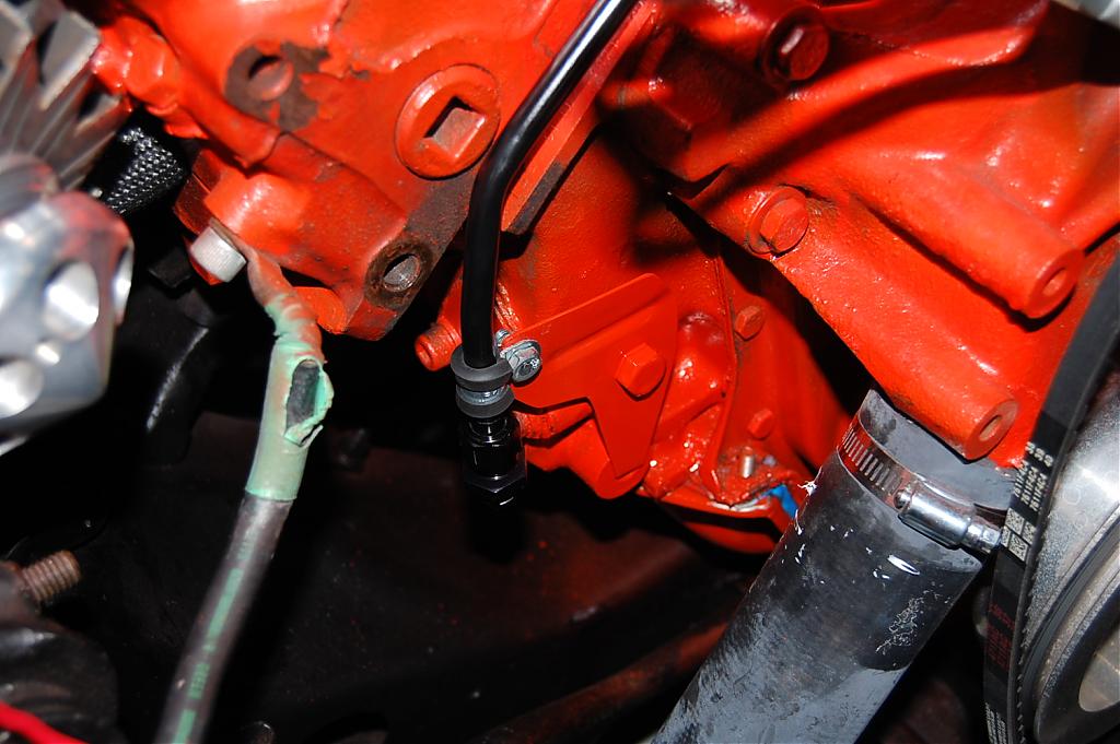

Greg - Couldn't find one the went from the 8-AN fuel line to 6-AN carb line. Not happy with the current system, thought about running old fashion steel or synthetic up from the pump. It will change at some point.........
Yeah, I would go steel and keep the lines low, down to a bracket at the front of the block then flex line to electric pump.....like what I did on this 69.... Looking good.

I never liked keeping fuel lines that close to the eng. Creates a lot of heat in the fuel...vapor lock. Don't you think?
Thats what I hear but I never had an issue. I like to have at least a 1/2" of air gap space around it. Nothing ever touching.
