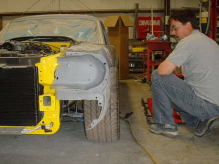

Hi All,
Here is our current problem
No the problem isn't Wayne. The problem is the width of the front track.
If we leave things exactly as they are, we will end up with a front wheel flares that stick out about 2 1/4", while the flares on the back stick out about 2". If we do this the car will have a rather strange appearance where the front track looks wider than the rear. To resolve this issue we need to shift the front wheels inboard about 1". This will give us a 2" rear and 1 1/2" front flare, which should look more appealing. We were giving consideration to resolving this issue by using front and rear wheels with different backspacing. We didn't really like this idea because we want the wheels to look identical on all 4 corners and a 1" diff in backspacing would be pretty obvious.
So, we called our friends at Maximum Motorsports and asked them if they could make us a custom lower control arm that would be 1" shorter than stock. They recommended that we use a fox control arm which is 3/4" shorter than the SN95 piece.
Wo Hoo!!!
This will solve a number of issues we were having all across the board.
Well, back to work on the fenders, hood and front end.
Catch ya’ll l8r.
Bob
Come see this WIP at
Julian's Collision Center
http://www.julianscollisioncenter.com/

Well you could not have changed the backspacing with those wheels anyways. I had a similar issue with the same set of wheels and there is not enough material to machine off the mounting face to get them to shift inward.
Are you concerned with the narrow track width? I know its not a race car, but thats going to put it off-par of the 03/04 cobra chassis. Hopefully the weight difference will help balance that out

Actually, I am not really concerned with narrowing the track. And I will tell you why and you can tell me if I am full of it.
Yes the track at the front will be about 2" narrower than the 03, but (on the other hand) the track will be considerably wider than a 65. Also, the wheel base has been extended 7" which should shift the center of gravity (in relation to the wheels) back quite a bit. I will not know how much until I can actually weigh the beast, but on a stock Cobra the center of the front wheel was right between the 2nd and 3rd cyl. Now the CL of the front wheel is actually in front of the 1st cyl. Ya think that might help a bit with front to back weight distribution???
Bob

The only thing that will be affected buy using wheels with more back spacing is you scrub radius. All other geometry will stay the same.

Hi Jeff,
When evaluating the suspension, imagine this as a modified 65 fastback, not a modified 03 Cobra.
That being the case, the differences from stock 65 are....
1) Wider track both front and back (just look at the flares used and you will get a good idea as to how much).
2) McPherson strut front sus with power rack and pinion (not as good as unequal "A" arms, but much better than the 65 stuff especially with the Maximum Motorsports mods).
3) IRS rear (not the best IRS, but much better than the 65 rear especially with the Maximum Motorsports mods).
4) Much, MUCH stiffer chassis.
5) Better weight distribution (the 4.6 sits back farther than the typical Windsor small block).
I hope this helps
Bob
