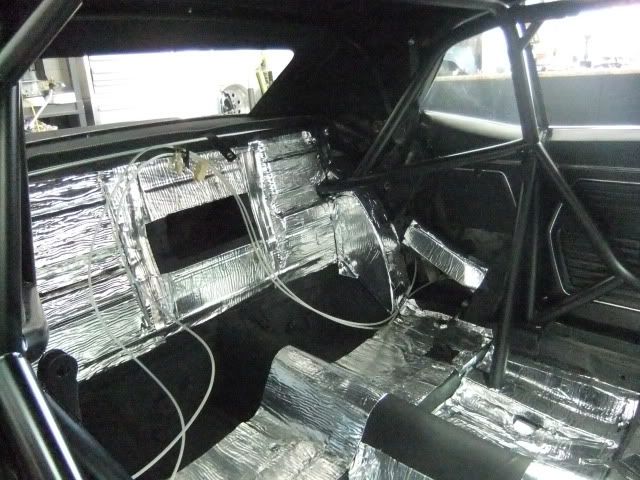

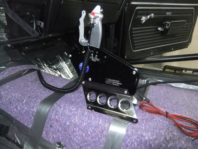

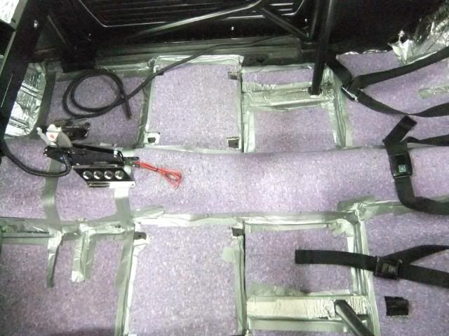

i have been working on the car slowly again. I had to go thru back surgery again (Feb 2011) my doc had me in his office to look at some films he had taken with the magnetic resonnance machine (term?) cause i was complaining from pain all the time and when he saw what my spine looked like he said (it was a Thursday) ; '' i have to get you under the knife monday morning first thing...I dont even get why you are still up, you should be in a wheelchair''. My spine was compressed over 75%.....Talk about recomforting someone!! ( i had all sorts of neurologic problems that i will spare you guy's lol!!
Anyway, that is somewhat behind me and i'm strating to get back in shape but i have to live with a continuous pain... Good thing is i did not sell the car ....yet. I keep doing it as i can but i have to be honest, it is soooooo frustrating.....
Anyway, feels good to complain once in awhile ( i really need to vent it out). but that is not why i come here, i just feel like i need to excuse myself for the loooong way to the top.
So, without any more crying, here is where i am now, i figure anywhere from 2 to 3 weeks and it should be out. Only needs windshield, exhaust, finishing to put the interior in and some small bits and pieces to be at least driveable;
did the dynamat and some dynaliner kinda stuff over the whjole interior
carpet is now all trimmed and installed
i did change my shifter
got my Strange chromoly shaft
new canvas top is on
bought the belts
i also got a tilt column, all the rubbers and felts, battery kit and wiring and so many parts i prefer to loose count!!! You know what i'm talking about right....
Anyway, i tought i would post where i am now. I'm looking at selling my wheels for some 18's (x9 and 13) sometime during the summer if everything goes as planned. I had the starter crank next to the car last week so its almost alive!!! Few things to finish before starting it up but i'm getting there.
Sorry for the long update but i have a long way to catch up!!! I am somewhat ahead of these pics but you get it, its really on the last miles. Just hope i dont get into another mishap or this might be the FOR SALE sign that will be the next posted picture!
Hope you guy's like it!

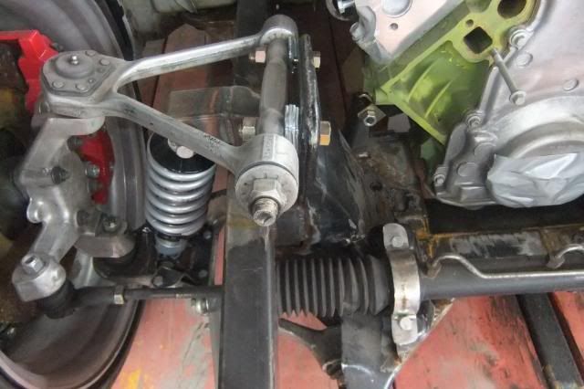

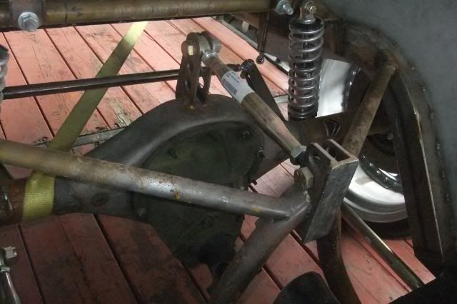

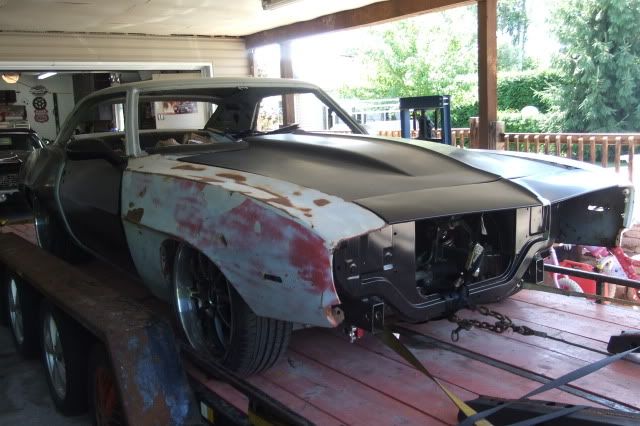

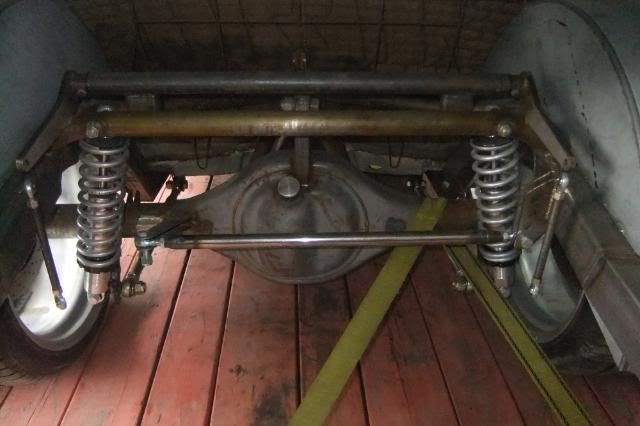

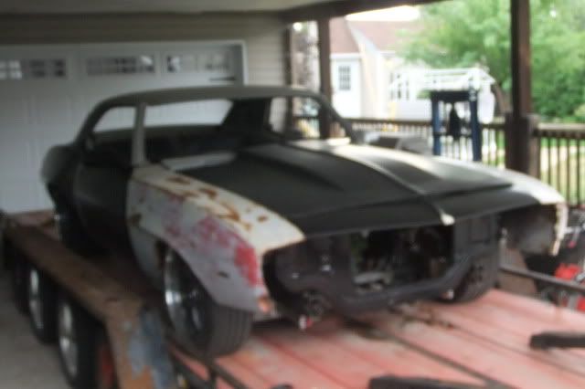

Well.... Got the car!
We went from Montreal to Quebec city ('bout 3.5 hour ride each way) and we got chased by ''IRENE'' on the way back!!! Man i was thinking about Wayne all the way lol!!! (WainieZ member on here that was supposed top get his car at Mikes Custom but postponed due to Same IRENE condition).
Anyway, i tought you guy's would like to see it, it has parts you have already seen lol! But my friend really started a killer project... There are so many small details ant attention to them it takes time to sink em all in. For an amateur (as in garage built) its something...

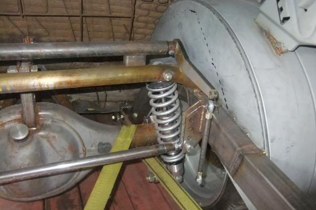

It has a completely built front clip (off Morrisson GT sport sub specs) and using a C6 crossmember and suspension hung from Qa1 coilovers.It also has a very nice splined sway bar.
The frame connectors are out of view and of way being ripp offs (lol!) of the late (not wayne due the other company, cant remember just now, they did IRS for first gens...come on brain come on, i'll remember) and they follow the rocker panel (inner side along the pinch weld) and attach on the sides of the front and rear subframes, real nice.
The front sub attaches at original mounting locations and instead of being welded and not removeable, its bolted per its sides to the frame connectors whom come to meet it on each of its side (2 big bolts on each side solidly add retaining force the holes are sleeved and everything is welded and shaved to a clean install. I tought it was a very nice set up, i usually always want to weld everything but yeah, cant remove it afterwards, i thing this is a very nice compromise and its really solid and reduces flex a lot...
The rear is the same, it is built off a set of (cut and modded of course lol!) CE rails. The suspension set up is a 3 link with panhard bar and is also hung off coil overs. There is a big anty sway bar up top and it has a killer look as well as a complete adjustability. The nice part being custom made is that he built it to lay soooooo low and has a ton of adjustment while not protruding inside the habitacle.
The rest is a bran new body (full 1/4's, complete doors, composite fenders, header panel, valence, tail panel, 2 inch cowl hood...name it.)
Wheels are my old (still yet to turn a mile on the road lol!!!!) ZX3p Forgeline's in 19x 9 and 20 x 13 w/345's and my (same age and story) Z-06 Brake set up at 14 and 13 inch front and rr rotors.
Car is mostly complete parts wise and basically needs some finish, paint and assembly.
I tought i would buy it, strip it of what i wanted to Pro Tour mine and flip it but the more i look at it the more i realize he did such an awesome job it deserves to be done well and finished.....Dammit!!!
I have the T56 and 6.0 sitting in it and i'm taking them out also.
I'll see. I started to think of maybe finishing the season with mine and selling it off and start on the coupe... I guess i like building them more tahn riding them !!!
Enough of my ongoing typing...onto the fun stuff;

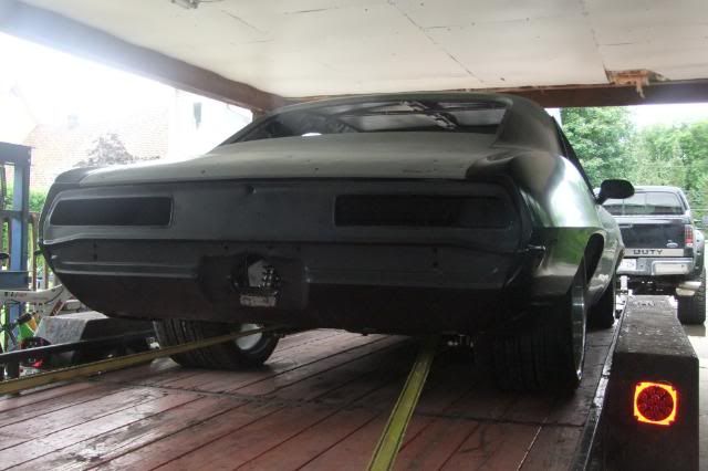

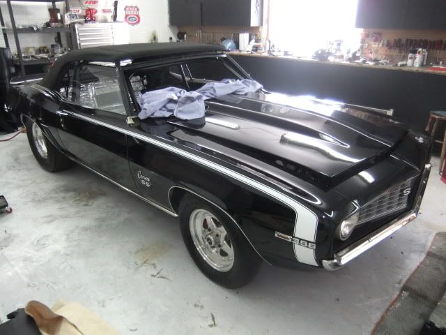

here's some more...had to take a break :-)
this is ride height (5 inches) with everything all tucked up) and clearing, it can even ride lower w/o problem. The suspension has been done by a local Pro shop that builds Nascar series cars. The rest was done at home by my friend (body and sheetmetal).
What do you think? pick it clean and update the 'vert to PT? Just sell it as is (flip) and make a buck? finish it as an over the top contender(i was already building brake ducts in my mind this afternoon while looking at it lol!) or what?....

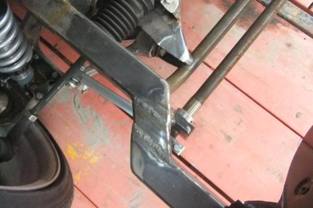

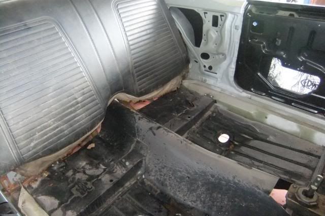

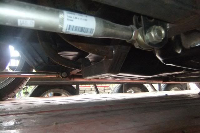

A few detail shots....
I might start a For sale thread next .......
I'll see.
Thanks for the support in my sickness of ''Going merry go round'' guy's...It is, nice to know there are people who understand...
