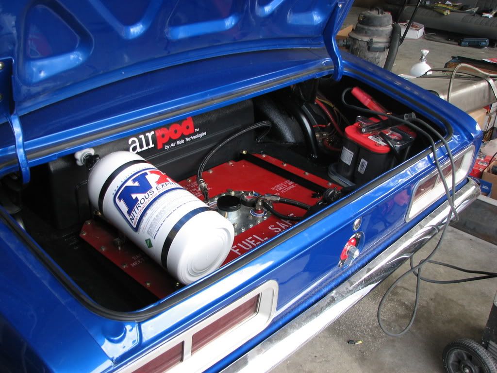

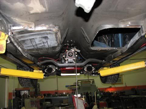

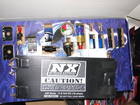

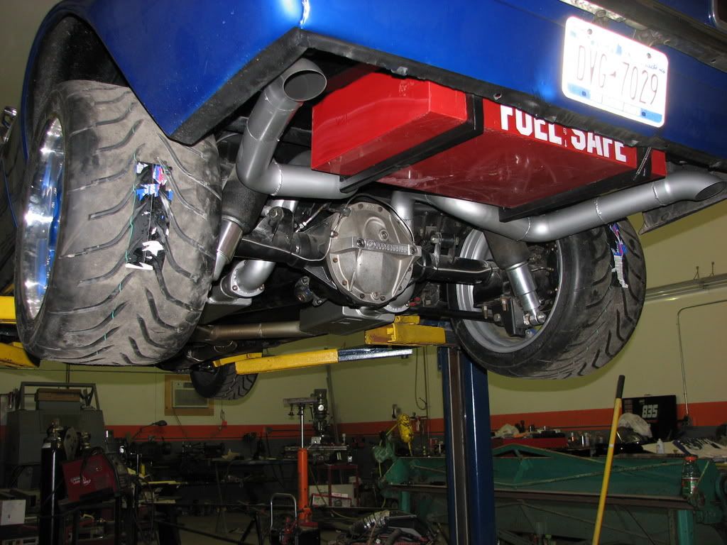

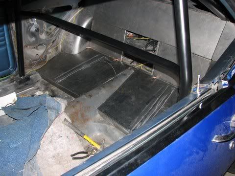

another update we are on the home stretch, got the nitrous from NX, and it is awesome stuff, will provide detail pics later but brian havins there really set us up with the right stuff the first time.Got the rear passenger floor pans raised and new panels made, got rear firewall sealed and coated, and interior is all in and doing final nitrous install, vinny will be drag racing next monday, he also got slicks and skinnys for it, should run a very low 10 on a 100 shot.
it ran a 7.63 100 8th with 265 18 inch rear tires peddling it the whole way. should be good for high 10;s on motor.
the door in the firewall is access to the air pod connections.

he ran 11.05, 10.84 then 5 straight 10.60's with a 10.60 flat at 130mph with a 1.60 short, the 1-2 shift was hitting rev limiter all day, the 2-3,shift was perfect, he is shifting at 6200 motor rev limit is 6800, hes got 1-2 tenths left on motor once dialed in, plus he didn't turn on the happy gas today, we will see what 150 and 200 shot do for it, this is all on air ride air bar, rear susp. will have pics at the track later.

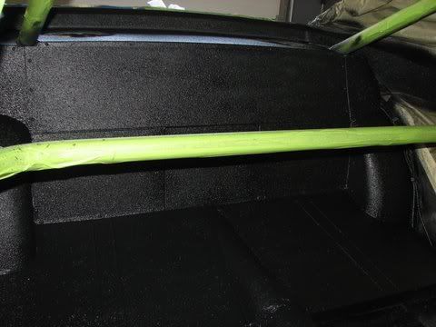

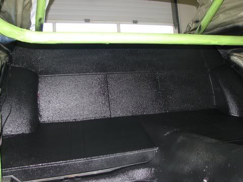

crappy pic showing difference from carpet to raptor liner rear firewall texture
will have better pics
