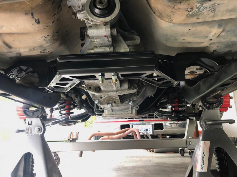

Mock up continues. I'm lucky to be able to work from home. So, when the work day is done, it's garage time
I'm impressed with the Holley/Hooker LS swap mounts and transmission cross member. My car has stock height Global West solid body mounts. If you look close at the pictures, transmission fits, without major surgery, just a couple places to "massage"

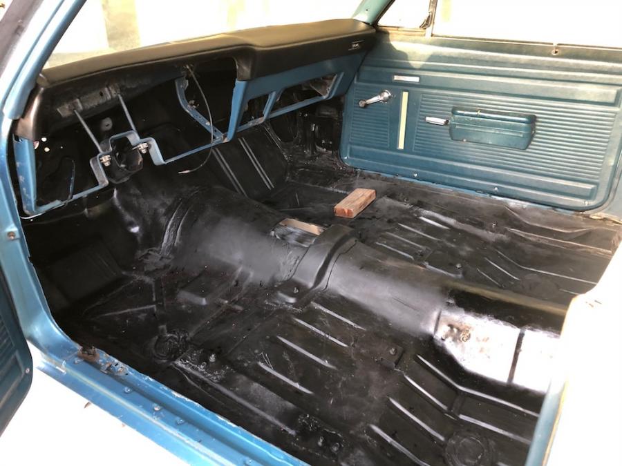

Mock up continues..

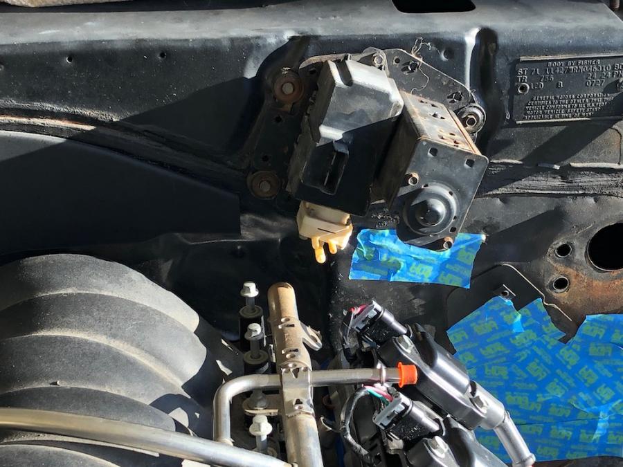

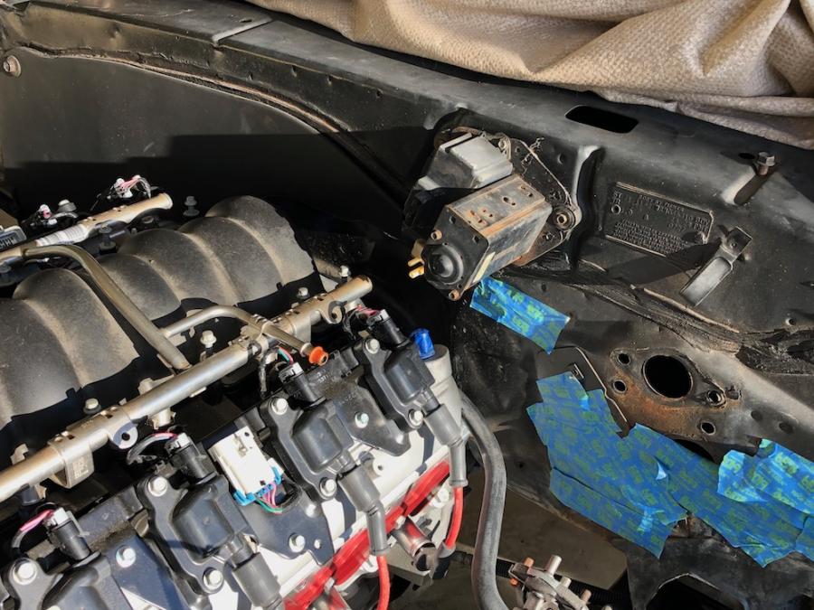

1) For those interested in where the motor sits with the Holley/Hooker mounts, here's a shot of the engine/firewall clearance.

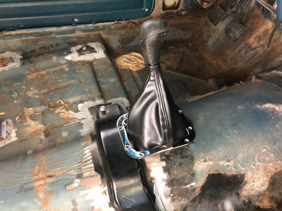

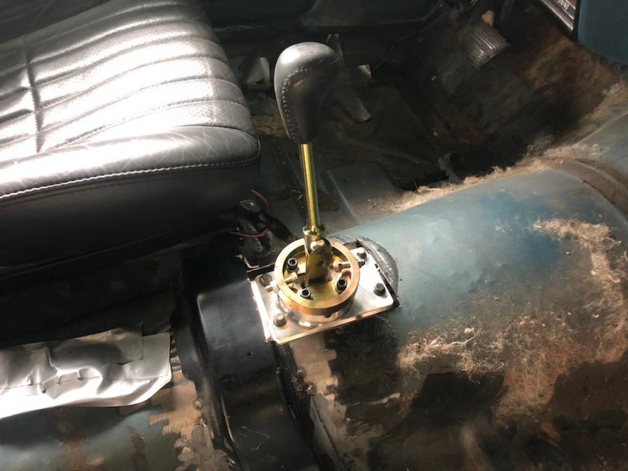

2) Quick shot of the interior before I started digging further. Getting an idea on the seat/shifter placement. 2002 Camaro seats, Pro 5.0 T56 shifter.
3 & 4) A little interior bling Lokar shifter boot picked up from PT.com member.
5 - 7) Shots of the ATS clutch master cylinder and the DSE brake booster setup. If you close, you can see the Lee power steering box.
Note that I elongated the hole for the clutch master cylinder pass through. I noticed that you couldn't remove the master cylinder without unbolting the brake master cylinder... so did a little more clearancing. I'll make it look better when I clean up the firewall.

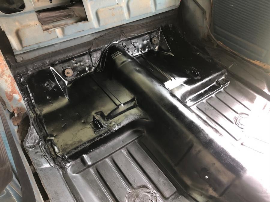

The plan for the weekend is cleaning up the interior floors and firewall. There is a Vintage Air order inbound
