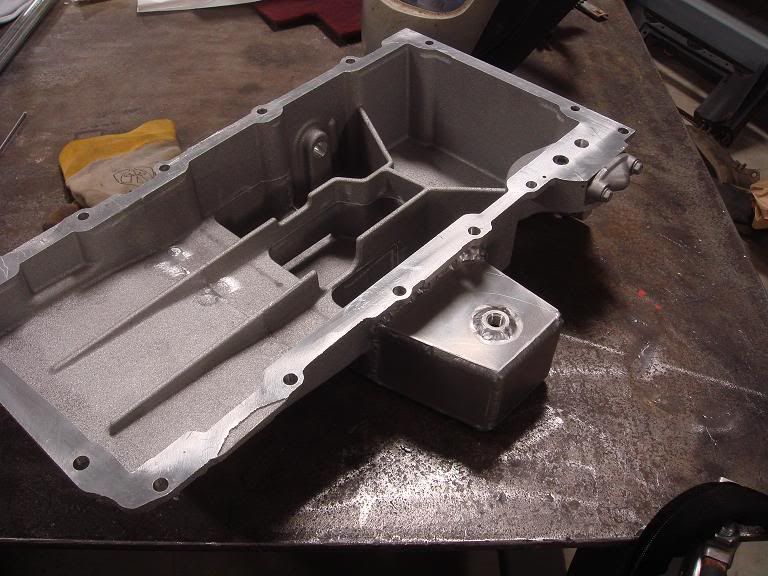

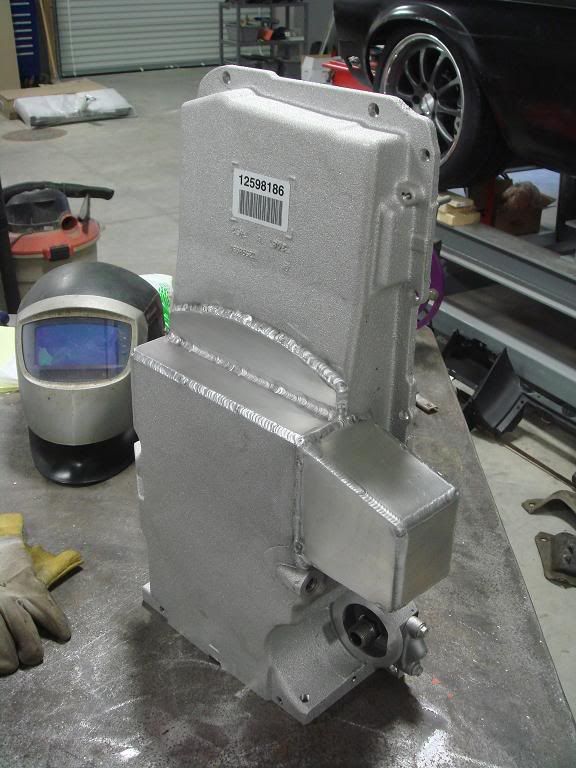

I haven't updated in awhile, been busy with a bunch of small things. Here are a couple of pics of what I did this past week. Made a mount for my battery mount and modified the LS3 oil pan to clear the DSE subframe. Then I added a kickout to replace the volume I removed from the front and added a little extra capacity. I also added in a bung for an oil temp sender.

WOW!!
Good work Billy. Keep it up.

looks awesome!

Oh to be able to TIG aluminum...I'm envious. Nice job!

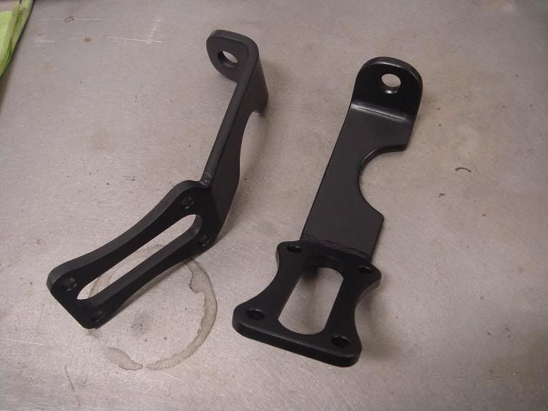

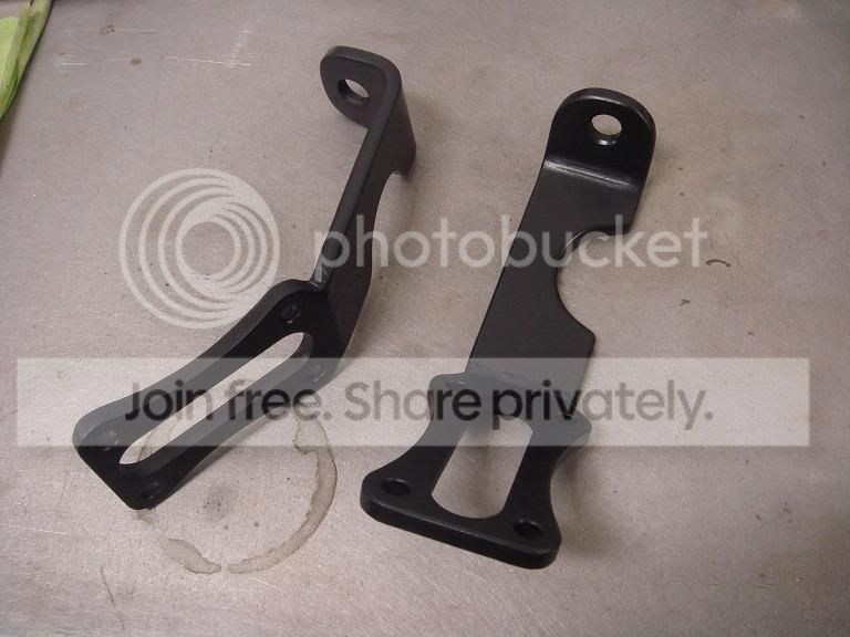

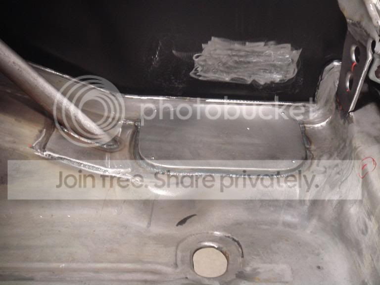

I got the rear brakes and parking brake cable brackets under control tonight.

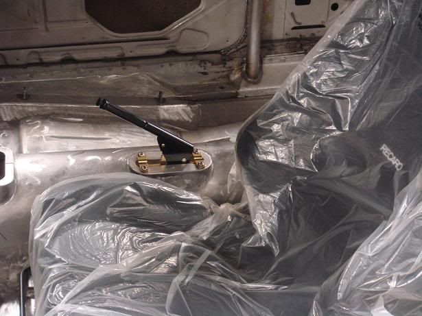

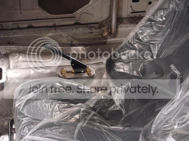

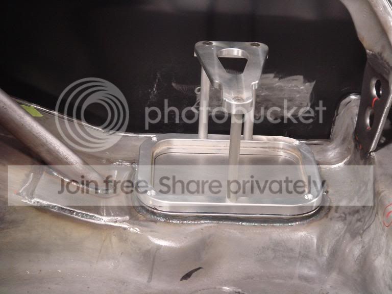

I recieved the e brake handle from Lokar today. Just finished making a mount for it in the tunnel. Heres a pic!
