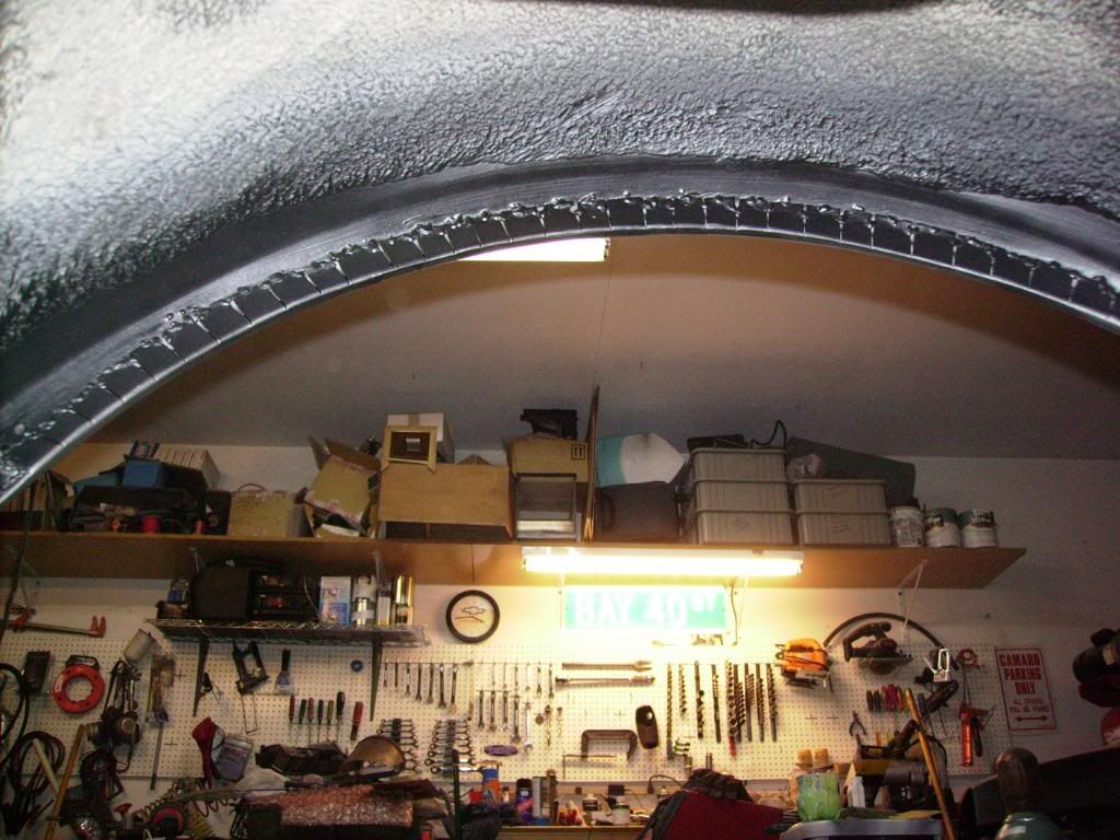

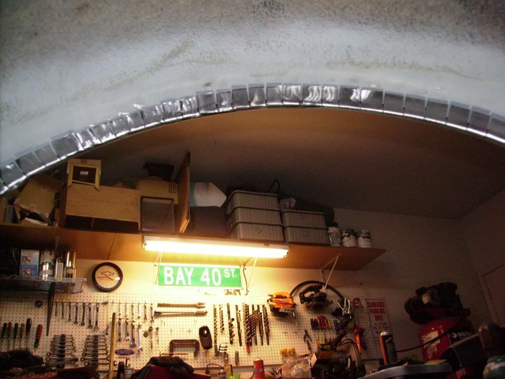

Making a little progress. I decided to cut away the inner edge of the outer wheel houses so that I could cut and tuck the rear quarters in a bit (I did that before I set the quarters on). I'm hoping to stuff some 285's back there.
I started by laying down some thin masking tape to mark a straight line.
Then I cut straight lines with my airsaw every inch or so.
I was able to bend each section by hand and follow up with just a little hammering to get the edge to sit flat.
I then spot welded.
Cleaned up with some sanding discs and sprayed a light coat of Zero Rust.

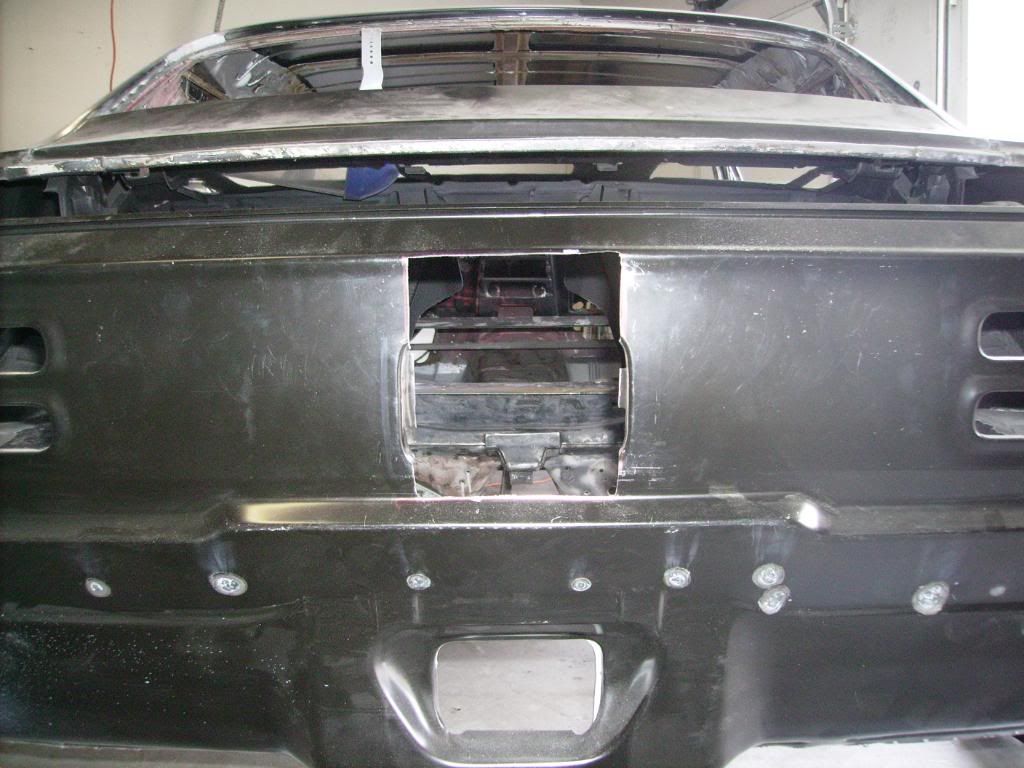

A little further: Thinking I could fit a 33X12.50X15 tire there
Just kidding
Here's the 67 Camaro section I spliced into my tail panel; Thanks again to ItDoRun for the panel section and Scherp69 for the idea I think I inhaled some paint fumes that day because I kind of messed up the cut. Oh well, it's a learning process, right?
I did add more weld to fill the gaps after this shot, just can't find the picture.
I also started cleaning up the underside and prepping for epoxy primer, then Raptor liner. Pics on that soon.

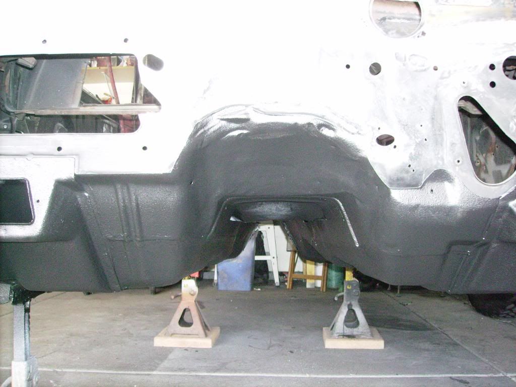

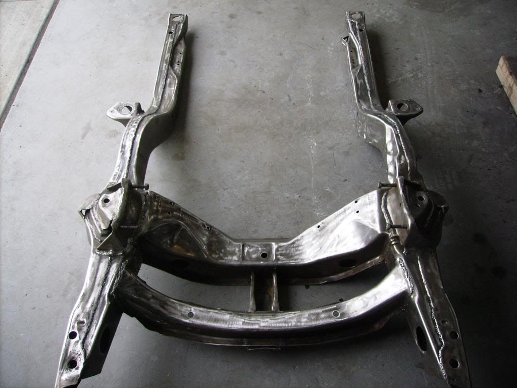

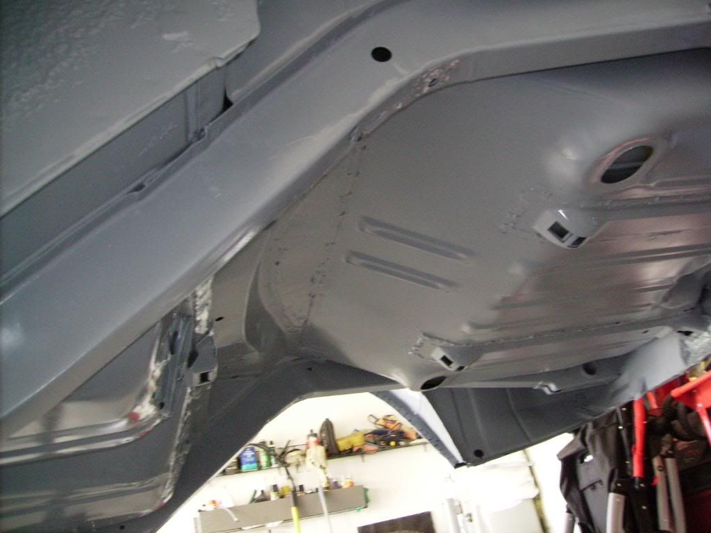

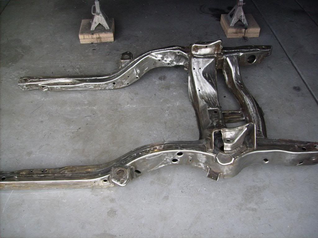

Some updates. I finished cleaning up the underside. I used Dupont epoxy primer and followed up with Raptor truck bed liner. I also got the sub-frame apart, cleaned up, and all seams welded solid. It's at the powdercoaters right now, I should be getting it back today. Here are the pics.....
