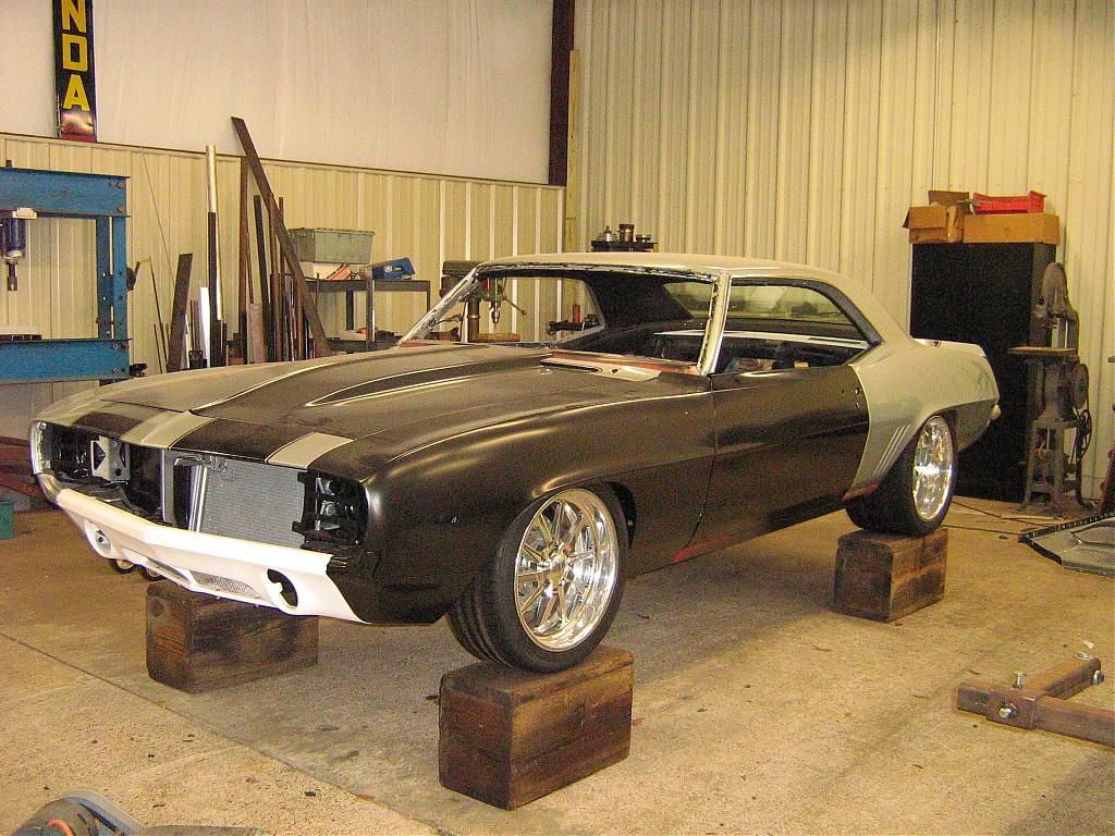

Got mine mounted, Drilled out the spot welds on my original valnce and put the center bracket on the new piece. Like the look!

Hey Roy, that's a great idea! How did you attach the bracket to the new valance, epoxy or glass? Looks like a great project, I was also wondering what wheels are those...

Great looking car. Like the gasser wheels and good Idea with the bracket, I would do it but the part I took off was original sheet metal. I am not a chalk marker, but I have a hard time cutting up original 69 sheet metal. I will hord it up in the attic

Great idea...wish that I would have thought of it before I cut the attachment point off of my support brace.
I'll try to post up some pics of the bracket that I fab'd to accomplish the same thing. It turned out ok, but it doesn't look as clean as your idea.

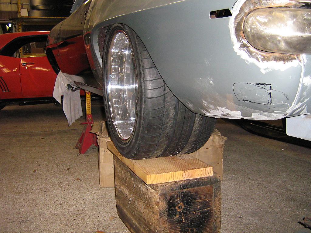

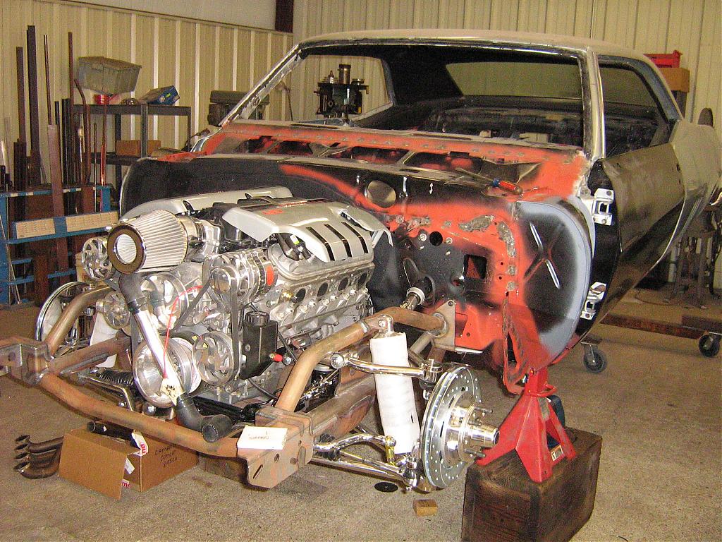

We drilled the spot welds and then mixed epoxy, drilled and rivoted the brack in a bed of epoxy. When dry just sanded off the aluminum rivots. The wheel are Gasser D's, 18x12 in back. The pic of the car at the bottom is how I got this car before I began saving it!

Thanks for the 411. Nice work too!
