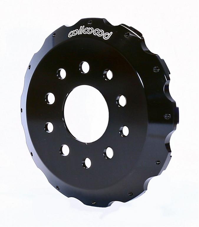

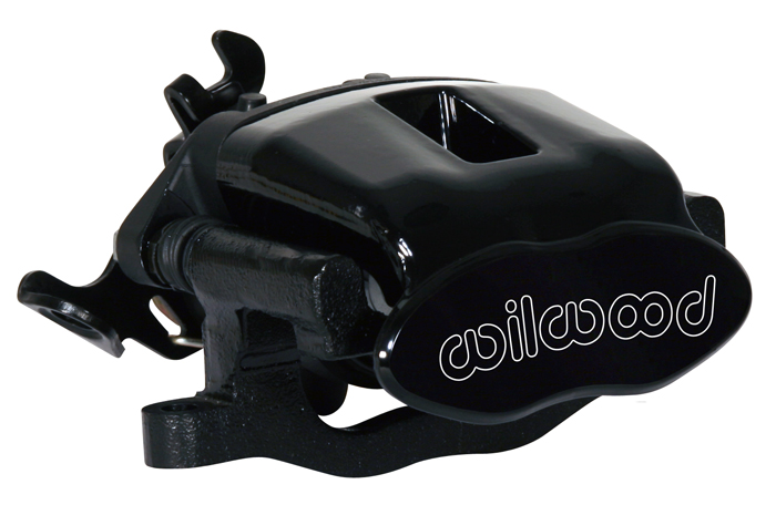

I adapted these to work on my car, it’s not a kit but just some parts that I made work, I had to make my own brackets, knockback is gone and the car stops amazingly well.
RSK68

Rick, thanks for sharing your idea. I'm just not sold on a smaller rear caliper as hard as we run these cars.

Todd I agree with you but this did eliminate the problem and overall my brake performance is way better then when i had the 4 piston rears, another problem with this small calliper is they dont make an aggresive pad for it.
I will continue to work on another setup involving a 6 piston caliper that i can convert to a floater, more like a floating bracket.
