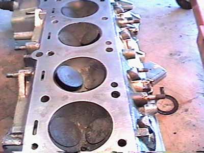

Its a 2 litre displacement, with 9.7 to 1 compression ratio
I will get pics with the cover off soon, the valve clearences are adjusted with buttons of different thicknesses.
It redlines at 7500 rpm , and it should have at least 180 hp.
I ported and polished the head and installed bigger valves.
I am using dual 40mm Dellorto carbs
I had to get the valve buttons from australia, and modified the head to use harley davidson valve seals.
this motor was never offered to north america, and it was what Toyota built there twin cam reputation from.
Here is a pic of the "HEMI" head design

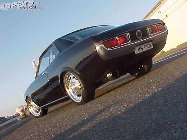

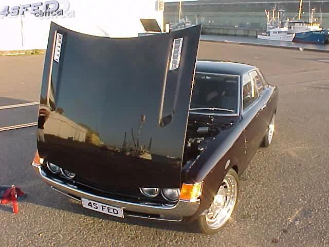

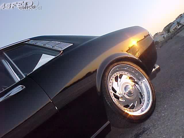

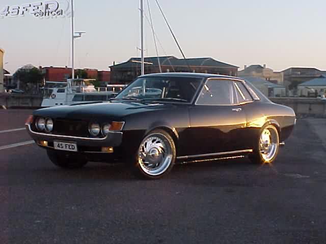

here is some pics of a nice one...
mine will be a fair bit wider, and im thinking the front fenders and hood as a one piece flip up front end
