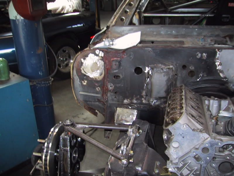

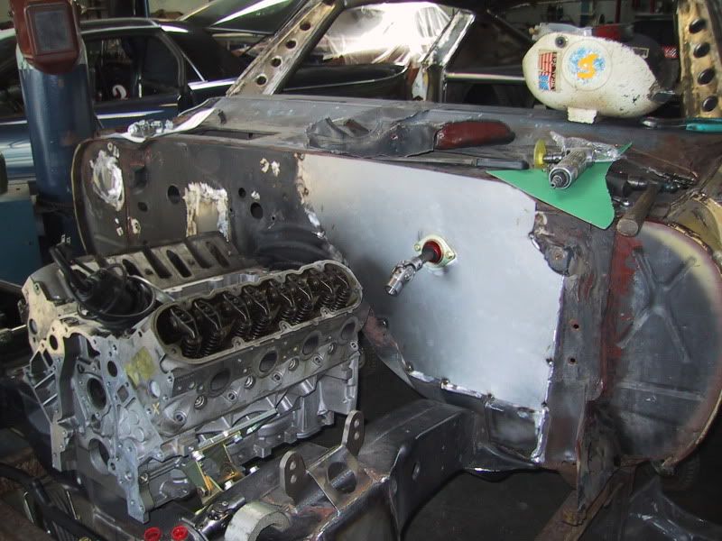

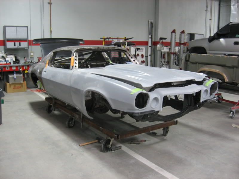

Here are a couple shots of the firewall. It will get smoothed off and insulated with Lizard Skin later.

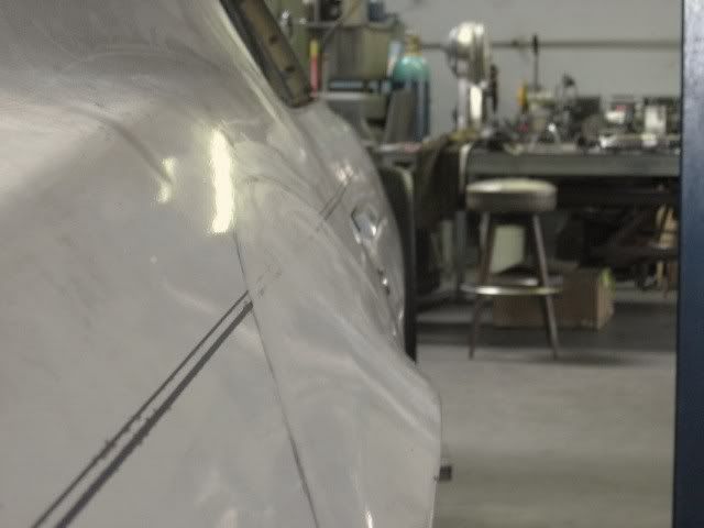

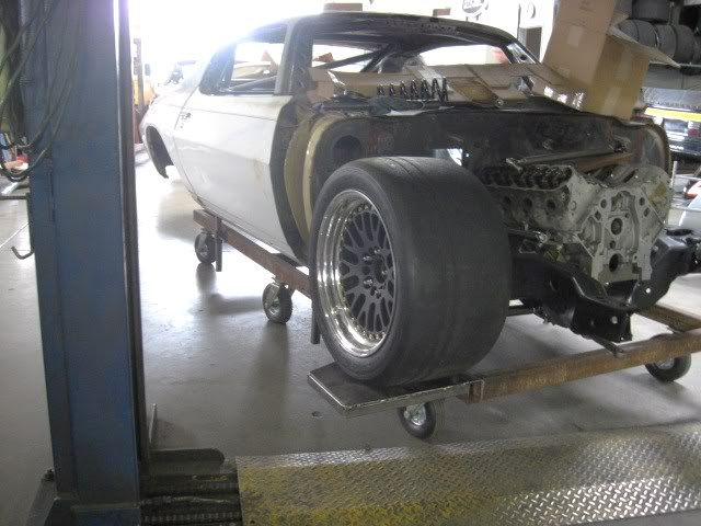

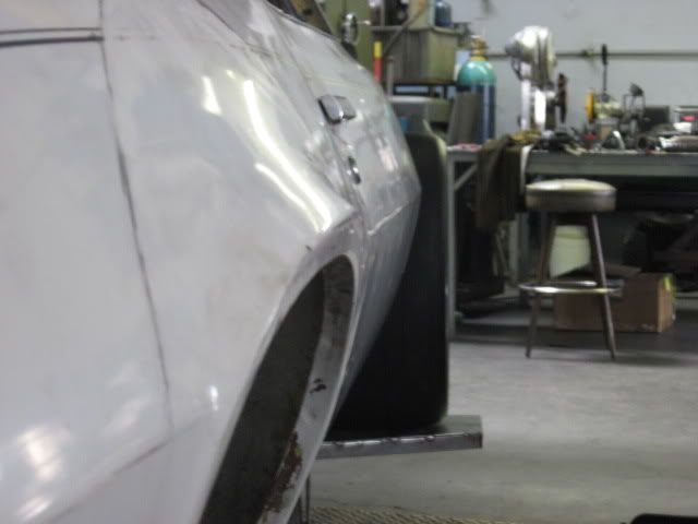

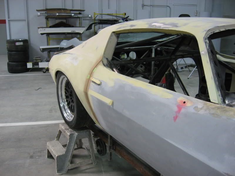

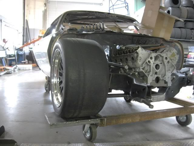

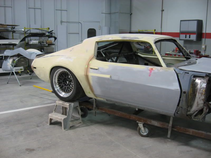

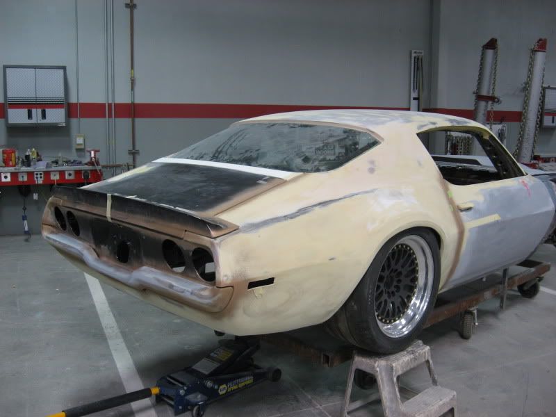

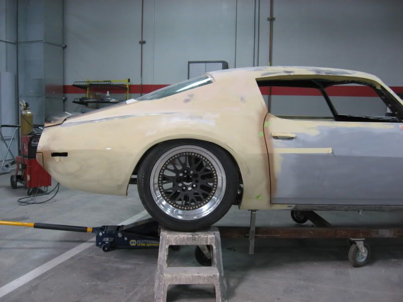

Here are some photos with the front wheels/tires. The wheel / tire combo will be 18" x 12" rear wheels with 345-35-18 DOT race tires. The fronts are 17" x 12" with 335-35-17 DOT race tires. Either Hoosier A6 or Kuhmo 710's will be used. The wheels are CCW. Our goal was is to get as much tire on the ground as possible and not have a wide car. In the end, we should not need to flare the fenders or quarter panels out much, if at all. We will need to go up with some body work for clearance. The final product will try to keep the original shape of the car as much as possible.

Posts: 3,683
That is a serious amount of tire up front. Wow! The rears on my 70 are smaller than those! I will be running 315-18s out back.
