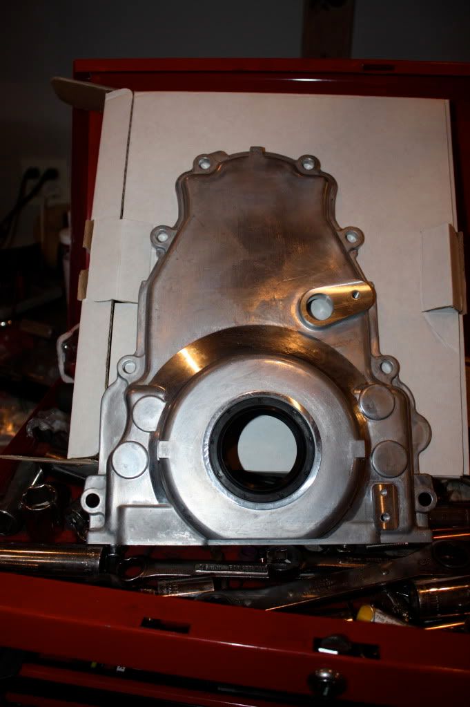

Got a nice update for today.
Here are some pics of everything I have been collecting over the last few weeks.

Timing Cover:
