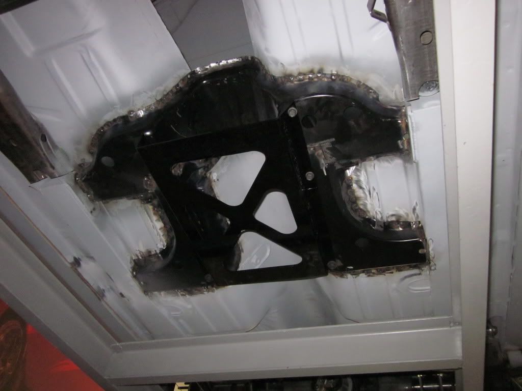

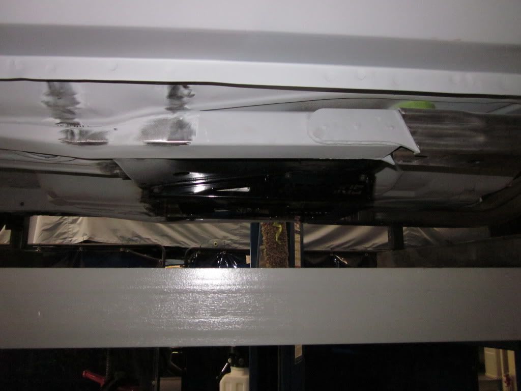

Here is a pic of a stock floor with no sub-connectors.. one of the weakness of a first gen Camaro is that the center of the floor has no bracing to really help body flex.. They corrected this problem on the 2nd gens..
Here is something that I am doing to help add stiffness to the center of the car.. This 68 already had DSE sub-frame connectors on it when it arrived @ the shop... so I added a convertible OE factory center stiffening brace that goes from rocker to rocker tied in to the sub-frame connector & a Hotckis bolt on brace.. We still need to finish adding the pcs to the sub-frame connector to rocker.. but I think you guys get the idea.. when done it should give it a triangulated effect on the center of the floor.. I remember this feature on convertibles from my days of restoring first gen Camaros..

Cris --
Ya shoulda been a GM engineer!
First thing I thought when I looked at your work --- "oh -- He used a drop top X member".... I've had a couple of those... so they're real familiar!
Nice work as usual!

This is what you used Cris?
http://www.hotchkis.net/6769_camarof...e_support.html

Correct.. I bought the reproduction bracing from National parts Depot.. it is stamped out of 14 gage.. i will help alot on adding strength to center floor section.. IMO!!

These mods are also part of your trailer towing package, right?

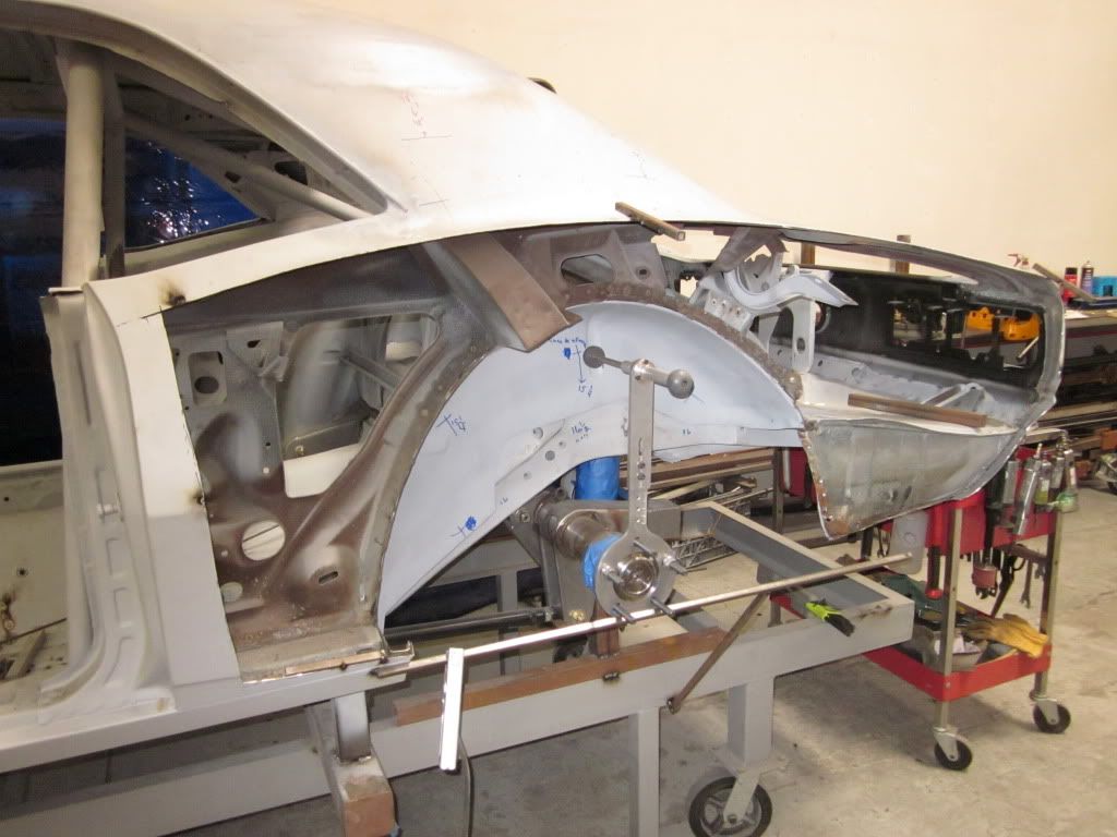

Default Started the qtr Stretch!
Taking a different approach to the rear qtr stretch..

Any Updates? I'd really like to see how your qtr. strech is coming along.

Got us all worked up and then cut us off. What a pic tease!
