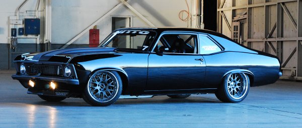

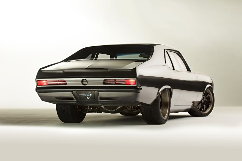

I love this car! I spent 25 minutes marveling at it and all they did in 3 months on Friday and then did the same again today. Way to go, Blake!

Roger- Blake the Nova turned out Great Looks Killer!!!

i guess the BS stops here, just on our way to ElToro to shake it out
glad you guys like the look and yea like jason said i put this car together with Garys help on the wiring,exhaust, and rollcage in 3 months after hours and week ends, i think i still have a house to return to next week after a week lonf tour of california

You clear the front fenders okay Blake? Did you end up 1.5 negative?

no issues, other than completly removing the outer lip, and "custom trimming the inners,
we ended up using 2 deg neg camber, 3/16 toe out, and 4.5 deg caster and it drive beautifully, unloaded it from the trailer in Redding CA and drove it 250 or so miles to Pleasenton for the goodguys show. on the freeway "the I620" worst peice of road i have ever driven on. the car is wicked.

Very nice Blake. That car looks killer.
I bet it did well out there.
