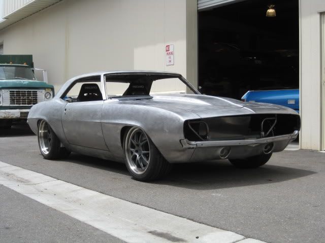

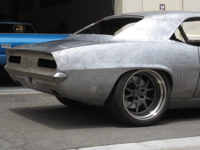

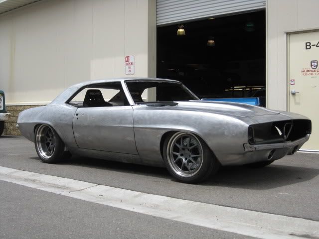

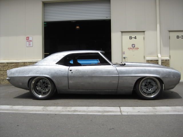

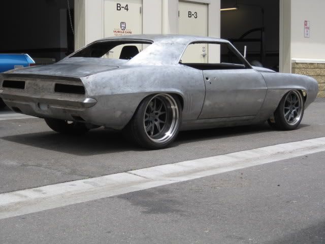

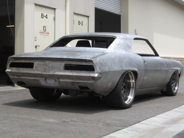

We also got our Forgeline wheels 20x12 and 19x10, brushed nickel outer and titanium center, rolled it outside to get an overall view of car and map out front spoiler fabrication
This shows how quarters were dropped down to transition into dropped rockers smoothly......
We will be extending the doors downwards 2" to be in better proportion to rocker as well.

That is bad a**. 19s and 20s look great and I love the fatter dimension with the lowered rockers/fender trasition...

Wow Steve Wow... that just looks how it's supposed to look. So Killer! What's the ground clearance measurement?

Dave, we set the ground clearance at 4.5" to the rocker. That is the lowest point of car.
