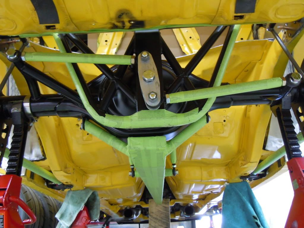

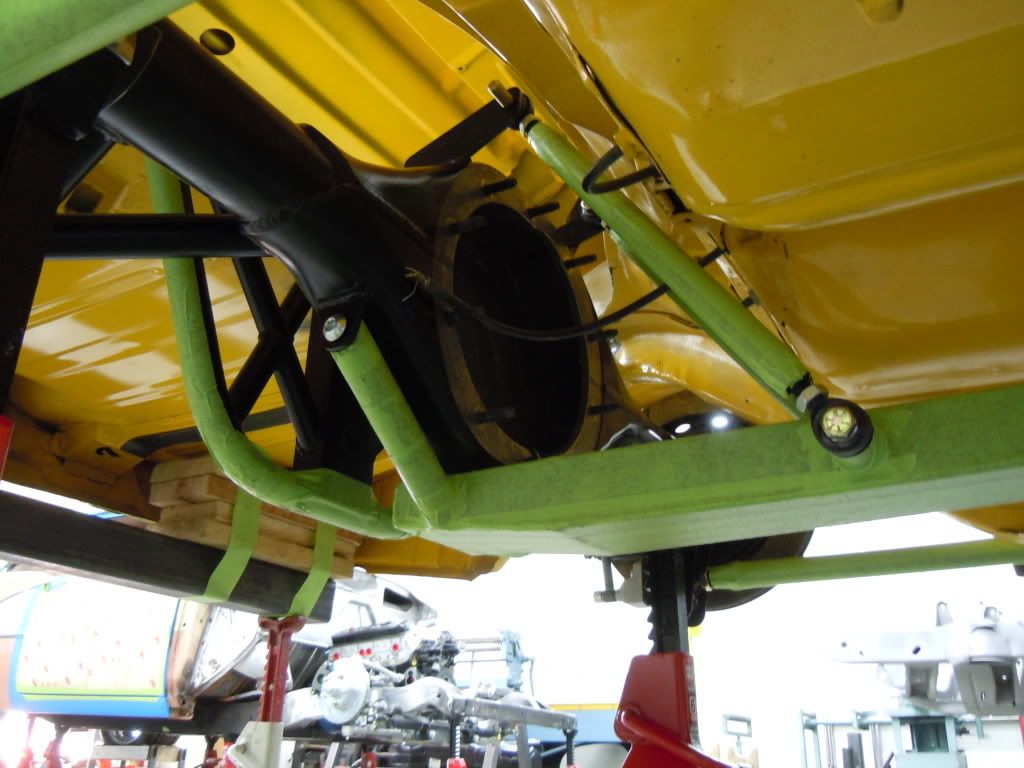

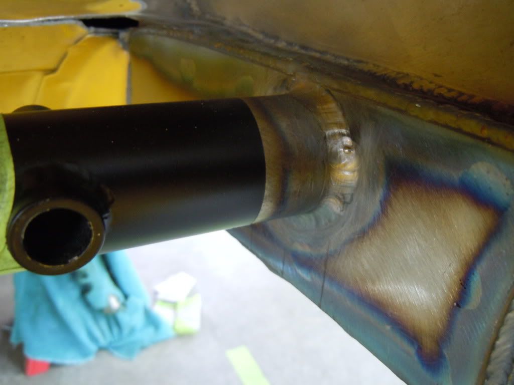

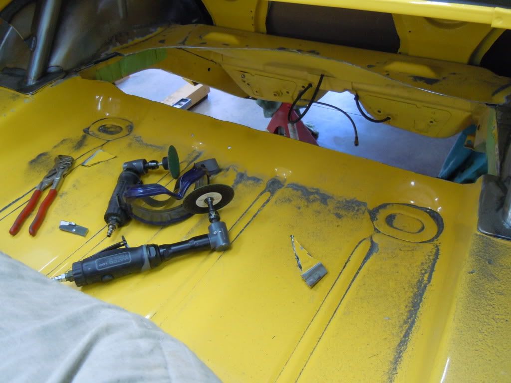

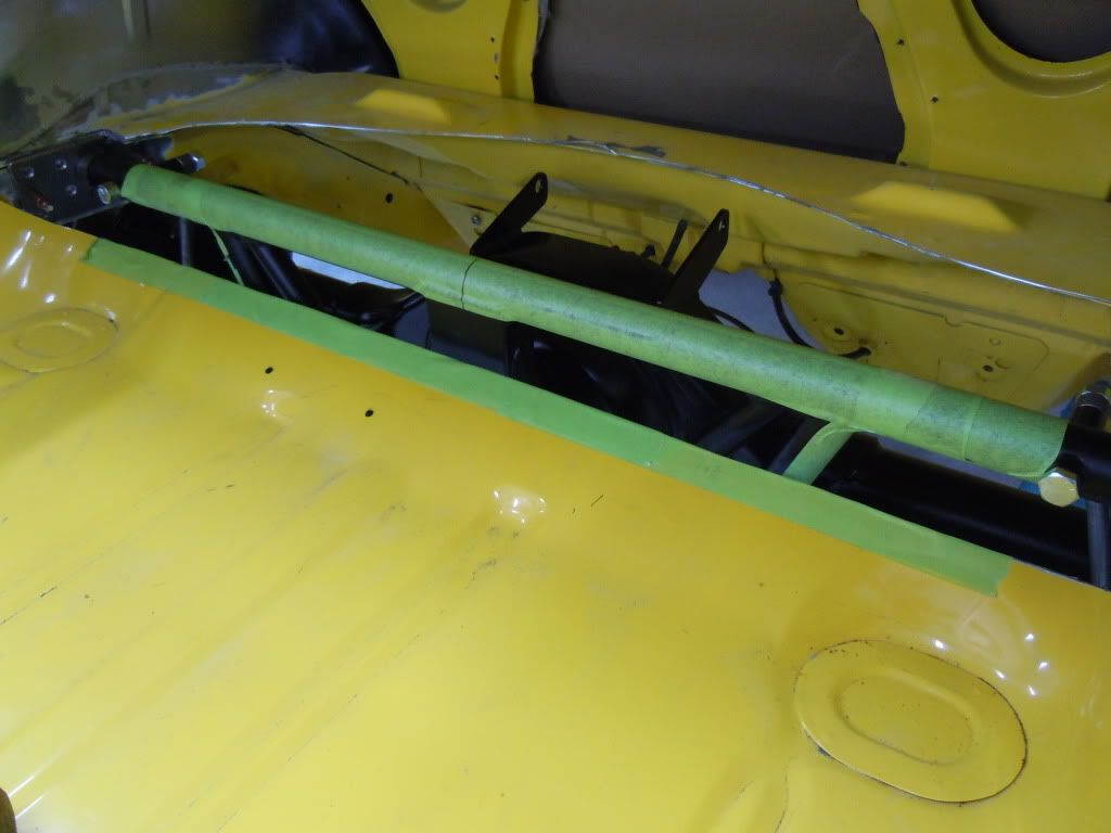

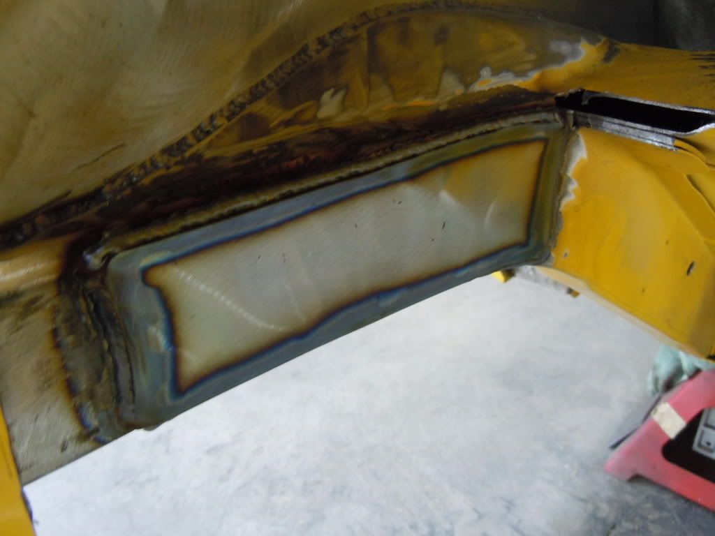

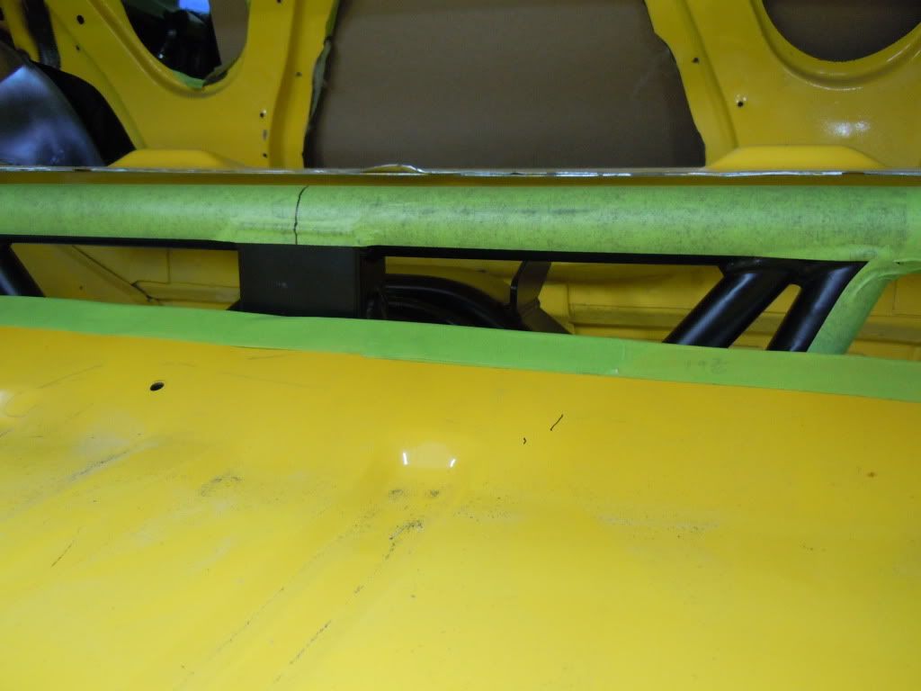

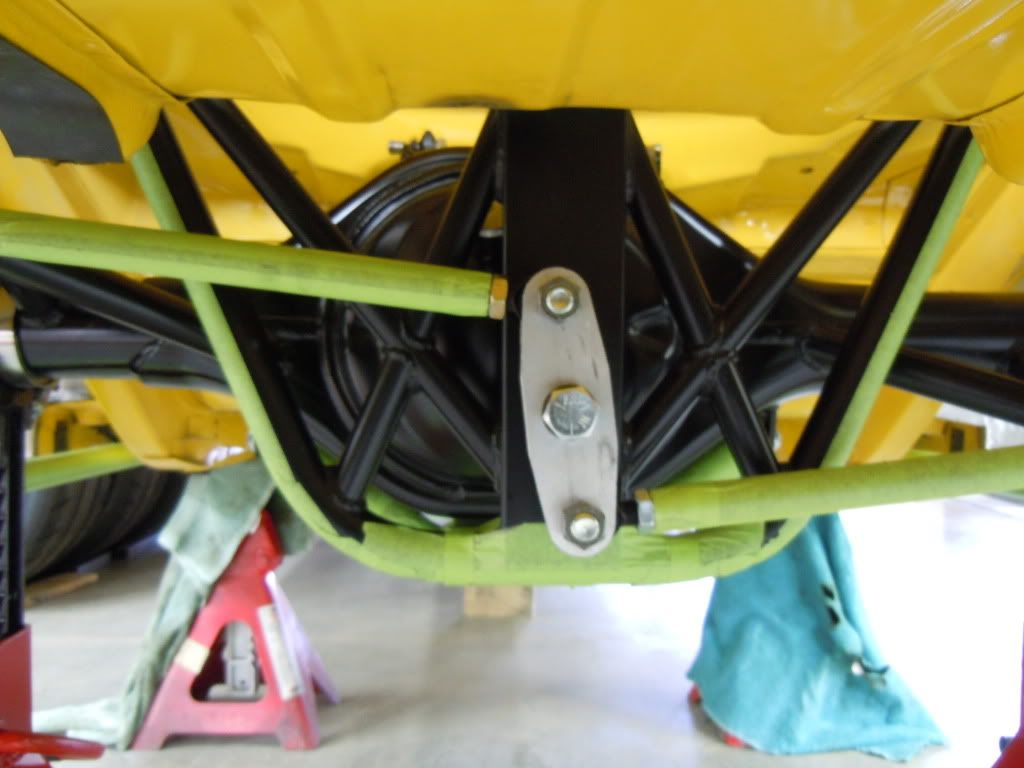

Here is a lesson I have learned more than a few times over the course of owning this car for 18 years...nothing ever goes on the way it is supposed to fit. Jake's Torque Arm is designed to fit under a stock trunk pan and be a very easy and non-invasive install, one of the many reasons I went with his system. Not on my car, running a drop version of the 21st Century subfame and half height DSE bushings, my car is lower than most. When we positioned the rear end housing where it needed to be located in the car at ride height and using the ride height length of the shocks...we were in the trunk a couple of inches with the watts/shock mount. Great, break out the cutting wheel.
  #44
Old 06-30-2011, 08:36 AM
With that talent they will make short work out of it.

Sounds like you're sinking the set up pretty deep in the car. I'd look for tunnel/pinion clearance issues with your pinion angle set and at fulll bump.

IMG]http://i1138.photobucket.com/albums/n539/paytonking/DSCN1813.jpg[/IMG]

Thanked 23 Times in 18 Posts
Default more
Default Again

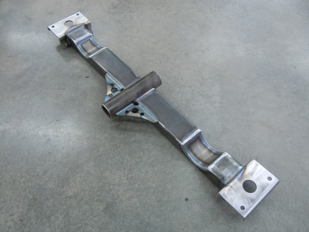

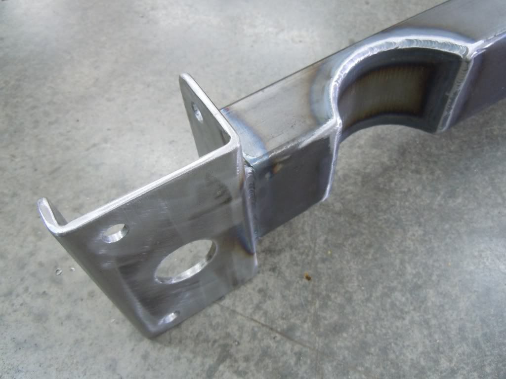

Default contintue

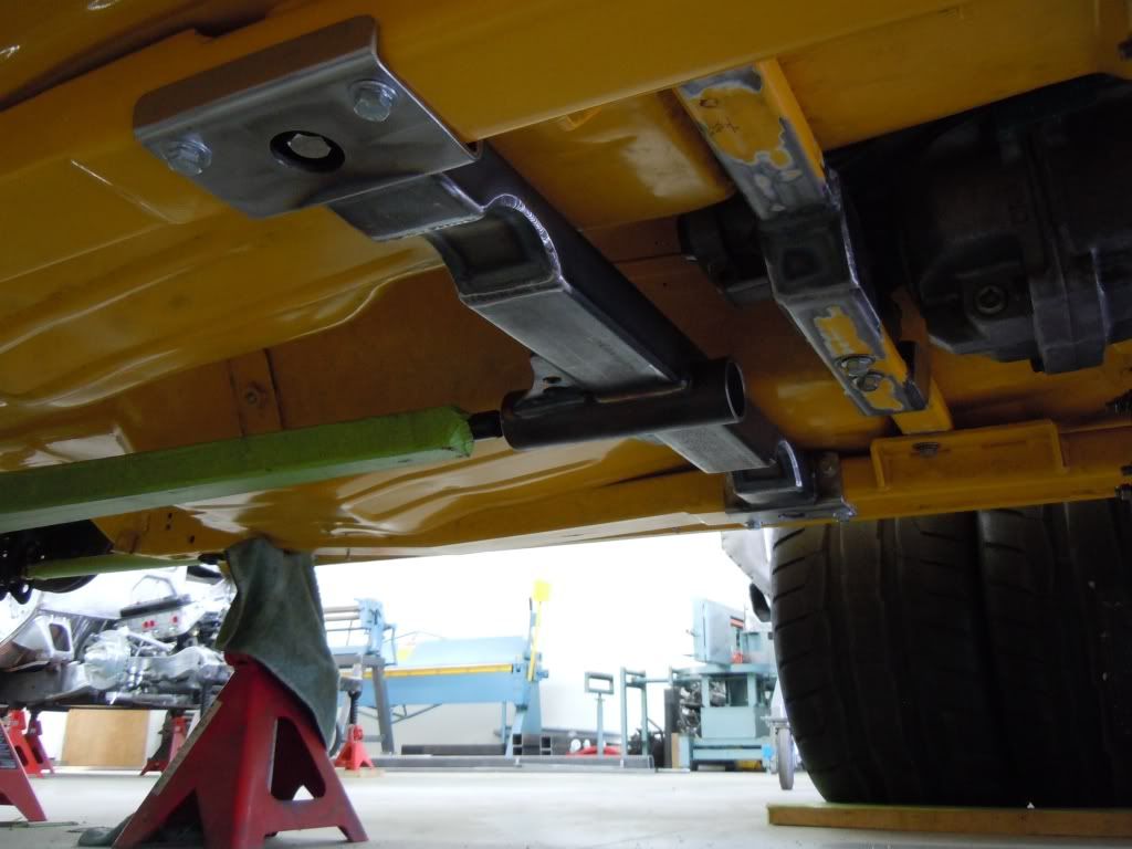

And of course the cross member that comes with the kit will not work on my car, so Dan to the rescue
