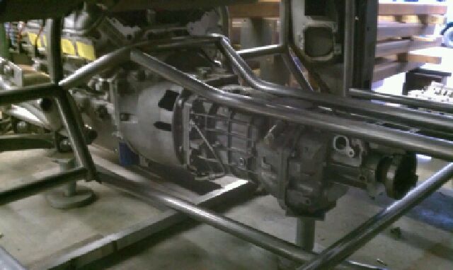

I appreciate it! Keep the pics coming. So how much longer do you think you have in the project?
Not sure how long. Its like remodeling your bathroom. The more you do the more you want to do

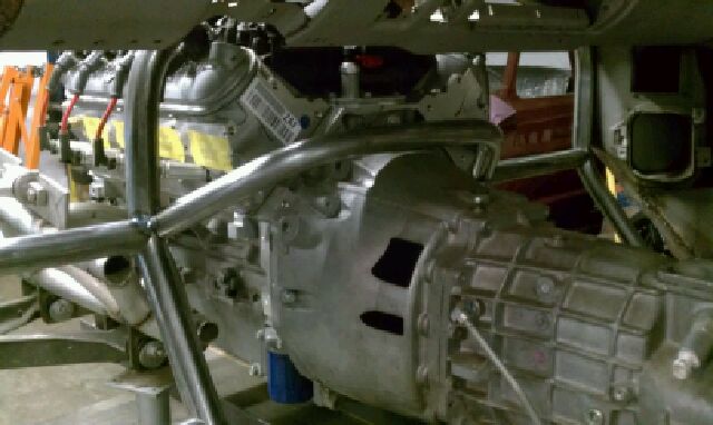

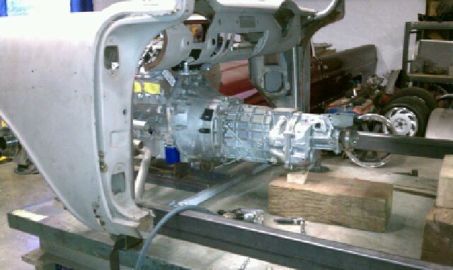

Here's a couple more shots of the motor and trans. Motor is set at zero degrees (level) with 1.5 degree driveshaft angle, which is as good as it gets. Pinion angle is zero so the offset makes for a vibration free driveshaft....

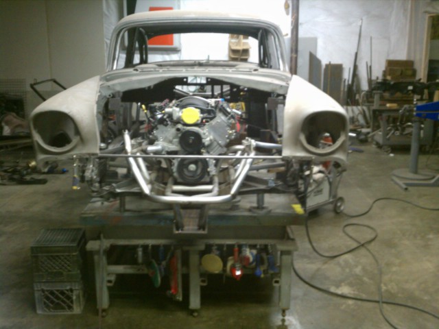

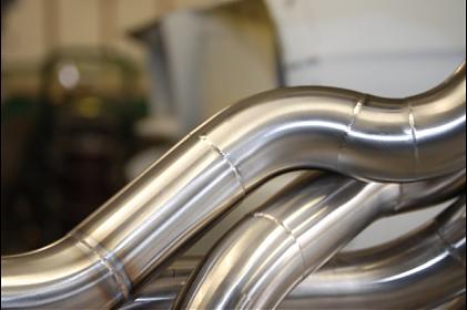

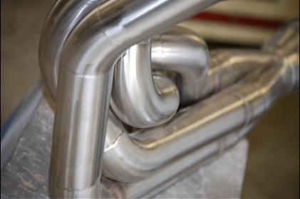

And a little up close look at a set of headers he finished...

Wow...those are some clean looking headers.
Such a cool build.

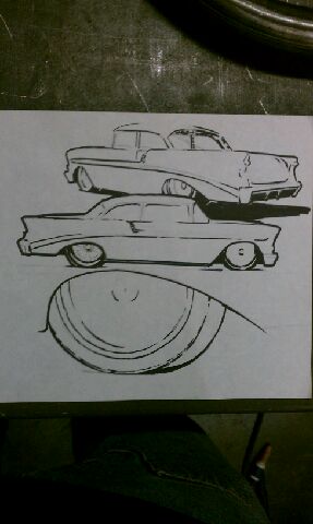

Nice. My rendering isn't quite done yet. No computer stuff here, just done by hand...
Was thinking about calling the car Pandora's Box! What ya think??
Doug,
You da check writer, so whatever you like.

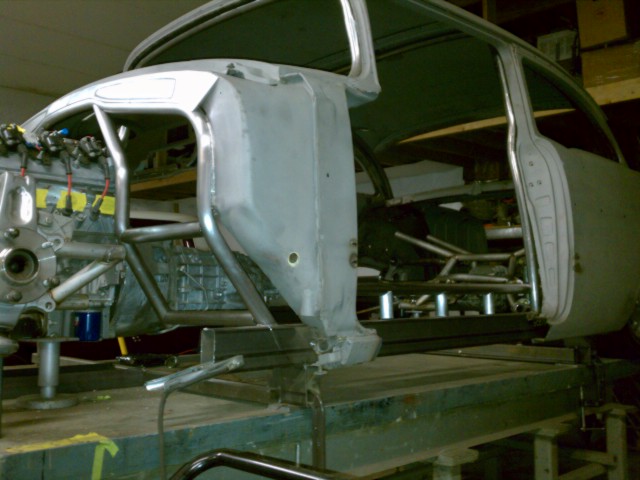

Just a little update. Finished the bars for the mid plate. Started floor bars and trans mounts. And dedicated a little time to stamping the firewall. And a bit of the tunnel is taking shape.

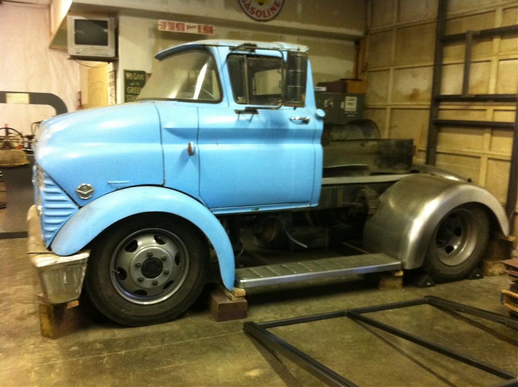

And of course the "Shop Truck"

56 is coming together real nice! Shop truck looks pretty slick. What's the plan with that!?

The shop truck is awesome!

Build thread on the shop truck ....?
Well thats Mikes personal rig. And you know how those projects go. To the back of the priority list. However, Ill post some pics of the running boards he punched out. They're pretty slick.
It used to be a hay truck, now hes got a new 400SB and turbo 400 sitting around. Its one of those projects that is always being worked on, but just a little at a time. The plan is to sand back the paint for the proper patina and paint the shop logo in the door...
