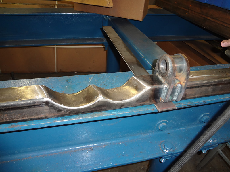

Got the torque arm crossmember fabbed, the exhaust eyebrows were a pain but turned out pretty good.

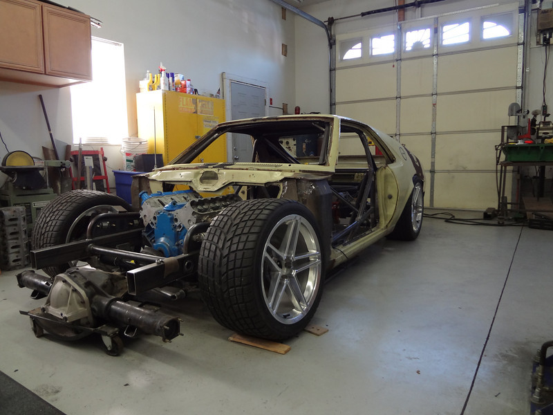

Been so busy working on my Mustang to get it ready for RTTS, that I haven't looked at this poor thing. I did finally get the 335's on the front, I'm loving the look.
