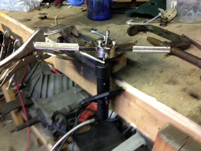

Got the clutch master hooked up. I took a slightly different approach. I shortened the rod on both sides, then drilled into the fat end and ran a tap into it. Then ran a Die over the small end. this gives me about .5 to 1 inch adjustment.

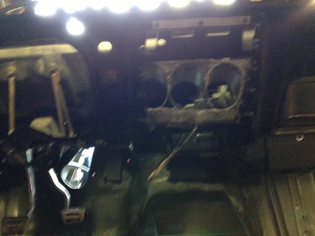

started on my gauge panel.. too some 3" exhaust pipe slash cut them @45 degrees this is a rough in it will be much better fitted into the dash before its done. hoping for a factory look when its done.

Default Guages in
working my way through Dash Moc up.

Old 07-27-2013, 06:14 PM
The gauge cluster looks Great! The battery install looks good too.
