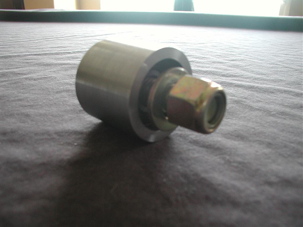

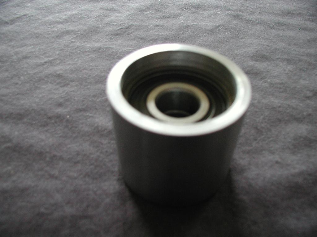

got a little progress today. Had some "surprise" work travel to NorCal right after I got back from DC area, then my mom drove into town last weekend, so it has been hectic again lately, but I did get some progress today - I worked with the machinist at my job to machine up the first of four bearing carriages to make my suspension rocker arms to move the shocks/coils inboard. We had to lathe out the center and then cut an internal groove for the spiral locks and he did an awesome job.
Now I need to see if I can make the pieces for the rocker and weld them on without distorting the hell out of the little housing. He has the bore tight to just over .001" which is way better than I could have done, but leaves me little room for overheating while welding.
It is hard to see but I have two bearings in there so they can react any moment trying to twist the arm and force it to only pivot about the bolt. He is going to make the other three housings tomorrow and then next week I hope to get in there and lathe up some 1/2" spacers for the bolt.
The nice thing will be that I can build a ratio into the rocker arm that matches the ratio at my lower A arm between the shock and wheel center - that will mean I should have a 1:1 wheel rate and therefore a 1:1 motion ratio. That is nice because I was buying really stiff springs for the 914 trying to get a good wheel rate, now whatever I want at the wheel will be exactly what the spring rate is, no motion ratio math to mess with.

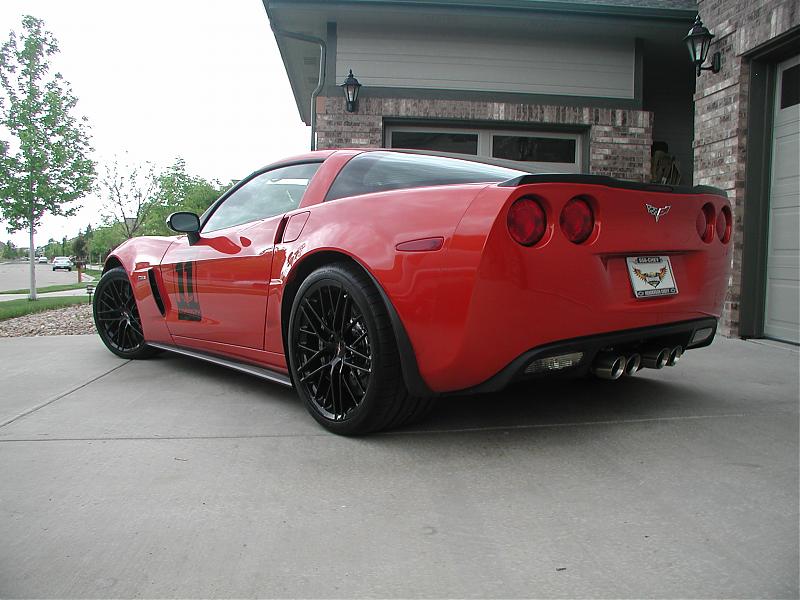

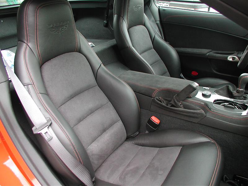

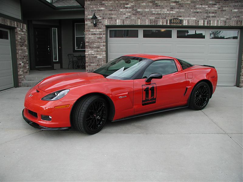

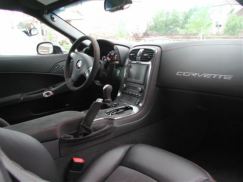

Fortunately, the second deal also fell thru when the seller couldn't come up with enough money to pay his loan down - that got me looking and I found the car that I coveted most in Vegas - right where I was delivering the 914!!
2011 Carbon Edition Inferno Orange, only had 989 miles on it when I bought it Friday! I have wanted one of these so bad since I first saw it displayed in the GM booth at SEMA and sat in it, so fortunately the other two deals fell apart!! Great how that works out at times.
Now I can work on getting Vette suspension into the Nova and set it up so I can have a set of track wheels that would fit both cars and I can just swap back and forth.

Mmmm beer errrr suede!
I upgraded to the 2012 seats in my C6 - and love it!
Great looking C6 Carbon!
