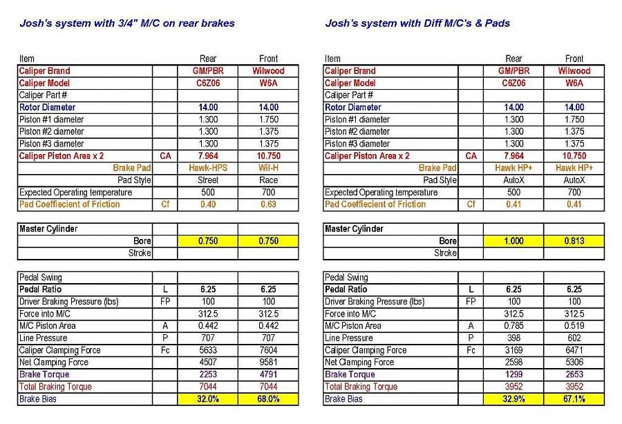

Josh (Banko) has an award from Wilwood, so he's upgrading his brakes. Josh is the one that started this thread because his car is not braking strong enough. He PM'd me the system he's considering.
Brake piston sizes
Front: W6A (1.75,1.38,1.38)
Rear: C6Zo6 (1.3,1.3,1.3)
Rotor diameters
Front: 14"
Rear: 14"
pedal ratio
6.25:1
Master cylinder bores
Front: 0.75"
Rear: 0.75" or 0.875"
Brake pad brand & compound name
Front: PolyMatrix H
Rear: Hawk HPS
I ran the calcs on this system ... an whoa Baby ... it swings the pendulum too far the other way. In the chart below, this is the system on the left. Look down at the total braking force #. It would have 7000# of braking force, which would simply lock the wheels up upon braking.
Now look at the chart on the right. By changing the pad compounds & the M/C sizes, we adjust the total braking force to about 4000#. That is a strong braking system.
Did you guys ever watch the Lassie TV show?
If you did, you remember the Dad always sat down with Timmy at the end of the show to explain the moral of their lesson. This was a planned in moment every show. The writers called it the "Ya know Timmy ..." part of the story.
Well ... Ya know Timmy ...
The lesson here is when building your braking system working out the details is just as important as buying great parts.

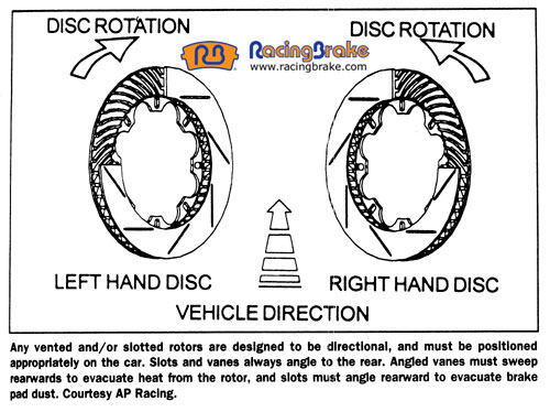

Cooling: is not achieved with slots or drilled holes. There are three ways to cool rotors: Vanes inside the rotor, air ducting, with or without fans, to blow cooler air on the rotor, and the Ultra Cool brake fans that mount on the hub. See them HERE.
Important: I learned long ago, if we cool the rotor optimally, we can run a little less mass in the rotor ... so it's lighter. For this advantage ... I make cooling the rotors a serious priority. I don’t want to provide the rotors “a little cooling” … I want to provide “as much cooling as practically possible” so we can run lighter rotors & reduce that rotating mass.
Vanes: Are the most important cooling feature of the rotor itself. The vanes of the rotor … spinning on the hub axis … create a vortex, sucking air into & through the rotor’s vanes … helping to cool the rotor. These are simply referred to as vaned rotors & they come in a lot of configurations. The details matter here. The air travels from inside the rotor to the outside, not the other way around as is commonly thought. So the vanes must face rearward when viewed from the outer diameter of the rotor.
Straight vanes do not work as well as curved vanes. There are made & sold as an economy product, because they can go on either side & the parts store doesn’t need to stock left & ride side rotors.
Curved vanes
are the way to go. Just think of fan blade design. The vanes scoop the air from inside the rotor … suck it through the inside of the rotor … cooling both sides … and out the top.
More curved vanes provide more cooling … and add mass (weight) to increase the rotor’s thermal capacity. This is my preference instead of adding diameter. If we can get a 12” rotor with 48 vanes that weighs around 11# … that would be my preference over a 13” rotor with 32-36 vanes that also weighs around 11# … because the thermal capacity is the same, the 48 vanes cool better & the 12” rotor has the mass closer into the center, so it’s easier to accelerate & decelerate it.
The only advantage the 13” rotor offered (besides cool looks inside the big wheel) is 10% more braking force. But I can get that 10% braking force four other ways (pad, pedal, piston size & M/C size) … and not have the disadvantage of that weight rotating so far out there. A .05 CoF change in brake pad compound can achieve that.
Note: The vaned rotor is shooting hot air onto the inside of the wheel surface. This is where some of the tire’s heat comes from. If the brakes are overheating, this may over heat the tires too. (Seen it MANY times). Another reason to cool the brakes better.

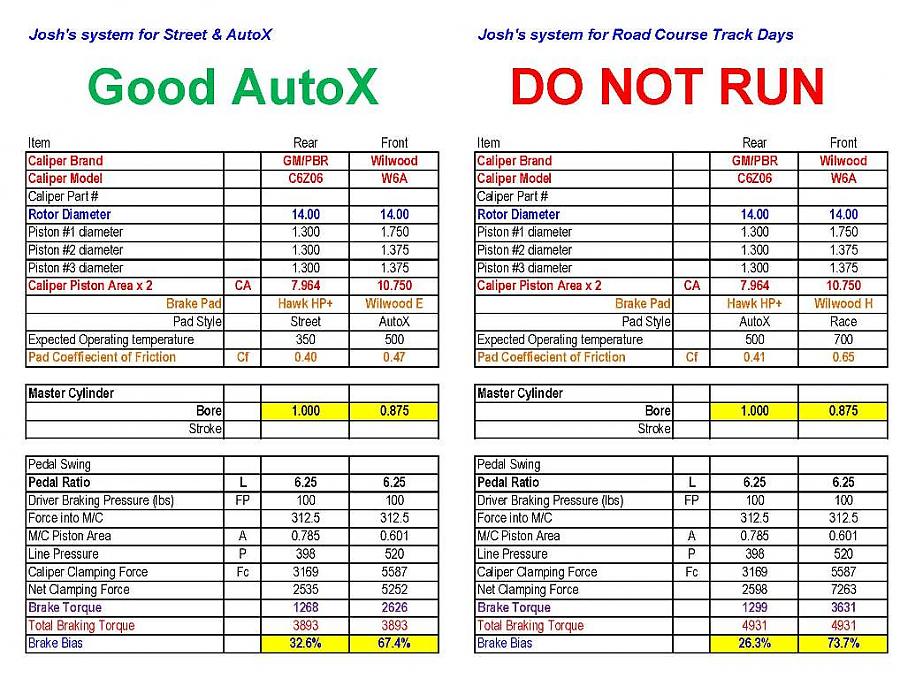

Ron, thanks so much for running the numbers, I appreciate you showing me that every little detail matters in the system.
If I have a goal of running Wilwood J or H on the track and E's on the Auto-x / street can I do the following: 0.875" bore on the front, 0.875" bore on the rear dropping the line pressure via my existing proportioning valve to what a 1.0" bore would provide?
I'm running the Wilwood high volume master cylinders that run in (0.75", 0.875", and 1.0" bores, no 13/16" available). I have a duplicate set of 0.875" bore master cylinders and would like to put them to use instead of buying another new MC.
So the system would be:
Scenario 1: Street / Auto-x
Brake piston sizes (all)
Rotor diameters
Front: 14"
Rear: 14"
pedal ratio
6.25:1
Front: 0.875"
Rear: 1.0" (via 0.875" MC + proportioning valve)
Front: PolyMatrix E
Rear: Hawk HP+
Scenario 2: Track Only
Rotor diameters
Front: 14"
Rear: 14"
pedal ratio
6.25:1
Front: 0.875"
Front: PolyMatrix J or H
Rear: Hawk HP+
Josh
Designing a '65 Chevelle with a StreetFighter theme, inspired by JP's II Much & Ron Schwarz's $5k Mustang
  #48
Old 07-29-2013, 07:17 PM
Ron Sutton's Avatar
Ron Sutton Ron Sutton is offline
Join Date: May 2013
Location: Folsom, CA
Posts: 2,422
Thanks: 45
Thanked 35 Times in 26 Posts
Rotor diameters
Front: 14"
Rear: 14"
pedal ratio
6.25:1
Front: 0.875"
Front: PolyMatrix E
Rear: Hawk HP+
Rotor diameters
Front: 14"
Rear: 14"
pedal ratio
6.25:1
Front: 0.875"
Rear: Hawk HP+
Hey Josh,
The proposed packages you laid out work for the street & AutoX events ... if you put a 1" M/C on the rear. Do not run a .875 M/C on the rear even with a PV.
You end up with a LOT of braking force ... total = 3893# ... with a natural 67.4% front & 32.6% rear bias ... that can be fine tuned with the Wilwood pedal system you have.
For the road course track days, the combo you proposed does not work ... but I showed it anyway ... obvious by the big red letters.
With almost 5000# of braking force, you would just lock up the tires. The F/R bias doesn't work either.

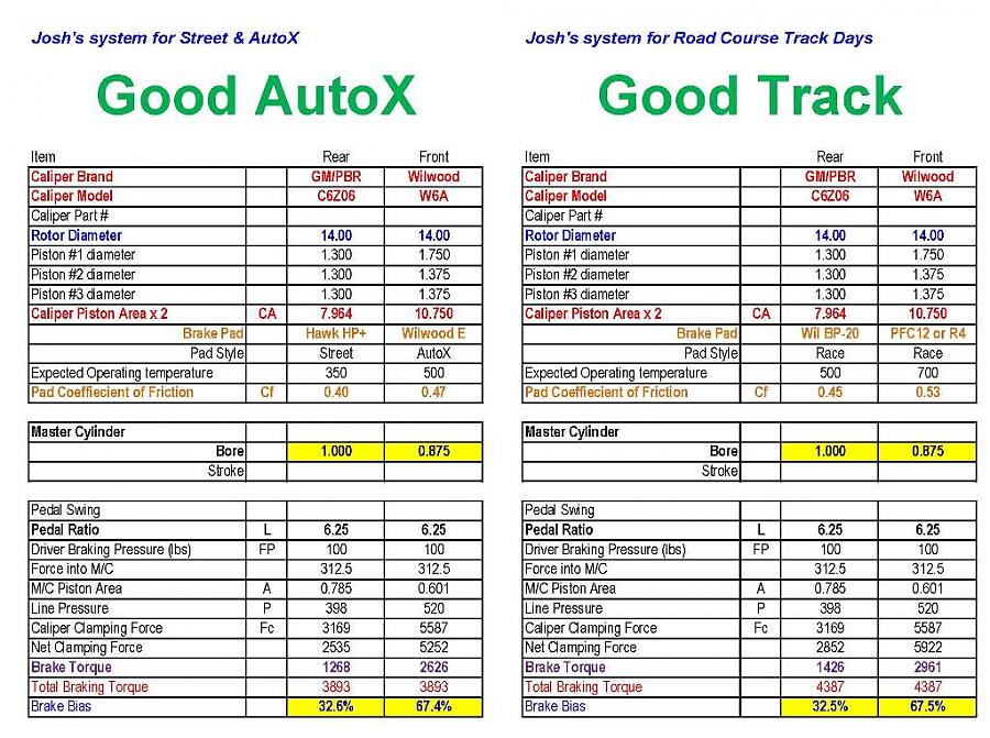

The 2nd chart shows the same street & AutoX set-up ... but shows the Track Day set-up with different brake pads.
4387# is still a lot of braking force. You will need good tires ... like Hoosier R6's or comparable ... or you'll constantly be on the edge of lock up.
This package uses:
Wilwood BP-20's in the rear which are an excellent rear pad with their steep CoF curve. For the front, either PFC's new 12 pad or Porterfields R4 pad. I know the R4 has a nice flat curve from 450 to 900 degrees, which makes for predictable braking.
I "believe" the new PFC 12 has the same CoF & flat torque curve ... and should last longer. It is an endurance pad with medium bite that was on the 2013 Daytona 24 Hour Overall Winner.
Tip:
For road course racing, front brake pads ... with a flat torque curve in the operating range your running ... provides predictable, consistent stopping ... even when you're braking differently ... shorter/longer, softer/harder ... for different speed corners.
For road course racing, rear brake pads ... with a steeper climbing torque curve in the operating range your running ... provides the best overall stopping performance ... because the rear brakes don't bite so hard when you first get on the brakes ... and then brake progressively harder the longer you're on the brakes ... which the car can handle.
