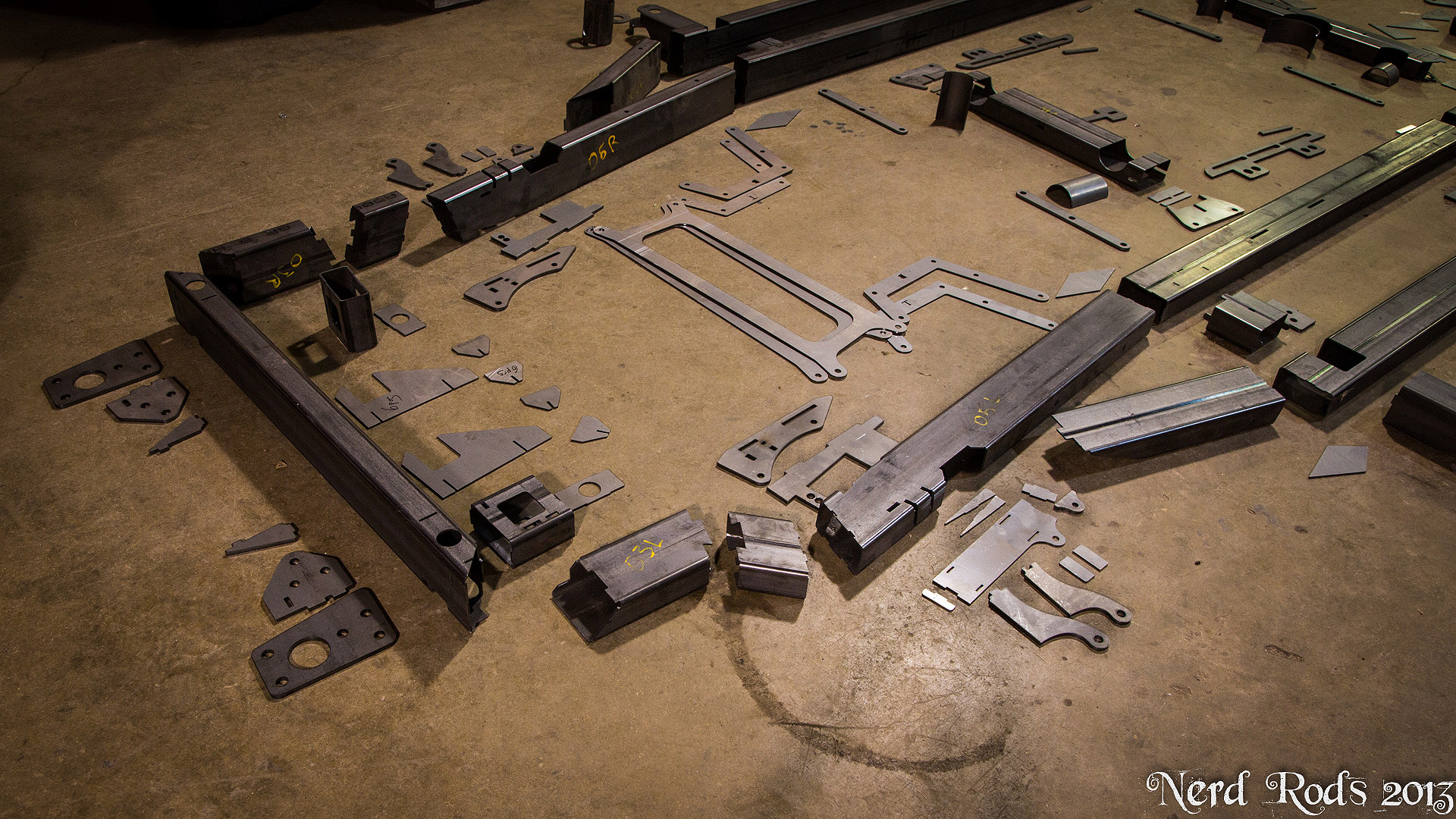

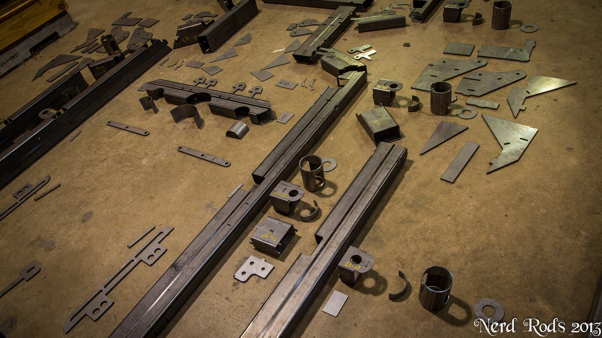

Sorry about the slow response. I got back and life happened. Had a bunch of powder coating work show up to take up space, got sick for a day, had to change out two ballasts in the shop lights, the shop was a mess from a CJ7 5.3L swap and I've got some new part time guys I'm getting trained. Nuts, just nuts.
But without further ado, the new frame!
Man I love going to this place to get parts! They have all the cool tools and it turns out I'm getting better at my CAD package as well. They didn't charge me nearly as much as they did for the initial programing like they did last time for the TriFive car frame.
All packed up and ready to go. Just look at the forklift compared to the rest of the place. They just have all the fun toys!
It took me a few days to get the shop all swept up so I could count parts but here we are, the complete CP5559C4 frame minus just a few parts that are missing but they are finishing parts so no worries there.

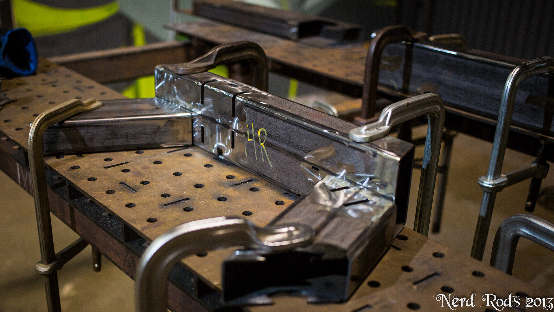

Update 2013.Nov.04
Inner rail is together, Rear upper shock mounts on, Corvette bat wing to frame brackets, Tubing boxing plate and gussets. These parts are much easier to weld on while the frame section is still light enough to flip by yourself.
