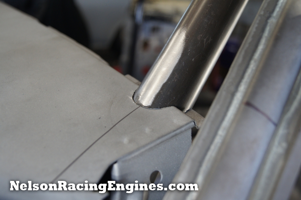

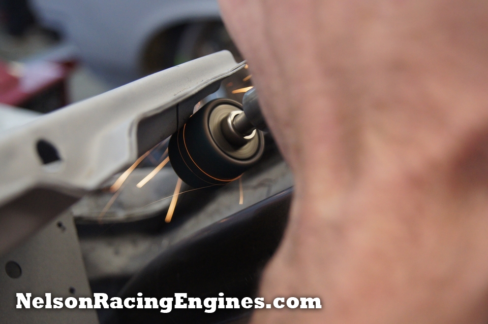

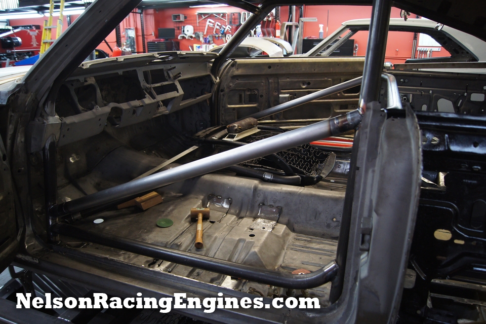

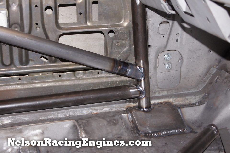

Heres a bunch more to accelerate to the good stuff .Heres us fitting the cage,And getting the body panels landed on.Hey its actually looking like a charger

It looks great. Tom do you tie the roll cage to the A pillars?
I do that a lot but I don't think we are going to on this car we usually will punch die a piece and weld the pillar and cage together but its a bit to hard core looking for the theme were going for on the inside
