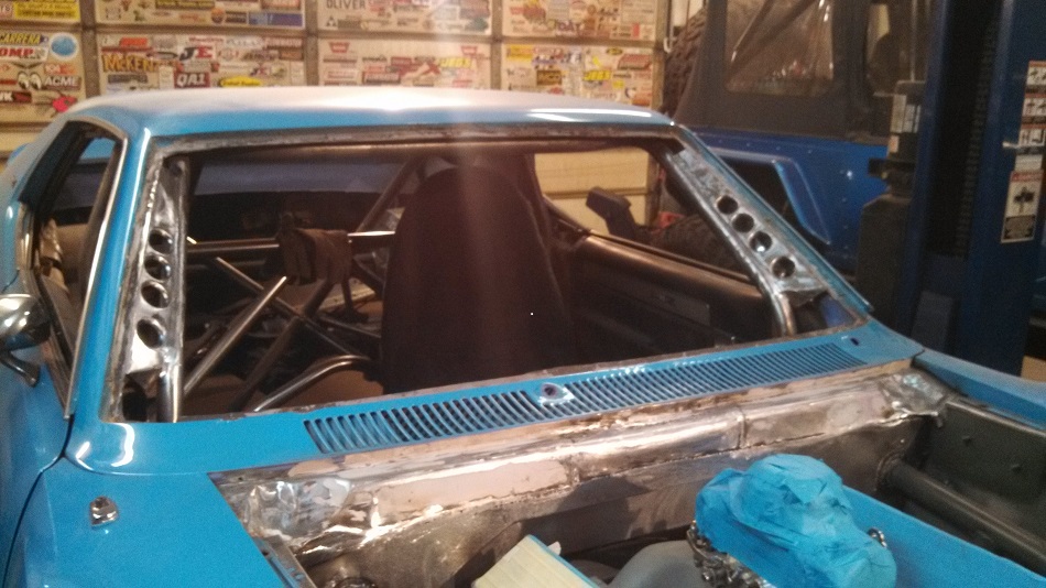

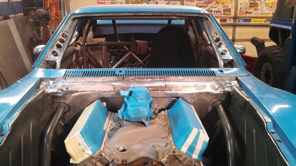

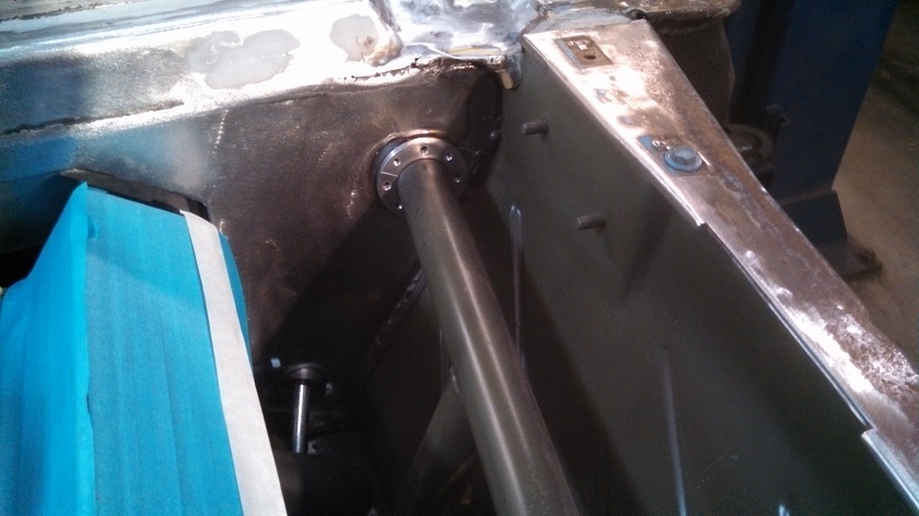

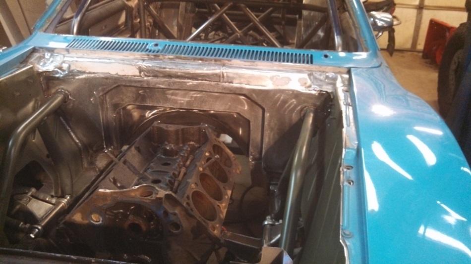

It's been a couple weeks since I updated this. Haven't had much time to get out in the shop. Not a ton to show, but I did get the firewall roughed in, motor mounts built and A-Pillar/Roll cage supports built and installed. [ATTACH][ATTACH]Name:  IMG_20140223_135708_891.jpg
Size:  189.8 KB[/ATTACH][/ATTACH]
A buddy of mine runs Hell Yeah Hotrods. He is milling a set of decorative rings that will cover the bay bar/firewall.
The engine is still at the builder. Hopefully we will be able to make a decision on the final displacement so I can order engine parts.
Next up is to install my Wilwood pedals and steering column. Then I am going to build the exhaust system before I build the floor. I have done WAAYY to many street rods over the years that the exhaust is an after thought. I promised myself that the exhaust would NOT be a compromise and I would build additional clearance before I build the floor.

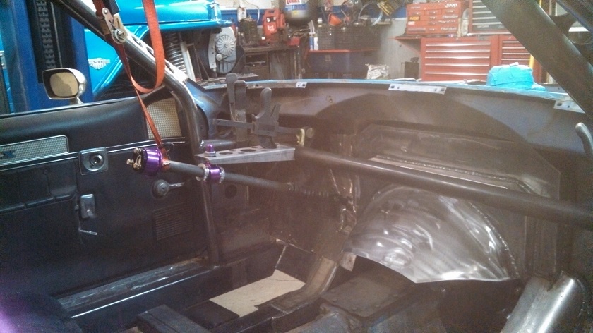

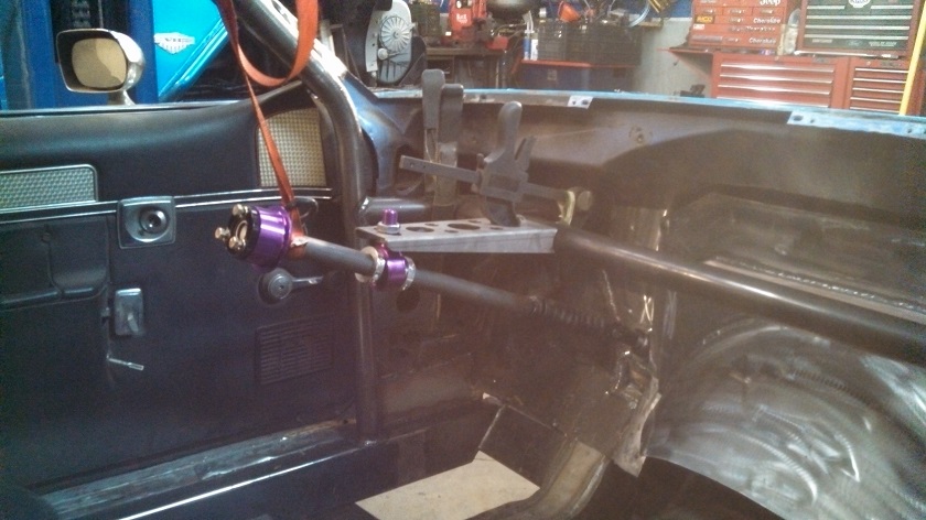

[ATTACH][ATTACH][ATTACH]Name:  IMG_20140317_192834_324.jpg
Size:  113.5 KB[/ATTACH][/ATTACH][/ATTACH]
Dash bar and steering column roughed in. Steering wheel should be here tomorrow so I can get a better feel of final position. I had a buddy cut up some trim rings for the bay bars. Had to make them out of two pieces but he installed .125" pins to keep them from deforming.
I am struggling with my Wilwood pedals. I am having a hard time finding any documents that will give me some direction on appropriate pedal height and positioning from the firewall. It's times like this where I wish I was building a Camaro so I could just copy someone else's good ideas!!

As far as pedal height, I like to get the gas pedal in first then see where you heal goes. Don't forget to take into account possible floor material, dyna mat or blast plate. Then set the rest of the pedals based on that.
Sometimes with the wilwood set up you have to put them where the masters will fit. Engine and header location can change that.
