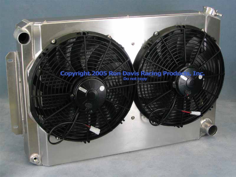

I went with a Ron Davis radiator and fan setup and it should be here in a couple weeks.
