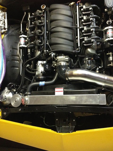

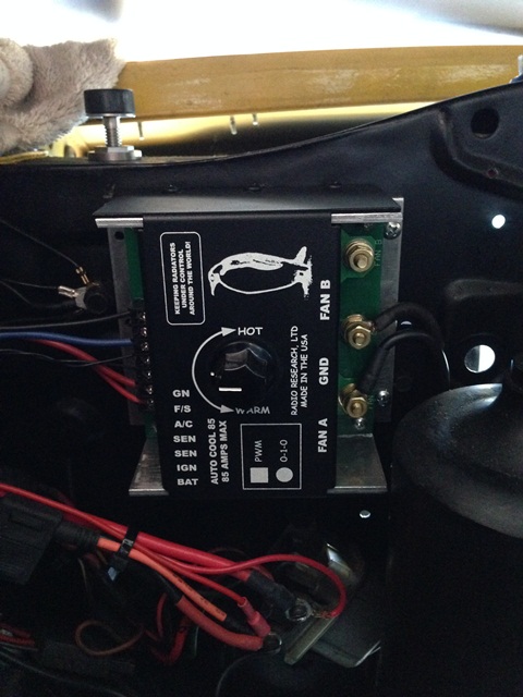

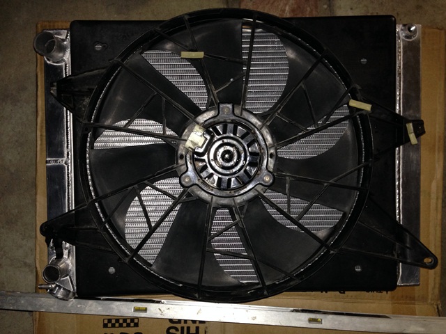

With the tubs done and the rear in I went back and worked on more of the engine stuff along with electrical I decided to get the Griffin radiator and Mk8 fan together. I really wanted DC Controls but I could never get a hold of him so I used this controller from a guy who doesn’t live far from me. I went to his house with the MK8 fan and he gave me a demo of how his stuff worked so I gave it a shot.
The MK8 fan fit the Griffin LS radiator really well. I trimmed the fan housing a littled, fabbed up some brakets and in it went.

Looks great Efrain
What's that hardline running from the passenger firewall forward, AC?

Originally Posted by Ron in SoCal View Post
Looks great Efrain
Ron,
That is an AC line. I think I have the oldest version of Vintage Air in my car. It was one of the first mods I made on the car years ago.

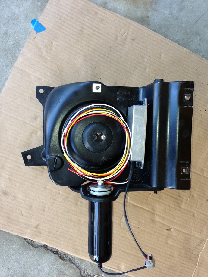

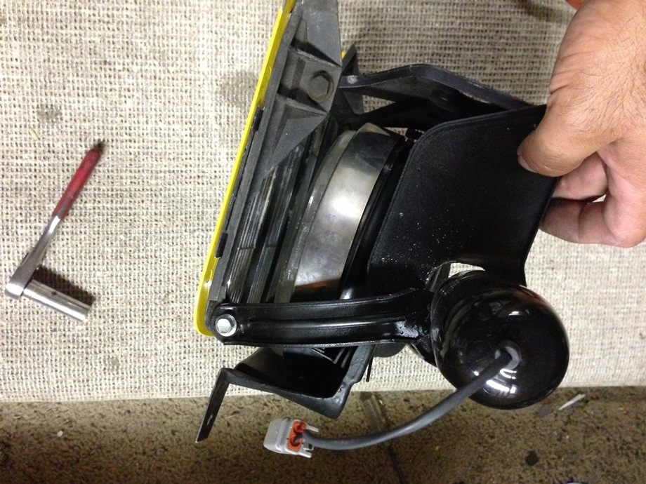

Well I got through most of the electrical using some of MAD electronics stuff and making new sections where needed to get the LS going. I also had to convert my headlights from vacuum to electric since the dry sump tank takes all of the room where the original parts were. The DSE kit would not work so i used the Retro Electro kit which makes the motors run similar to the 67-68 Camaros. It was expensive but it works well and was the only soloution for me other than converting to a non RS grill and lights.

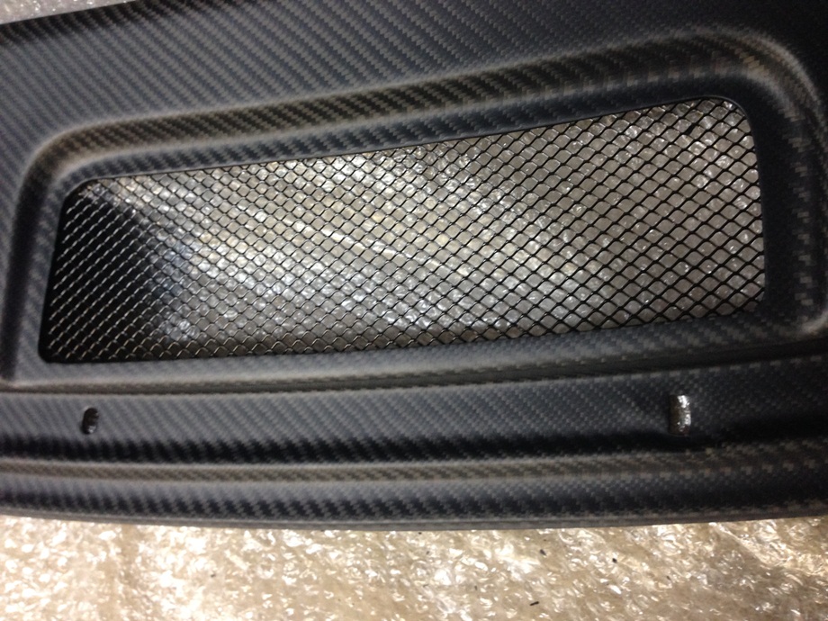

I didn't like the original mesh on the cowl so I found something more to my liking from Lowes. Here is the before and the after.
