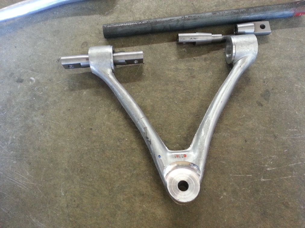

Question, where did you get the shims/ spacers for the upper control arms? Different widths?

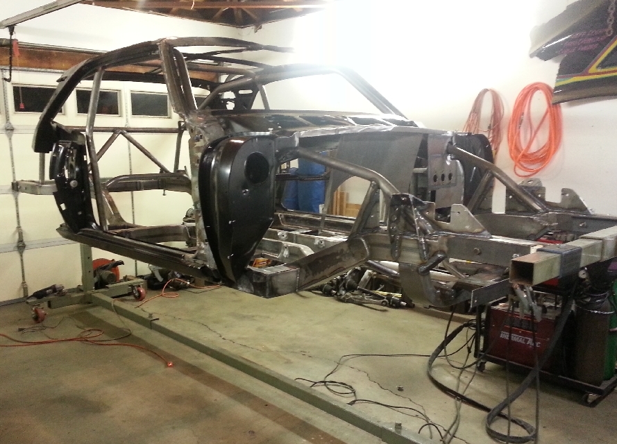

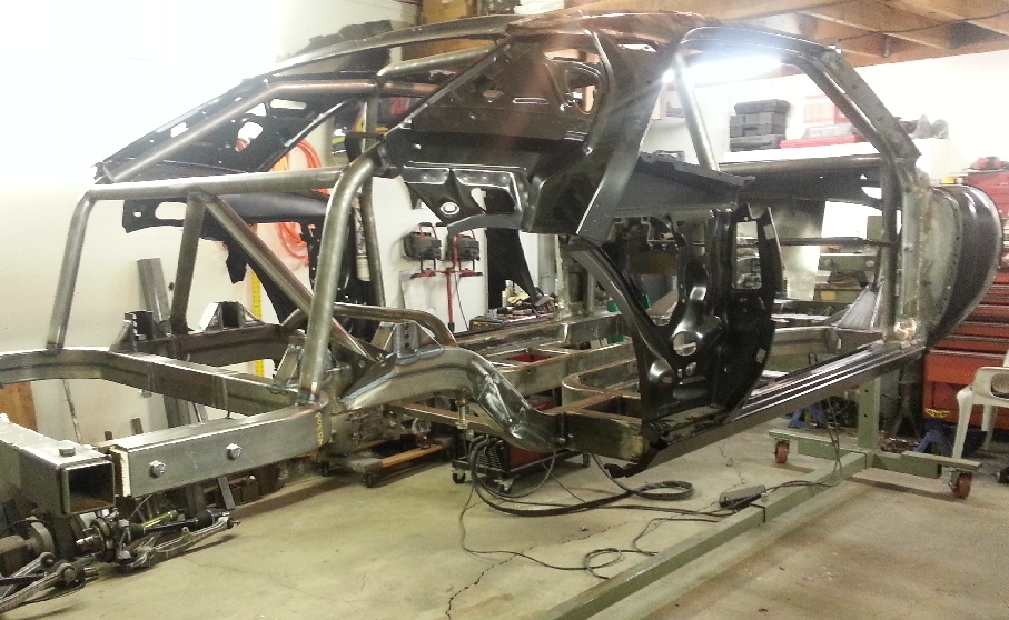

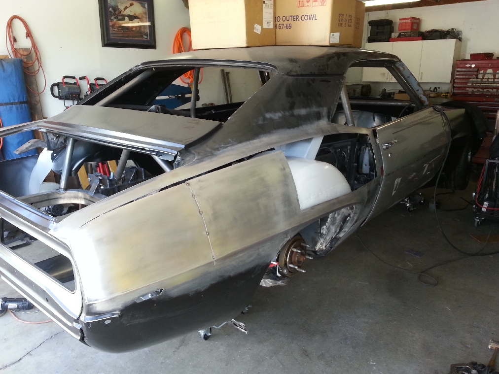

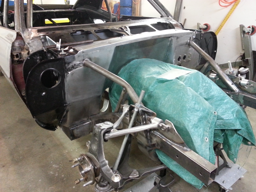

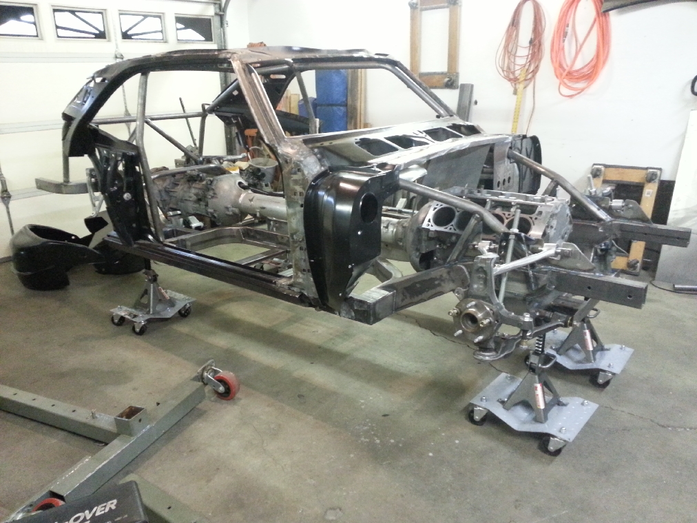

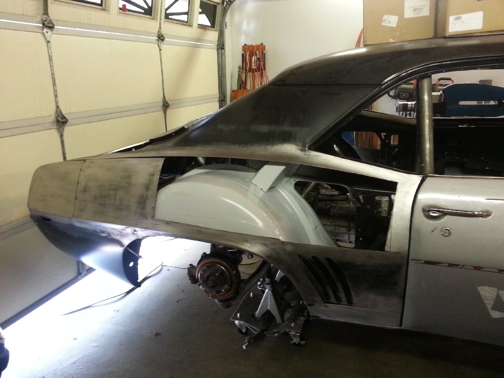

On the rotisserie to finish up some welding. Then Harbor Freight dollies and stands to keep it mobile. Started hanging body panels. The inner fender wells have to be raised 2.5" for ride height and widened 3" each side for track. Plan is to run it full width. I did end up re-drilling and narrowing the track width by 3/4" in the back. Car will be widened 6" in back and 5.5" up front. Every time I thought I had an idea how to make that work I would hang the body panels and not like the results. So I would move on to something else till I could come up with another idea. Eventually I decided to widened the tail panel 2", that really helped the rear of the car.
Starting to look like a Camaro again.

I made the aluminum bushings for spherical bearings to replace the rubber. I looked all over for cross ties to go through the bearing but it seems nobody sells them. Can't remember (either Chassis Works, Roadster Shop or Art Morrison) posted how they make them so I gave it a try. I'm not sure if that will be what I end up using. I drilled everything stock C6 spacing so I can always go back to stock if wanted.
I hope that is what your asking.

Jeff .... I was wondering about the shims between the mounting bolts and the plates for the upper control arms, looks like about 1/2 inch?

Those are just some aluminum spacers I cut to get the alignment close. Nothing final on that yet and I might change the way the control arm mounts to the frame anyway. I spent a whole day making a mounting system for the control arms then decided I didn't like it. Ended up making these and might end up using the original idea after all. LOL
