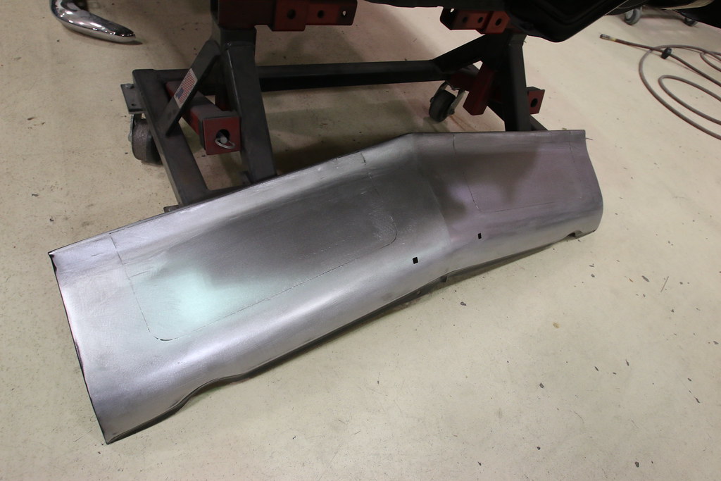

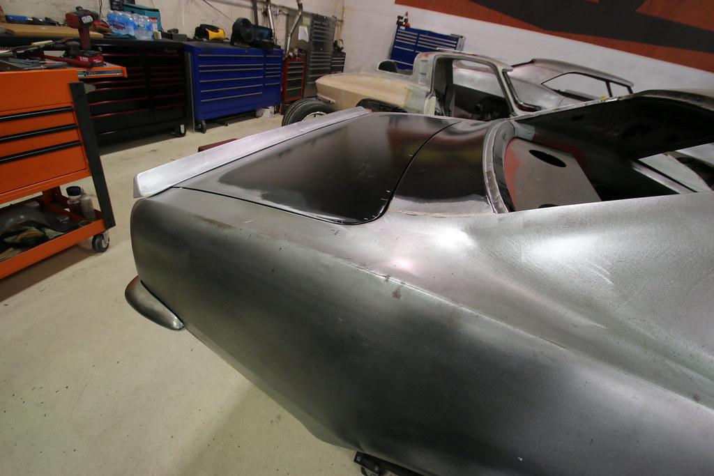

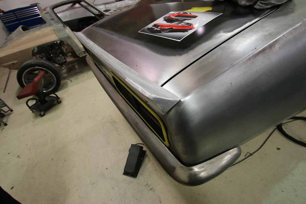

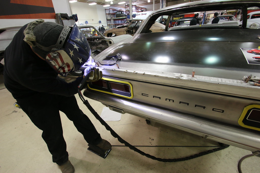

A few more pics for today, kicking off with the rear spoiler. We wanted a lower, less dominant spoiler than factory due to the details we have added on the tailpanel and lower valance. The 'shorty' would give a better visual balance.
[/url]
[/url]

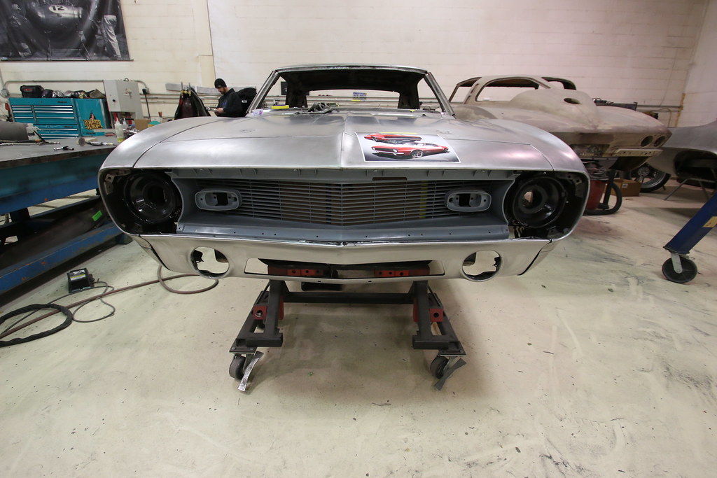

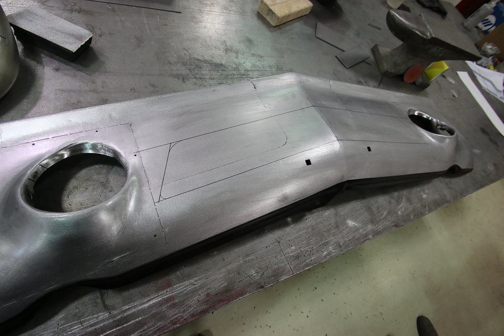

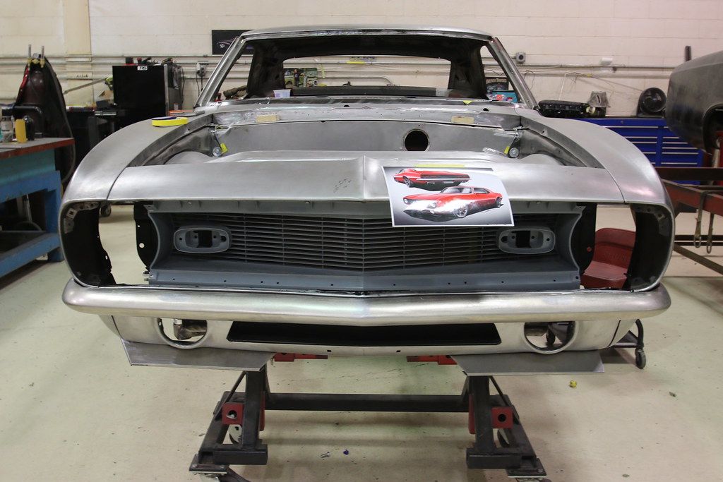

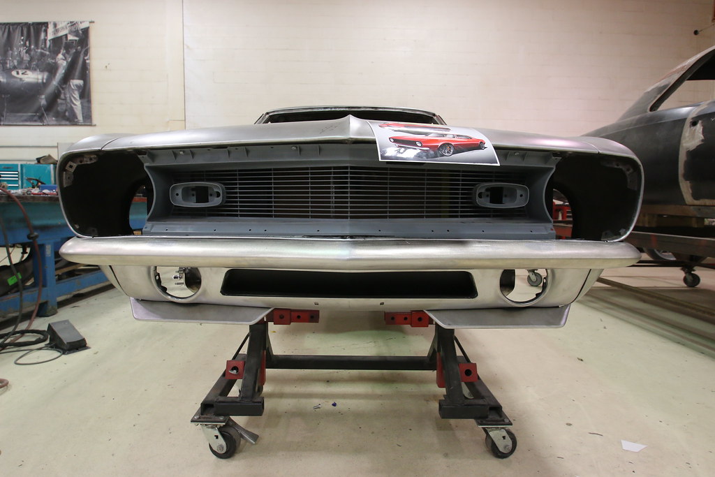

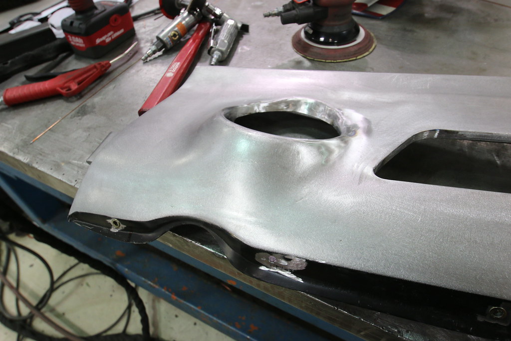

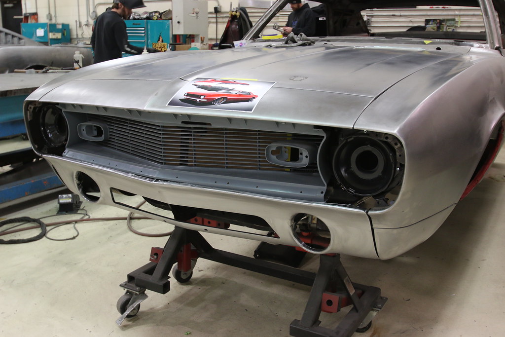

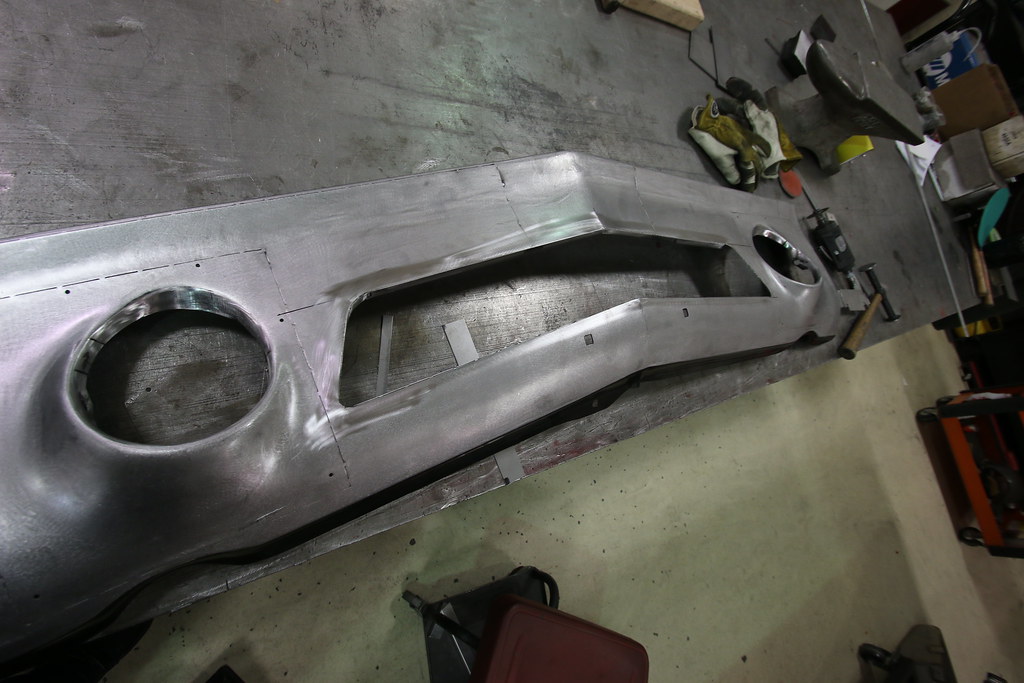

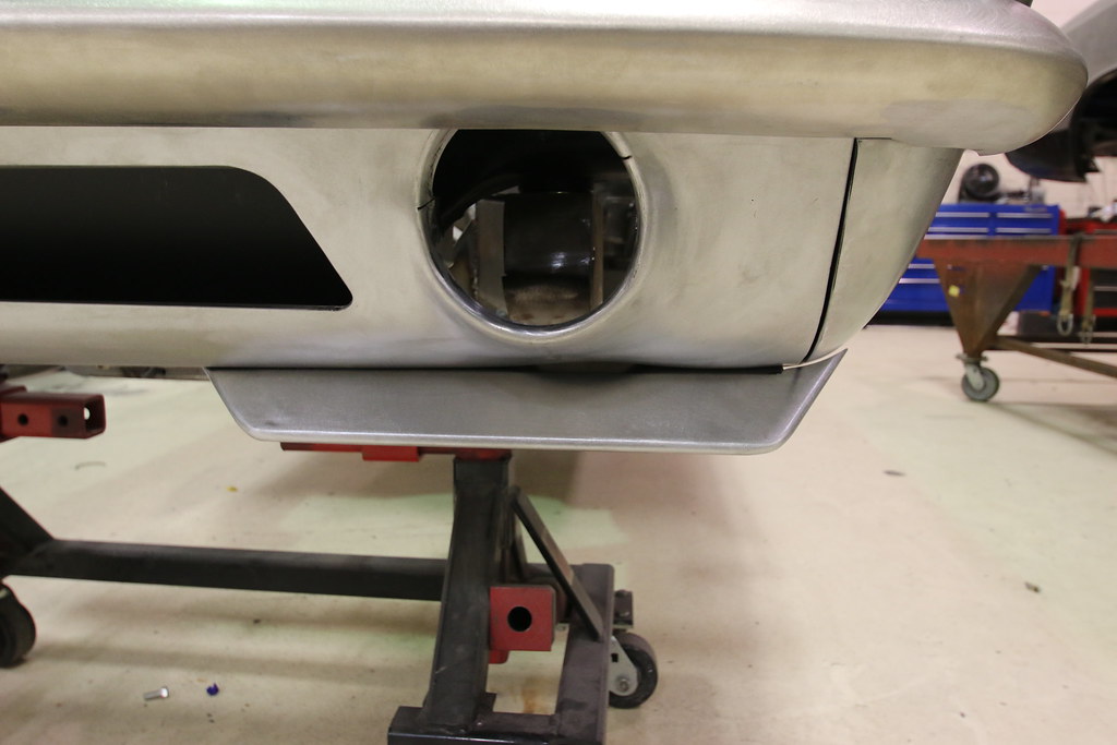

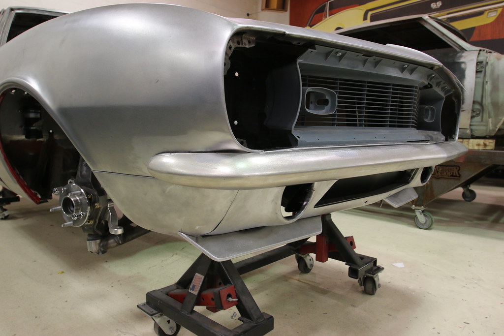

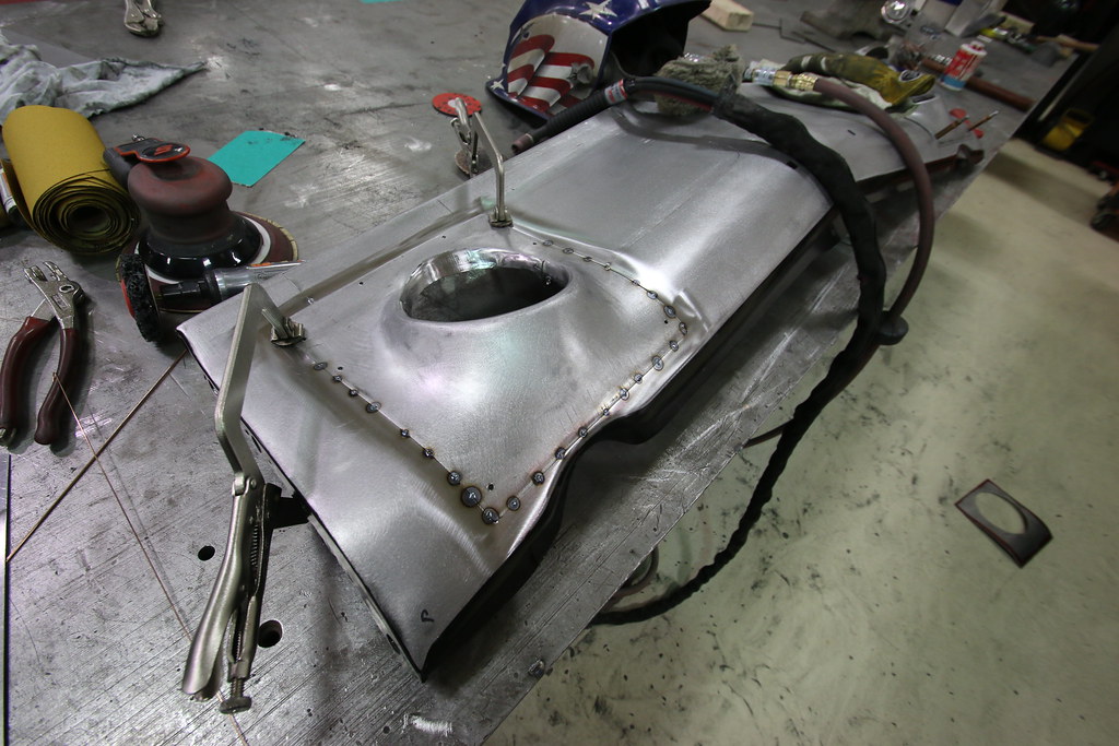

Next we turned our attention to the lower valance area. The plan was an integration of the '69 style turn signals with a center opening and insert.
First we filled the 67/8 valance:

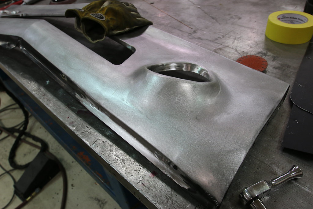

69 turn signal openings:

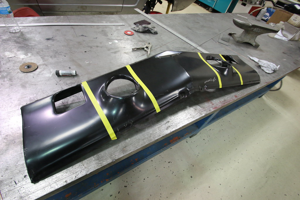

Next, the split chin spoilers:

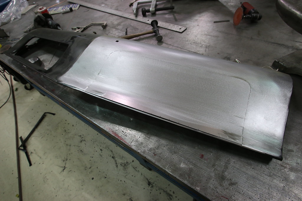

Filling the 'dimples' under the lower edge for a smooth edge to the new spoiler:
[B][FONT="Arial"]WWW.ROADSTERSHOP.COM
