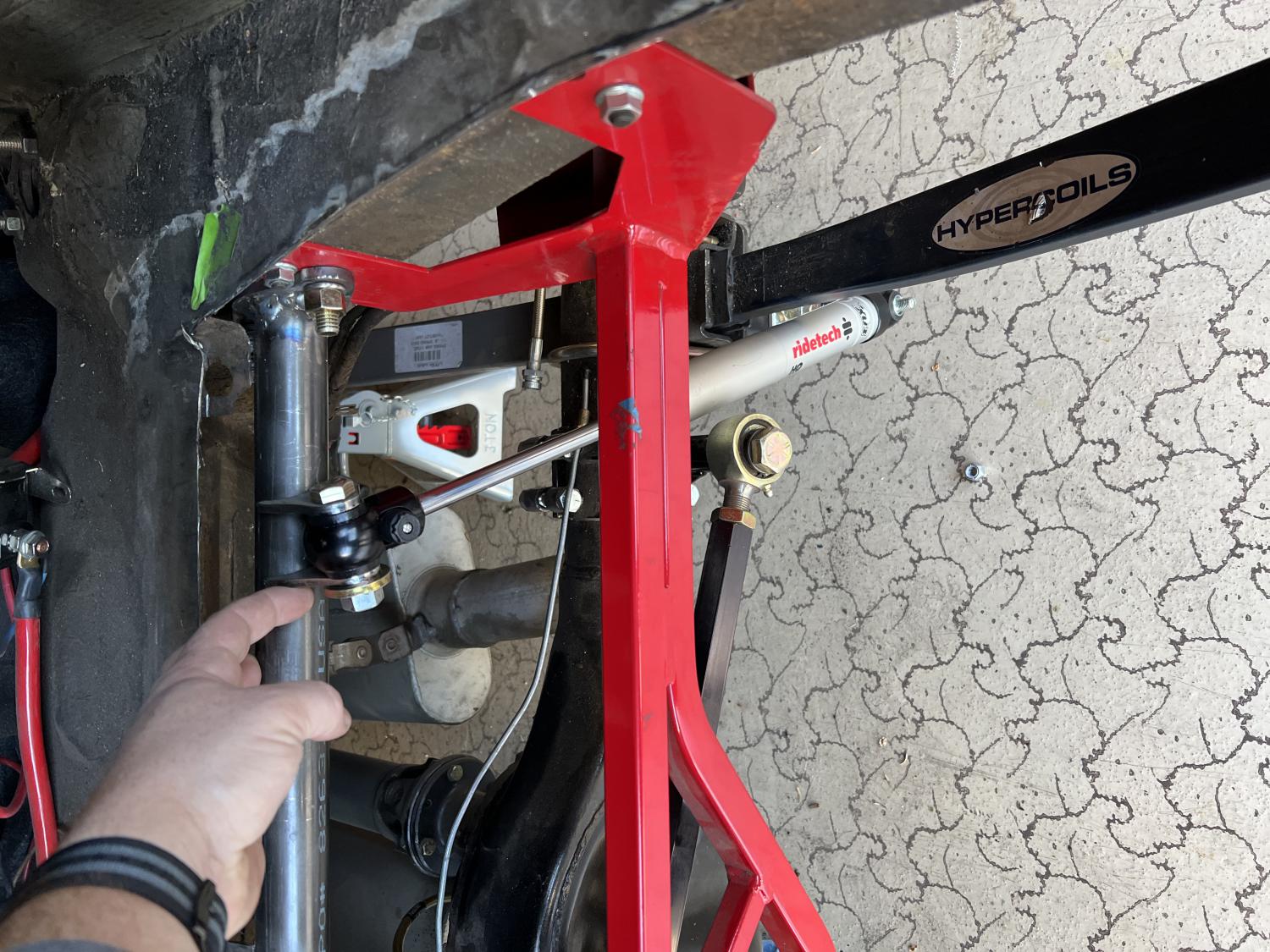

Gents, hoping for some help thinking through a rear suspension packaging issue. The passenger side watts link mount is leaving very little room for the shock on that side. Attaching pictures below for reference.
The upper shock mount has not been built, so I have some flexibility there. Watts link pars are equal length and offsetting 10 degree angle. Shock is at 20 degree angle.
Hoping to keep the watts link, but I’m struggling here…

Staggered shocks an option? Move one side in front of the axle

Potentially…might make the upper mount situation tricky.
Staring at the picture more, I could drop the watts cradle a bit, maybe an inch before it’s not grabbing enough of the frame rails…

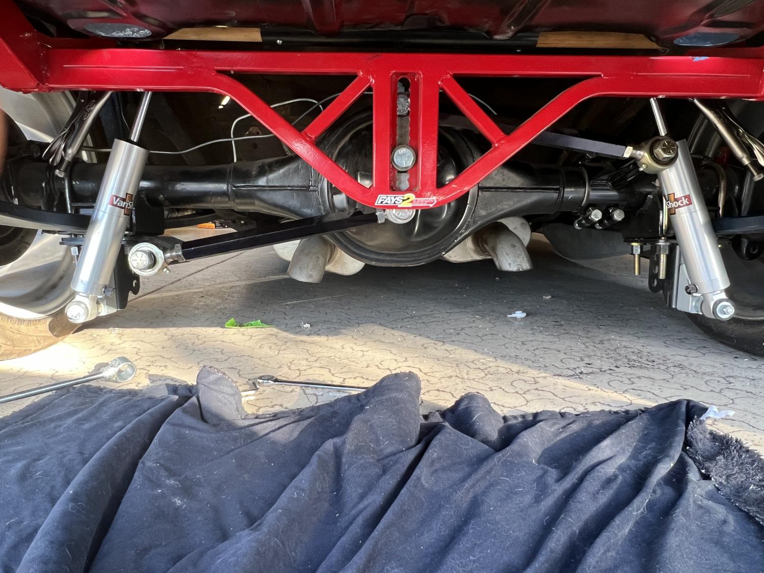

Rear Suspension – The solution for the shock/watts bars packaging issue was actually relatively simple. Fays2 is now shipping their kits for 1st gen Camaros with 2 of the axle tube clamp-style mounts for the watt’s bars. Alternatively, if you already have an old kit like I do, they will also sell you an additional mount to replace your existing leaf pad mount. Being able to bring the driver’s side mount even an inch towards the center will allow me to move the pass side clamp the same amount and free up more space for the pass side shock. Switching to Ridetech shocks (to match the front) with a smaller diameter shock body helped out with clearance as well.

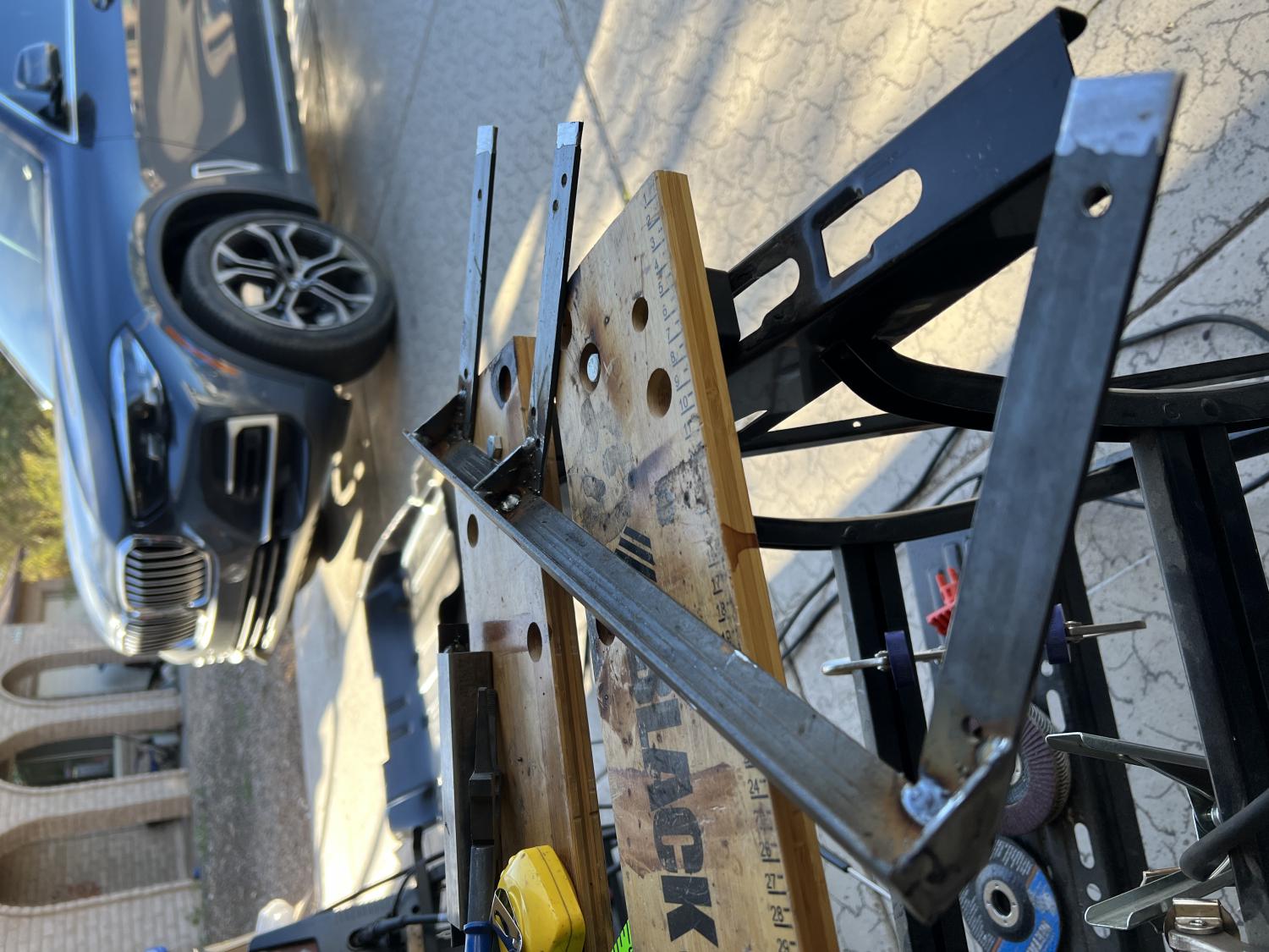

The upper shock mount fabrication is done. I’m new to welding, as you’ll no doubt be able to tell, but I think it will be strong enough for a non-coilover application

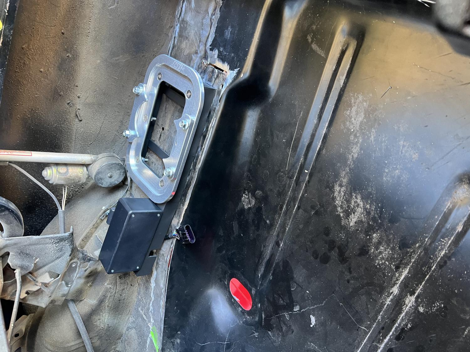

Holley Terminator X Max Stealth – ECU location is planned and mount is fabricated. Since this car will likely remain A/C-less (on account of not having wheel wells upon which to rest the A/C lines), I can utilize some of the space that others normally could not. This quick bracket topped with some PVC hobby board will provide a nice flat surface for the ECU and Holley BIM module for the HDX gauges.
