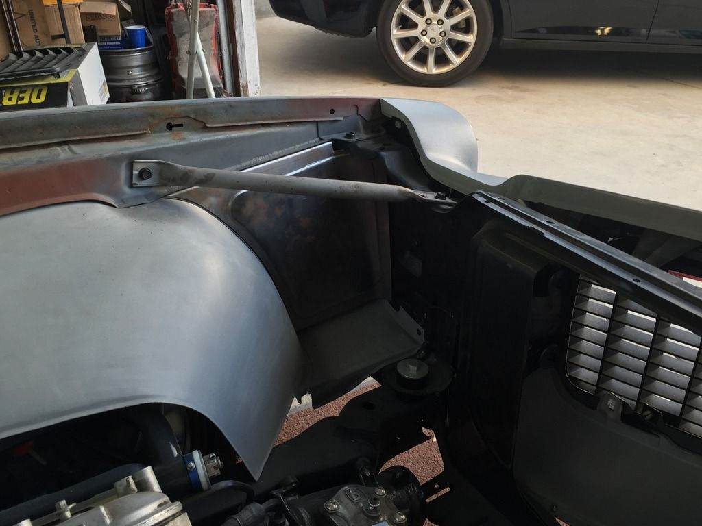

Here it is on its way to the body shop the whole back end is getting cut off and new nos gm sheet metal is going on

Here are some pictures of it bare and with sheet metal going back on I already had cut for the mini tubs at this point once it got home I finished them up and its time for the Quadralink and mocking up the front suspension and motor and transmission.
