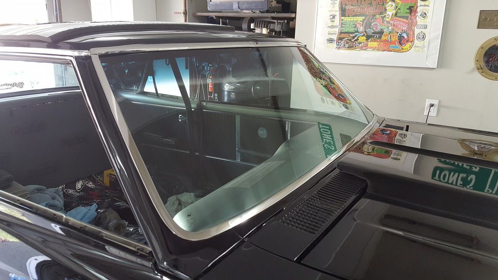

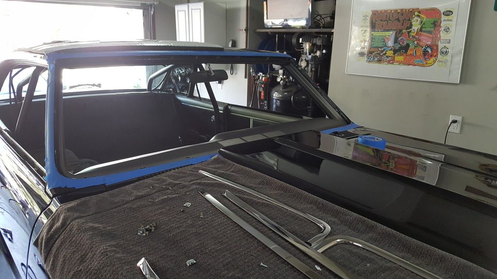

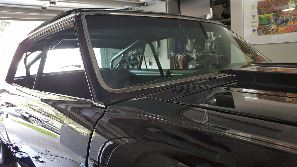

So unfortunately life's curb balls have been hitting me from all angles. The car was obviously side lined but I have decided to keep going on things that don't really cost money at the moment. I don't really have anything too exciting going on but I got my windshield installed today. I got new glass and had my chrome polished. Shout out to Smiley in San Francisco for his polishing skills. He did a great job! If anyone is in the bay area and looking for a guy pm me and I'll give you his number. There's not too many guys doing it around here anymore.

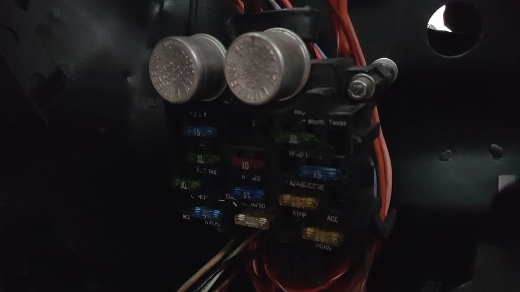

Thanks for the Ridetech feedback. I am eagerly awaiting my new kit for the rear so I started back on the wiring. I got the fuse block mounted
