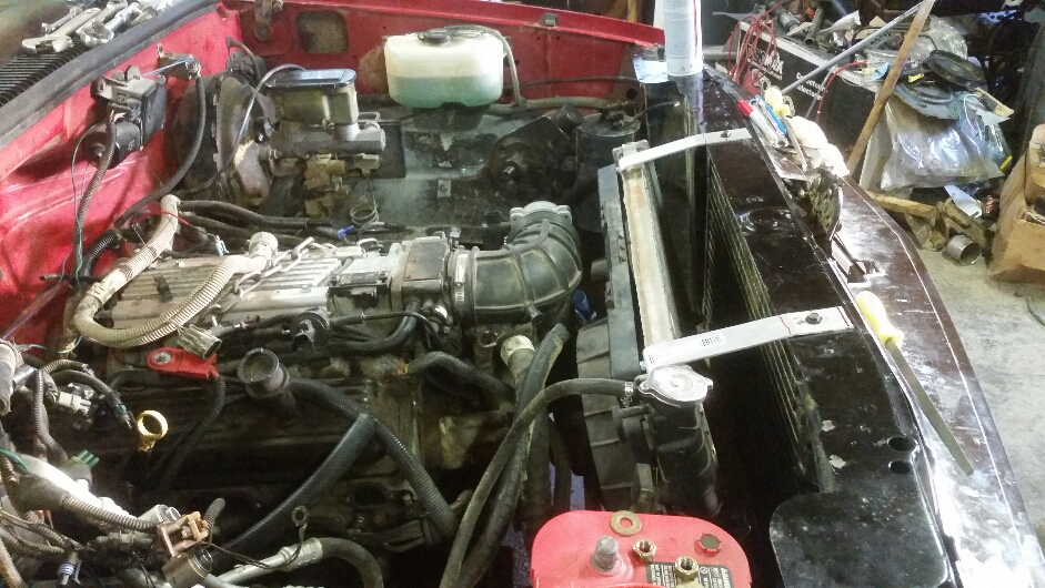

Made some radiator support brackets and checking to see how to run the intake tubing.

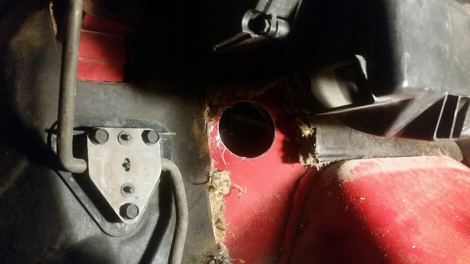

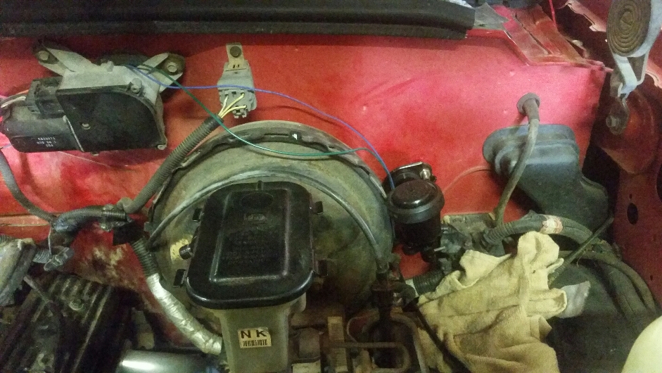

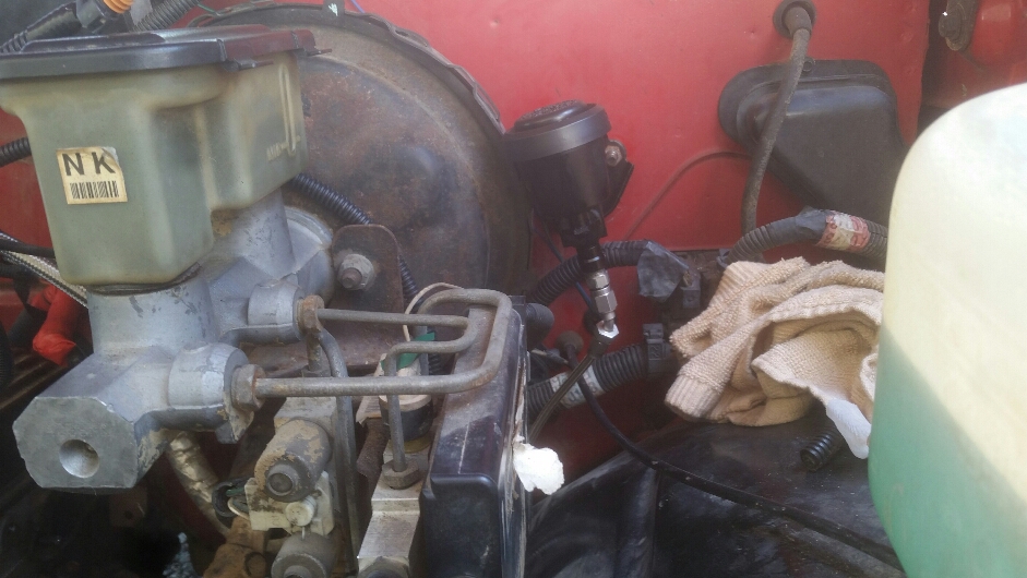

Made a support bracket for the clutch pedal bracket that I made out of part store flat stock and bent it to z shape and drilled some holes to mount the clutch bracket to the dash frame(not pictured yet) and mounted the clutch master cylinder so I can start on making the custom clutch line to mount to the Camaro slave cylinder.

Then went ahead a drilled the 2" hole for the wiring harness in the only place I could find with a flat surface and not covered by the heater box that is about 4 to 6 inches from the gas pedal.

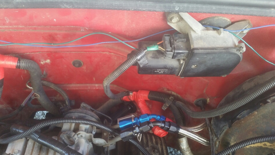

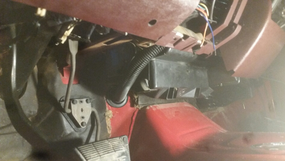

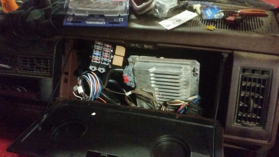

I test fitted the harness but had to pull it back to run the harness through the dash for a cleaner look.Name:  2016-07-19 17.59.41.jpg
But didn't have enough wire to run the ecm to the stock spot and so I lost my space for the glovebox.Name:  2016-07-19 17.59.10.jpg

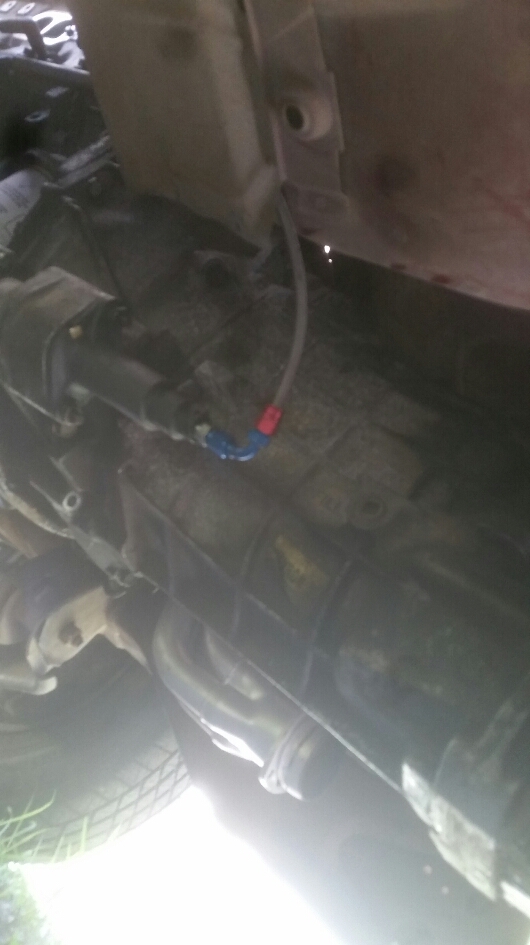

Got the trucks master cylinder attached to the Camaro Z28 slave cylinder with -3AN line and fittings.Name:  2016-08-10 01.48.24.jpg
Size:  353.1 KBName:  2016-08-10 01.49.03.jpg

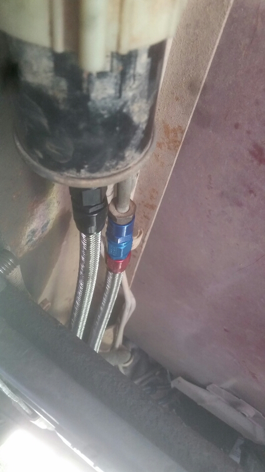

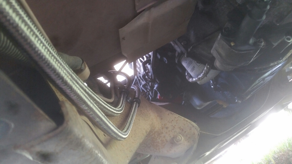

And got the fuel lines also done going from the truck's metric threads to the LT1 push lock fuel lines.

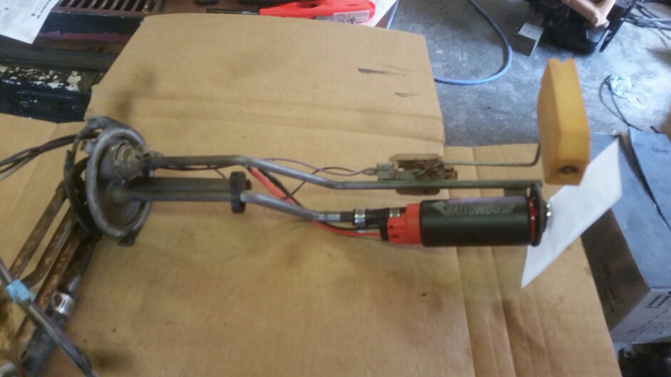

I have replaced the lazy stock pump with a Aeromotive 340 pump to keep up with the higher fuel pressure the LT1 requires.

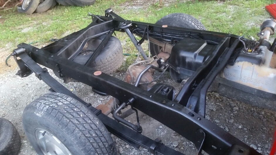

Painted the frame after taking the bed off to replace the fuel pump.

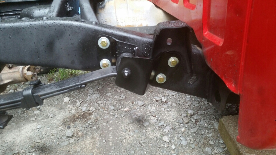

And also got the McGarghy's 2in drop spring hangers.
