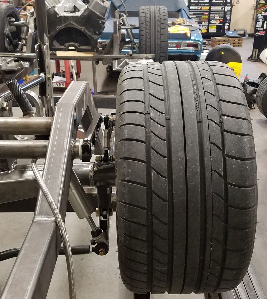

Looking at your pic with the Z06 wheels on the rear, it looks like your coilovers would be kinda close if you used that backspacing. How wide were you able to put the lower link mounts? thx!

Looking at you pic with the Z06 wheels on the rear, it looks like your coilovers would be kinda close if you used that backspacing. How wide were you able to put the lower link mounts? thx!
Maybe this picture shows the space better...
10096 by Yelcamino, on Flickr
I could run this exact wheel/tire size/backspace with plenty of room. The lower mounts are 38" apart, and if I remember correctly, with the Z06 wheels there's 7" between the inside tire sidewall and the frame rail.
