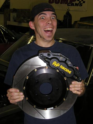

Curious of any brake issues anyone has hauling there heavy cars down from 100-150 mph time and time again on the road course. Any recomendations on rotors, pads, or calipers?
Sure.
